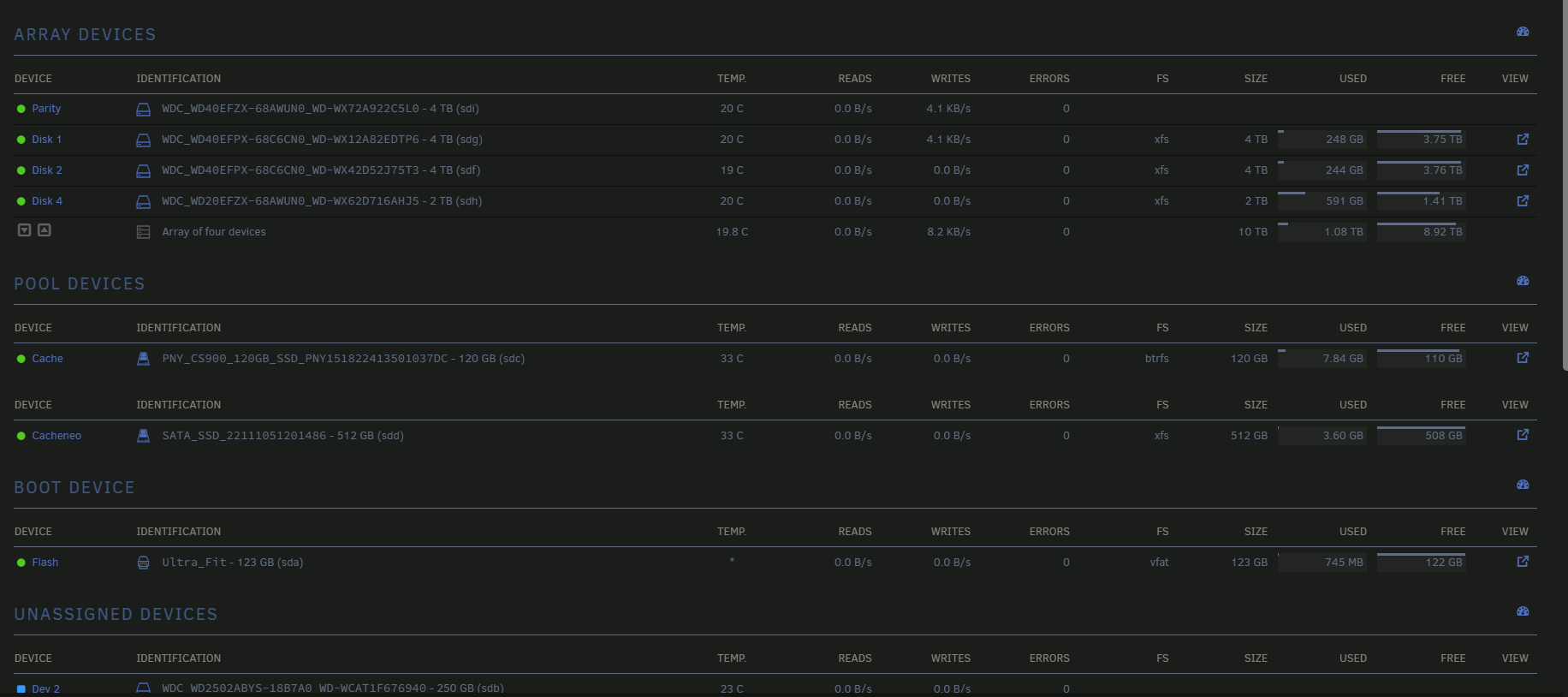

However, my parity drive is still up and running:

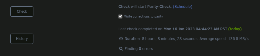

And I ran a successful parity check with 0 errors:
