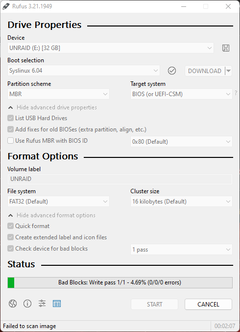

One thing it might be worth trying if you have access (even temporarily) to a Windows machine is to format the flash drive using Rufus.
I guess format it with syslinux, copy over the flash drive backup and cross my fingers? I'll give it a go.
Also, this is a 32GB Sandisk Cruzer, so like the top recommended USB drive for this type of stuff unless there is a new recommendation.

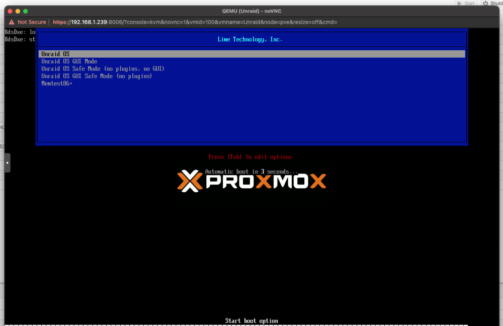

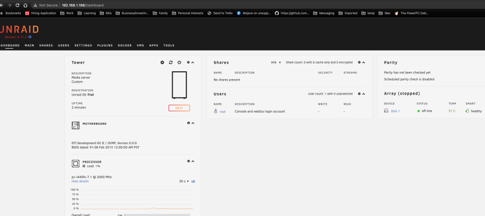

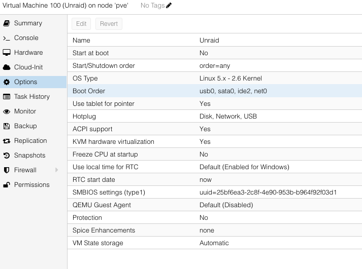

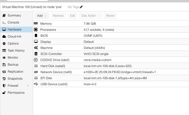

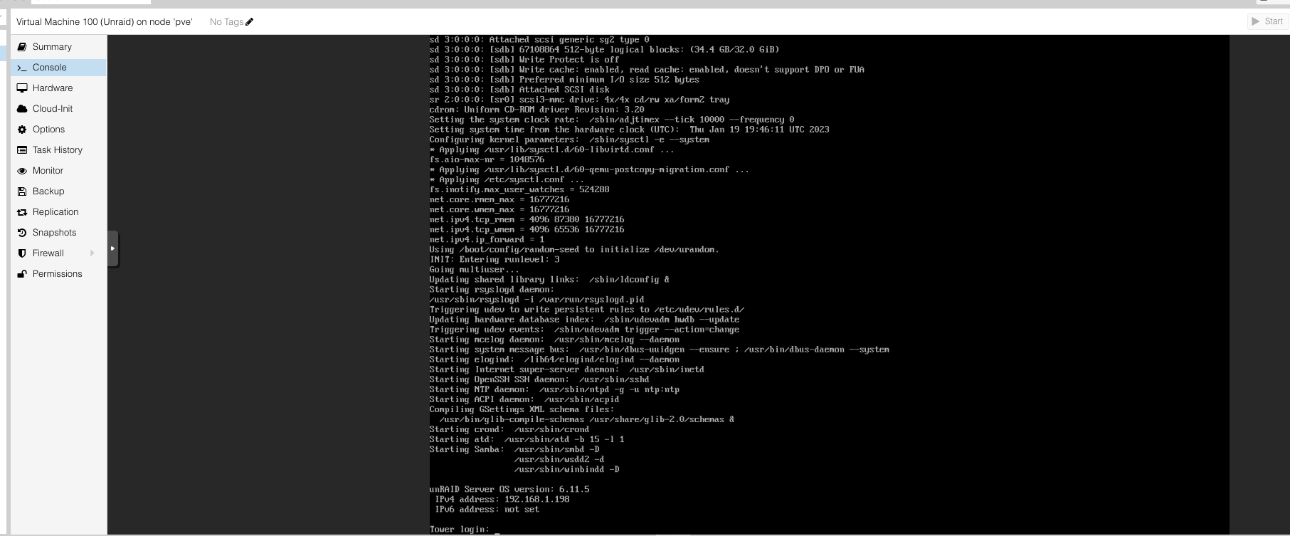

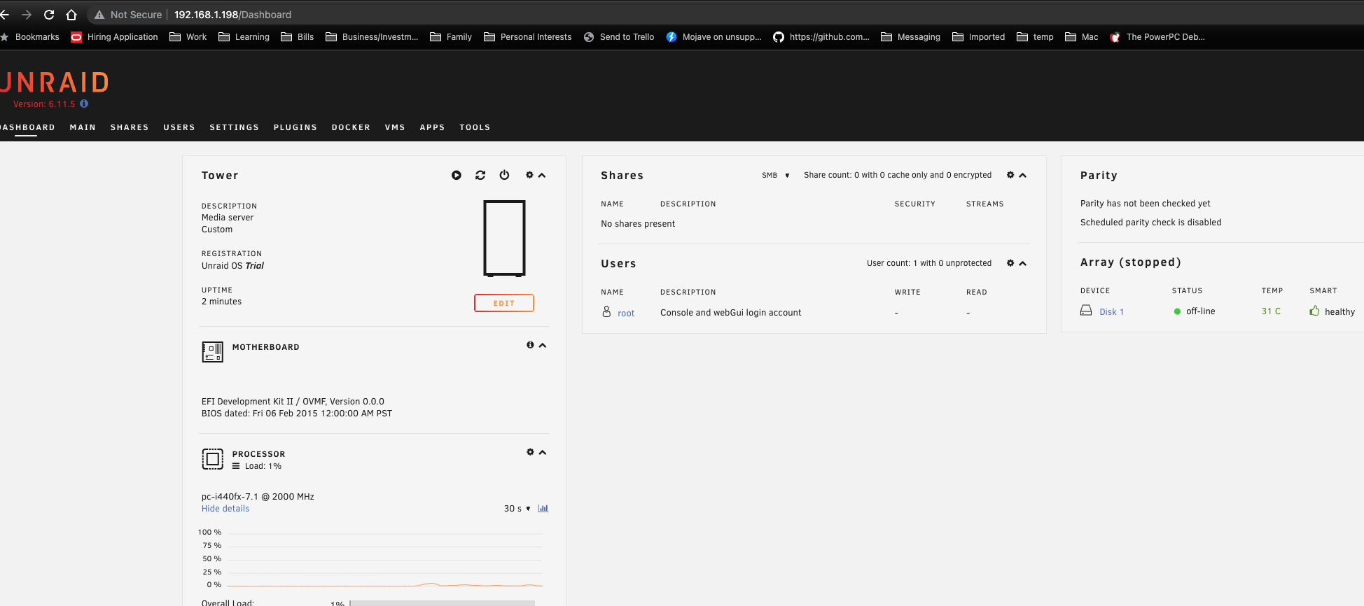

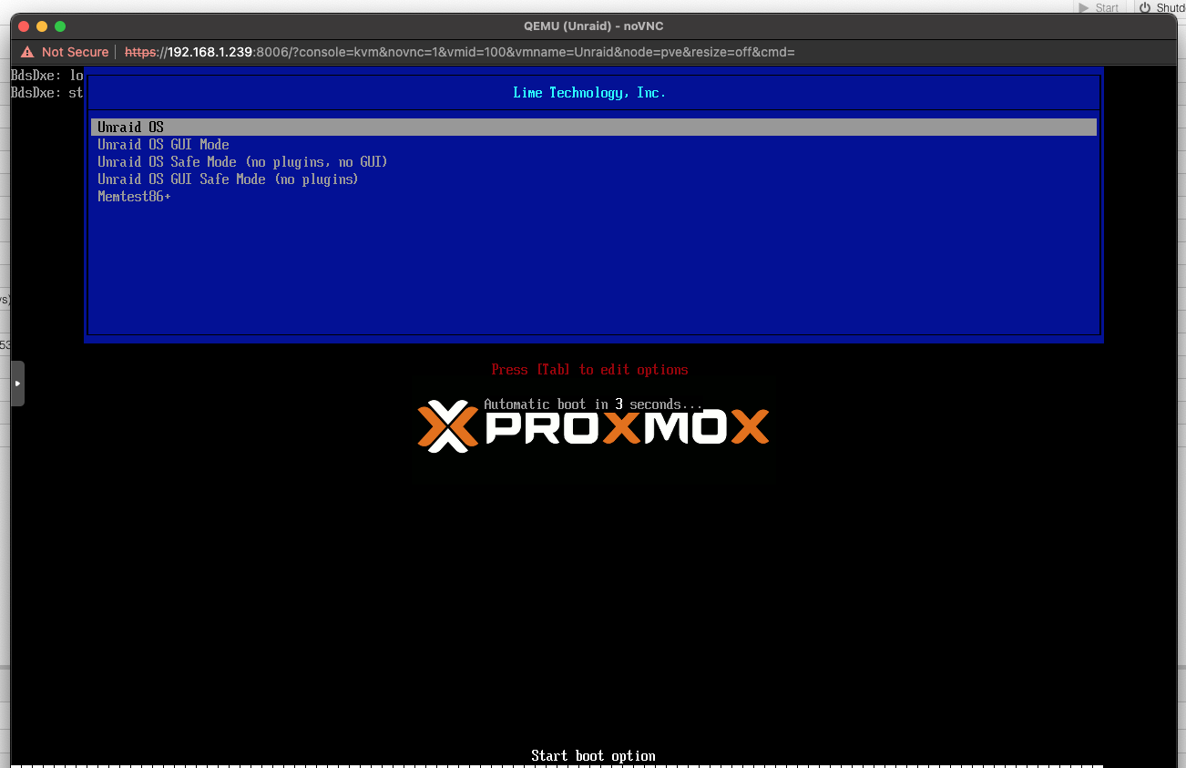

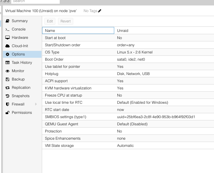

I don't know if this is of interest to you, but yesterday I tried and got the same issue on my 5,1. I installed proxmox and virtualized Unraid and I was able to get it to boot. I am waiting for some hard drives to come and I need to test passthrough of host processor and other things - with hope I don't get the kernel panic.

I may have to try out Proxmox, I'm just worried about all the data on my array. Appreciate the heads up, let me know how things go!

Pass through. I would suspect, since unraid’s MO is to be able to move your usb and drives to new computers without loss, then you could move everything over to the unraid VM in proxmox. You would need to install proxmox on a unused drive or partition, spin up an unraid vm with usb and pci controller for the hard drives as passthrough. However, this is my first time using unraid so heed and precautions needed.
