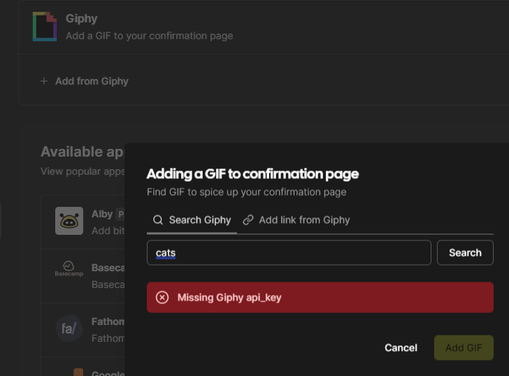

Okay, I'll put some more APIs, but I tried to put the Ghipy and it didn't work well, I said I couldn't find it and that's why I thought it was only for paid cal.com licenses (the api was put inside the cal.com web console, not in docker variables, and that's what I did also with Google's,  many of them can be entered into the web console itself).
I have the reverse proxy with NPM (Nginx proxy manager) and it works well in bridge mode with many more dockers that I have running (freescout, pingvin-share, projectsend, s-pdf,etc.) but I didn't know what was better to cal.com a custom dedicated network (local network ip range). And I've tried setting up cal.com with custom networking, but the login error still continues.
Thanks again.

Thanks, yes, the case is that the IDS, the Google API Keys if they work and I can connect Google calendars. But the Giphy API does not work, I thought it was precisely the docker in v3.7.11 and that with the new tag would be resolved. The Giphy API is in normal mode, not in production mode because I understand that it is not necessary, besides complicated to send the requirements that they ask. On the other hand, I still have some notices of NextJS, I hit you, you have any similar?

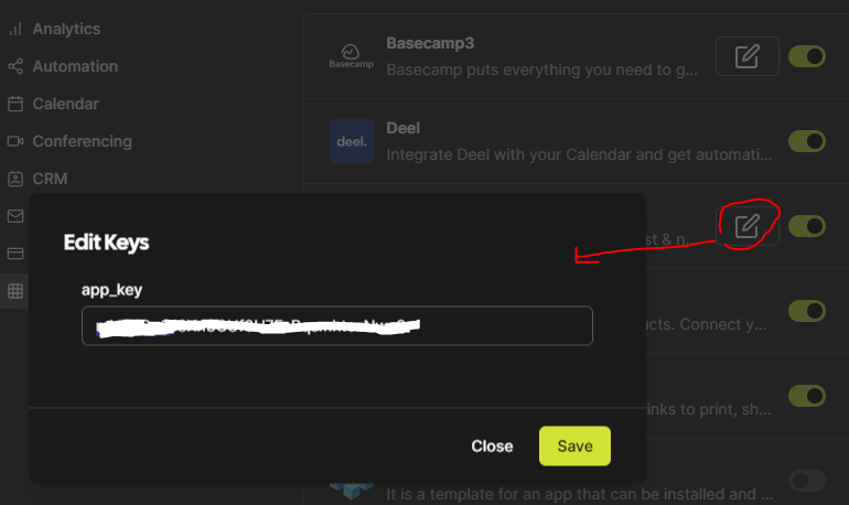

Did you upgrade the giphy api to production?  See instructions here: https://developers.giphy.com/docs/api
If you generated the secret keys for CALENDSO_ENCRYPTION_KEY and NEXTAUTH_SECRET correctly, maybe try this section I saw in the sample template here:

1 hour ago, avinyc said:
¿Actualizaste la API de giphy a producción? Vea las instrucciones aquí:  https://developers.giphy.com/docs/api
Si generó las claves secretas para CALENDSO_ENCRYPTION_KEY y NEXTAUTH_SECRET correctamente, tal vez pruebe esta sección que vi en la plantilla de muestra aquí :
The problem of putting in production the api of giphy is that they ask for a video where the environment is shown in production where it is displayed by sending a gif, I do not think that admits a capture of the screen where the api in cal. com... but something will try.
Regarding openssl keys, you mean to put the same in all these variables (adding new variables to the template unraid logically) as the variables used by CALENDSO_ENCRYPTION_KEY and NEXTAUTH_SECRET ?
Yeah I don't have giphy running on my instance, so I'm just taking guesses here on how to help.
For the variables, all of mine are uniquely generated for each one.
Use openssl rand -base64 32 to generate a key and add it under NEXTAUTH_SECRET.
Use openssl rand -base64 32 to generate a key and add it under CALENDSO_ENCRYPTION_KEY.
And then another 2 times for the following new ones:
Use openssl rand -base64 32 to generate a key and add it under CALCOM_WEBHOOK_SECRET
Use openssl rand -base64 24 to generate a key and add it under CALCOM_APP_CREDENTIAL_ENCRYPTION_KEY
