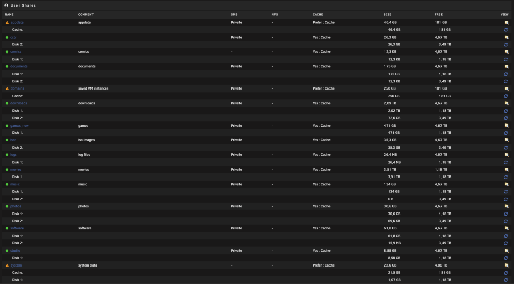

About appdata, I only see Compute All on the bottom of Shares but not under appdata.  Here's what I see below ... if I'm not mistaken it's recommended to keep the appdata, domains, and system on cache but it's then not backed up to the array so I can lose these critical items?
Edited by bugsysiegals
The warning triangle is just to inform you that the share has unprotected files. Nothing really to fix, you can backup appdata, for example with a plugin.
You can have protection for files on pools (cache) by making it a mirrored btrfs raid1 pool
