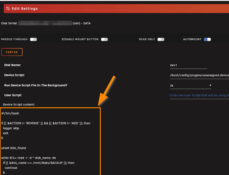

- open the settings of your eSATA/USB backup disk in the UD list
- paste the following script into the device script content area
- enable automount
- mount the disk the first time

16 hours ago, hawihoney said:
the "Device Script Content" field is the wrong way to paste the code?
No. Device Script Content is correct as you can see in my above screenshot.
