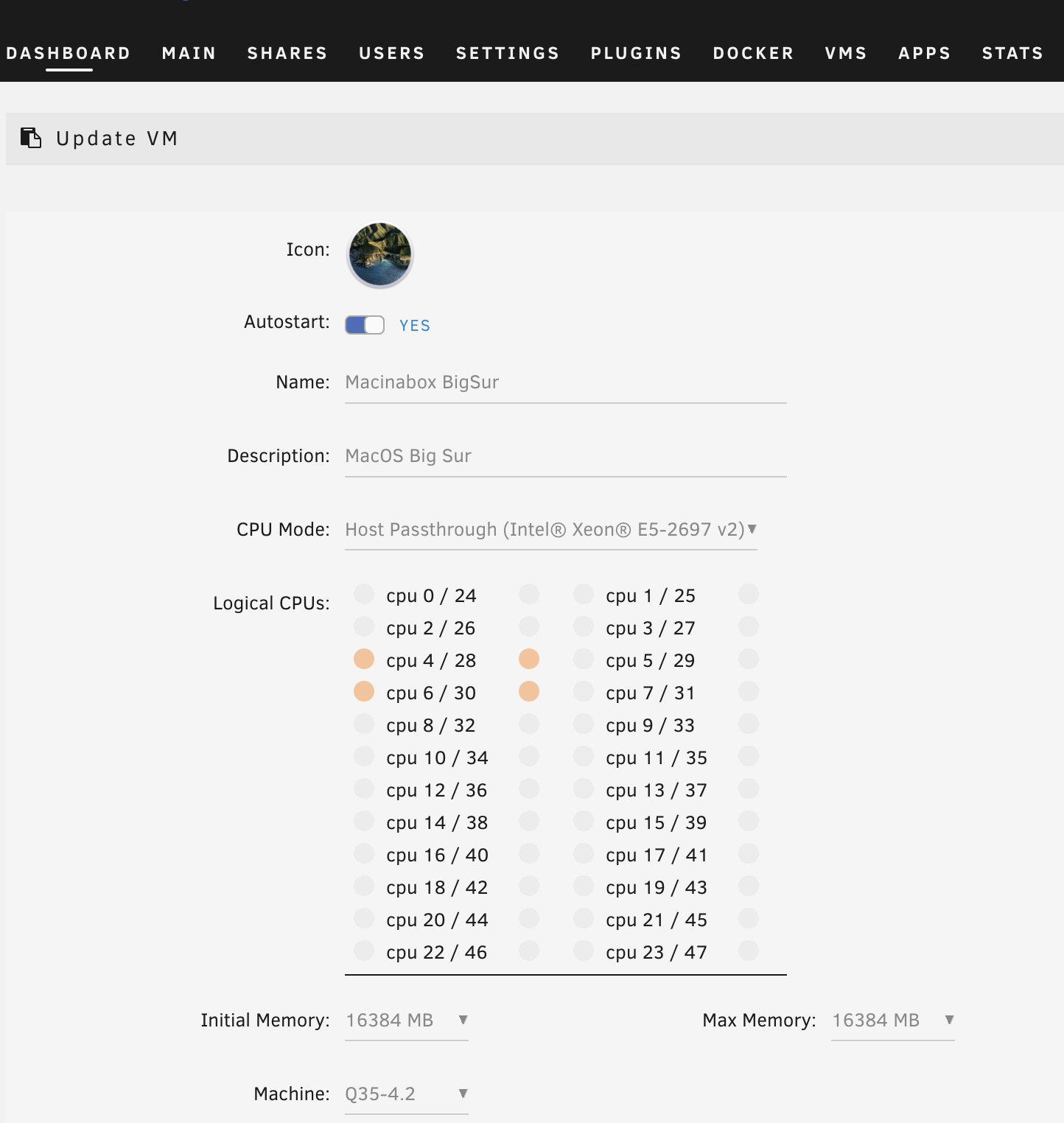

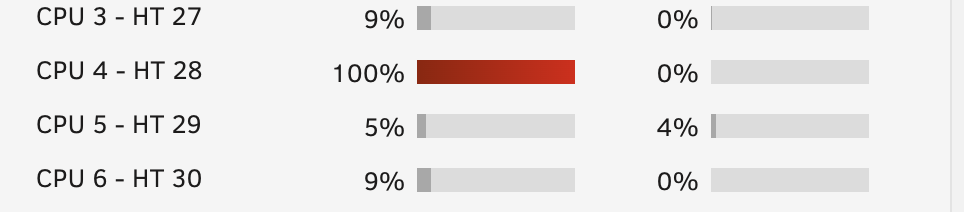

I was able to get Macinabox working from @SpaceInvaderOne s videos, but I am running into an issue now whenever I boot up the VM, the first CPU linked to the VM goes to 100% usage while the others I have allocated do nothing. The VM then hangs almost indefinitely.
Included my XML configuration and a few screenshots:

Solved by ghost82
TY @ghost82 that solved it for me!
For anyone else reading this, I added the xml linked above to my vm config, it then booted fine :)
