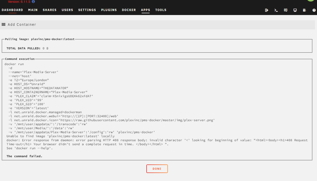

lukej33 Posted January 29 Share Posted January 29 (edited) Hello, Appreciate any advice or help with this one as i am stumped. Long story short, my Plex docker container randomly stopped working, was working fine the night before and the following morning I was for some reason unauthorised to access my own media server. I faffed with reclaiming it, restarting docker, the whole Nas etc. Ultimately I took the decision to back my plex config folder up and delete the plex container and start again. This is where I am at, I now cannot install Plex or any other docker container from the Apps menu. This is the error I get when I try to install this. Ive tried binhex plex and even tried sonarrr just to see if it was th eplex official repo that was th eissue and unfortunately all of those failed with the same error. The NAS has functional internet and I was able to update a docker container already installed. I also have the issue reported here after an update to Apps, and have tried both the manual patch method and the docker patch app it mentions. I mention this because the Docker patch app here did just install. Help with this would be much appreciated. LEt me know what logs and info would be helpful. Edit 1 Unraid version 6.11.5 Apps Version 2023.01.28 Docker VErsion 20.10.21 Edit 2 - Added diagnostics as requested thedatanator-diagnostics-20230129-1516.zip Cheers, Luke Edited January 29 by lukej33 added unraid apps and docker versions for clarity and diagnostics Quote Link to comment

lukej33 Posted January 29 Author Share Posted January 29 4 hours ago, Squid said: Not sure. Try closing any and all browser sessions to the server (phone / tablet etc) and try again after a reboot Hey Squid, Gave that a go, no joy unfortunately 😞. I tried via CLI as well, same error, very weird. Cheers, Luke Quote Link to comment
m33ts4k0z Posted January 29 Share Posted January 29 Just some ideas. A couple of things you could try: Totally remove the image and let Unraid re-acquire it. Try loging in to Unraid from an incognito window. Quote Link to comment
lukej33 Posted January 30 Author Share Posted January 30 Hey, Tried in an incognito window, no change. Re removing the image - when i deleted the old Plex container, i selected the remove image button. I also renamed the config folder so it is essentially a new install. Is there another part of the image to delete? If so, where would I find that? Thanks, Luke Quote Link to comment
