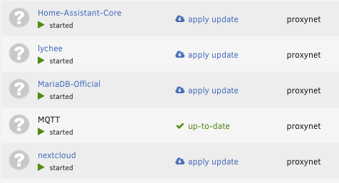

January 29, 20233 yr Recently, (probably around January 17th) my nextcloud auto upload stopped working. So I thought rebooting the system would fix it. But that didn't work. So I thought maybe updating the app would work, but whenever I tried updating it, I get this error "Configuration not found. Was this container created using this plugin?" All the apps are still working, my plex is working and qbittorrent etc all work, but I can't seem to update any app and can't login to nextcloud gives me a 500 server error when trying to login. Attaching diagnostics. tower-diagnostics-20230129-1258.zip

January 30, 20233 yr Author 10 minutes ago, trurl said: FTFY i figured the path had a typo, so I checked that directory is now empty except for the new app I installed. so everything is working but as you mentioned webUI doesn't know what is going on and I can't update any apps. But all my docker apps actually still run. If I remove each container, is there a way to save the config, or should I just manually like take a screnshot of my setting and reinstall everything.
January 30, 20233 yr Author Oh damn, looks like it doesn't even have the edit button so I can't even check the previous config... 😭
