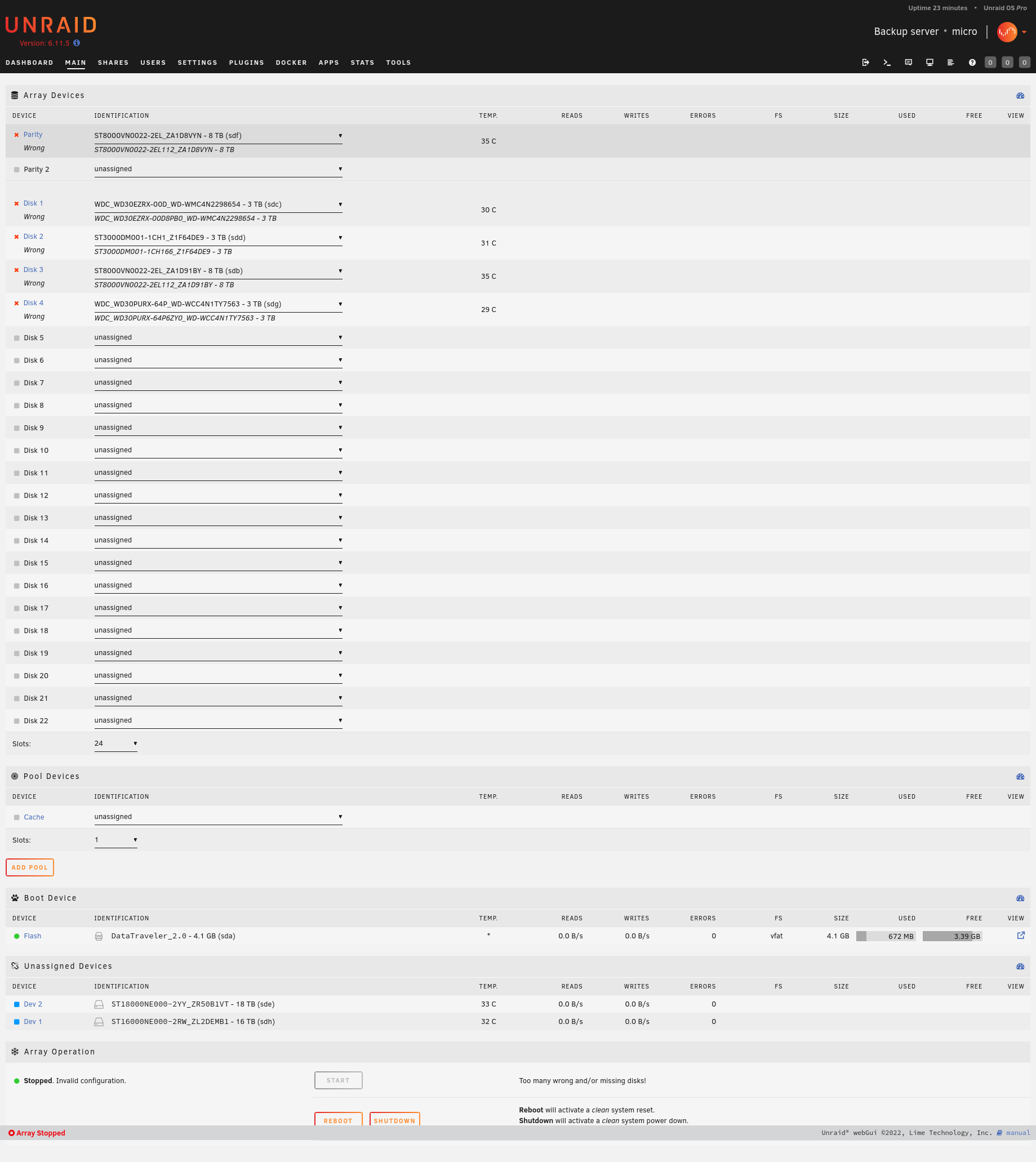

New system all wrong disks
I am trying to move to a more flexible setup but having problems. not sure if new MB or the HBA but all drives report differently and therefore cant start the array. how can i tell it to try these disks?

06:00.0 RAID bus controller [0104]: Broadcom / LSI MegaRAID SAS 2208 [Thunderbolt] [1000:005b] (rev 05)
	Subsystem: Intel Corporation RS25DB080 RAID Controller [8086:9265]
	Kernel driver in use: megaraid_sas
	Kernel modules: megaraid_sas
RAID controllers are NOT recommended for many reasons, including the problem you are experiencing.
Hmm, that is some very interesting information, thanks for that.
Is there a way to circumvent this problem that i am experiencing?
Ideally obviously, I will change to a non raid card. The chassis has a 12port backplane in the front with 3 sas ports (SFF-8087 i think). what card would people recommend?
You can do a new config, but the best way would be to use a non RAID controller
Thanks for all the info. have ordered a card per the recommended controllers.
I also noticed that the firmware on my card (RS25DB080) was very very old(23.7.XXX) so i updated it to the newest version (23.34.0-0019). This has actually solved the issue with the disks having different identification and the array now loads up perfect.
Will add in the new card still when i get it
