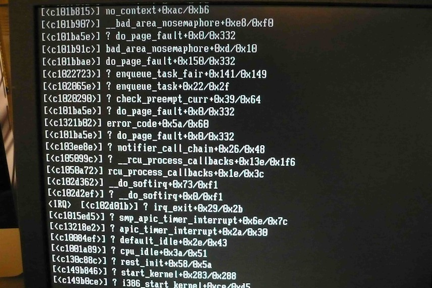

July 22, 201115 yr Author Thanks for taking a look at this for me prostuff1. I wasn't able to copy and paste but I took a picture of my console screen after I ran that very command last night. It is attached. I ran memtest overnight back when I first set up UNRAID and saw nothing that concerned me. I can certainly run it again. Bryan
July 22, 201115 yr Thanks for taking a look at this for me prostuff1. I wasn't able to copy and paste but I took a picture of my console screen after I ran that very command last night. It is attached. I ran memtest overnight back when I first set up UNRAID and saw nothing that concerned me. I can certainly run it again. Bryan Try running the same command in a telnet connection so that more info can be captured. Is there a certain thing that seems to cause this? Does it happen at a certain time? Running another memtest overnight would not be a bad idea.
July 22, 201115 yr There is a kernel bug call trace at the end of the syslog and it looks to be related to a SATA expansion card. You may want to pull the Supermicro and run without it for a bit to see if the problem clears up. If you do the telnet syslog tail then depending on the telnet software you may also want to increase the buffer size so you get even more of the log. Peter
July 22, 201115 yr Peter, isn't that usb/the flash drive? Still looks like a corrupted filesystem problem to me (radix_tree) but now I'd want to see more crash dumps.
