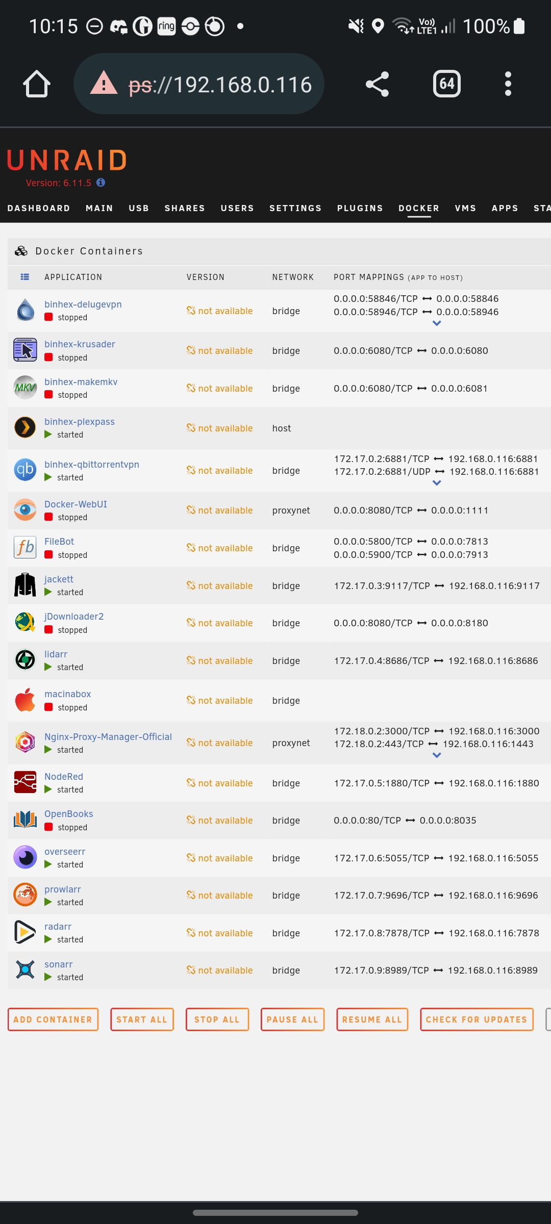

I'm running the latest version of unRaid. Recently we had a bad storm and our modem/router as well as our network switch died. I've since replaced both, but if you look at the screenshot of the Docker section under Version it says unavailable. I suspect it's an issue with my router, because I also can't remotely access my server, but I did open the port and nothing changed.

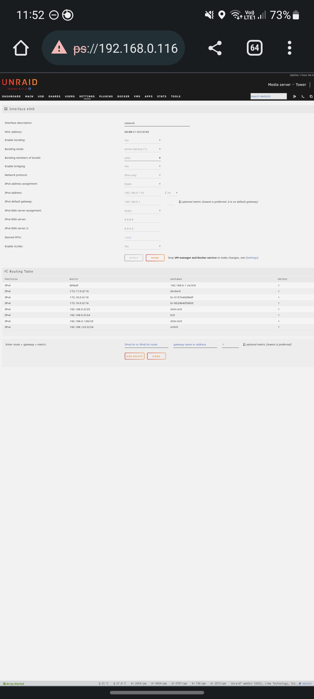

Just in case it helps, I've attached a screenshot of the network settings in the server. They haven't been altered, those settings were working before the network went down.

I reset the router and I've managed to setup access to my server from outside the network. I also had about 8 plugins report that an update was available, so they are all now up to date. I'm still getting the same message in Docker though.
Any thoughts?

Did you reserve the IP address of  192.168.0.116  on the router to prevent that address from being assigned by the router using its DCHP process?  (You might need to know the MAC address of the NIC to do this.  By the way, the router should be in the 192.168.0/xxx subnet for things to work properly.  If the base address of the router is in the 192.168.1.xxx subnet-- or any other subnet,  Change Unraid to use DCHP and get a  new address in the proper range.  Then either set up the router to always assign that address to your server OR set that new address as a Static address on the router and change Unraid back to Static with the new address.  Can't give more help than a very general one as every router is different in the way it handles this situation.)
