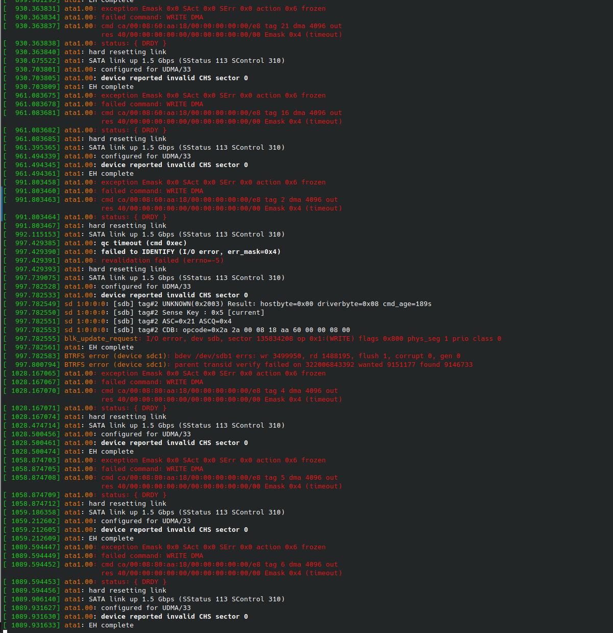

Only this time the system never came back up (Atleast not the webui) So i checked dmesg via ssh and found it was continuously spamming this.
Spoiler
c6a7a
From what i understand this is usually cause by bad sata connections but at this point i have tried re-seating the cables, replacing the cables and switching to diferent sata ports on the MB. It changed nothing.

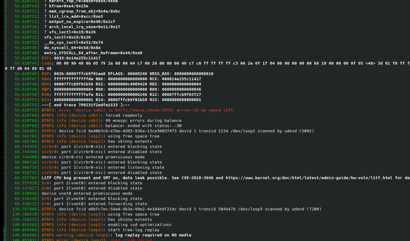

Usually after a while the errors will stop and the mebgui will load but as soon as i try to access files on cache it starts up again and files are inaccessible.
My guess is one of the drives is failing but i have seeb both drives mentioned in the errors so i have no idea which one.

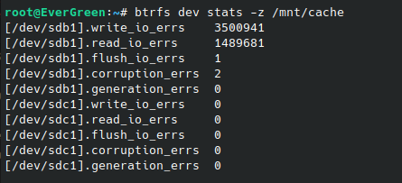

Edit: Looks like its sdb. But not sure if i should just remove it or attempt a scrub...

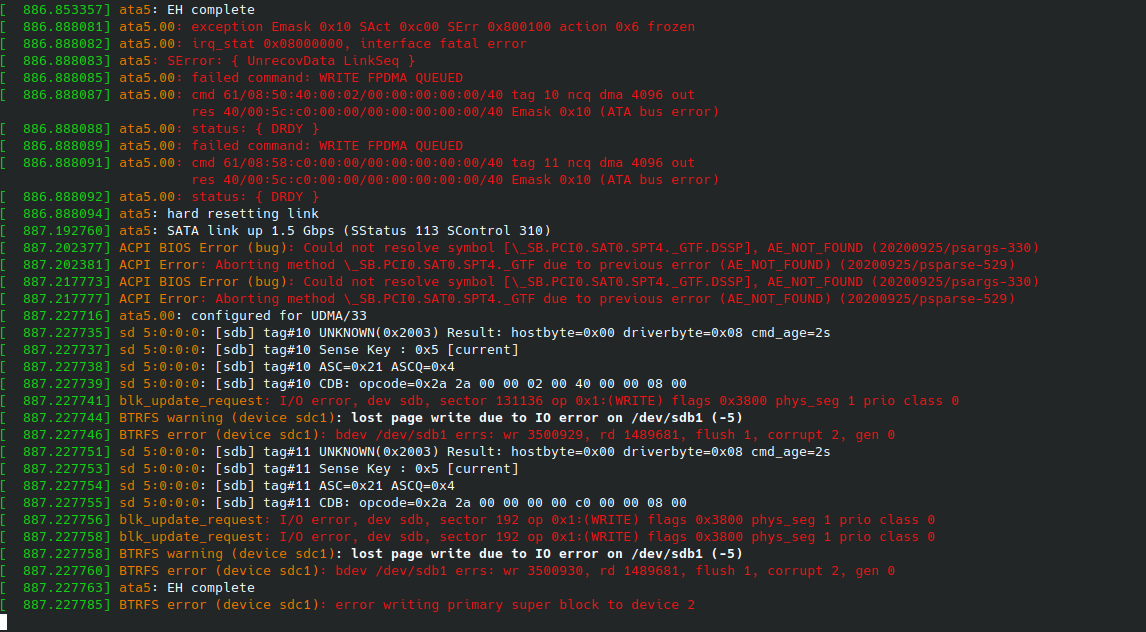

Looks more like a power/connection problem, check/replace cables for cache2 and post new diags after array start.
I already checked and replaced the cables to both SSD's and it had no effect. Power connections also look good but i dont have a free sata power cable to rule it out completely.
The First report attached to this post was generated while the server was attemptine to start. (via ssh) The second was generated when the GUI finally loaded.
evergreen-diagnostics-20230208-2225.zip evergreen-diagnostics-20230208-2235.zip
Still showing the same issues, if cables didn't help remove that SSD, pool is mirrored so it should keep working, then add another device if you want to keep it raid1.
