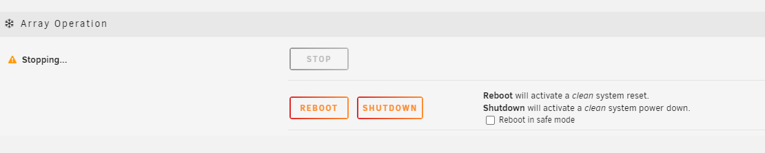

I just tried file check with -L flag. After it, I found that SHARES can displayed and VMS could be started ( Docker service still could not be started). Now I tried to stop the array and check it again, but I found that the array is stopped in STOPPING state and can't really stop completely
Edited by tsq456
26 minutes ago, tsq456 said:
I just tried file check with -L flag. After it, I found that VMS could be displayed ( Docker service still could not be started). Now I tried to stop the array and check it again, but I found that the array is stopped in STOPPING state and can't really stop completely
The array is actually stopped, but the status is always STOPPING, because vms have prompted "Array must be started to view Virtual Machines"
syslog: syslog.txt
what can I do with this problem? I can not do file check again because of it.
Edited by tsq456
Still a lot of error on the syslog, type reboot in the console, if it doesn't reboot after 5 minutes force it, then post new diags after array start.
