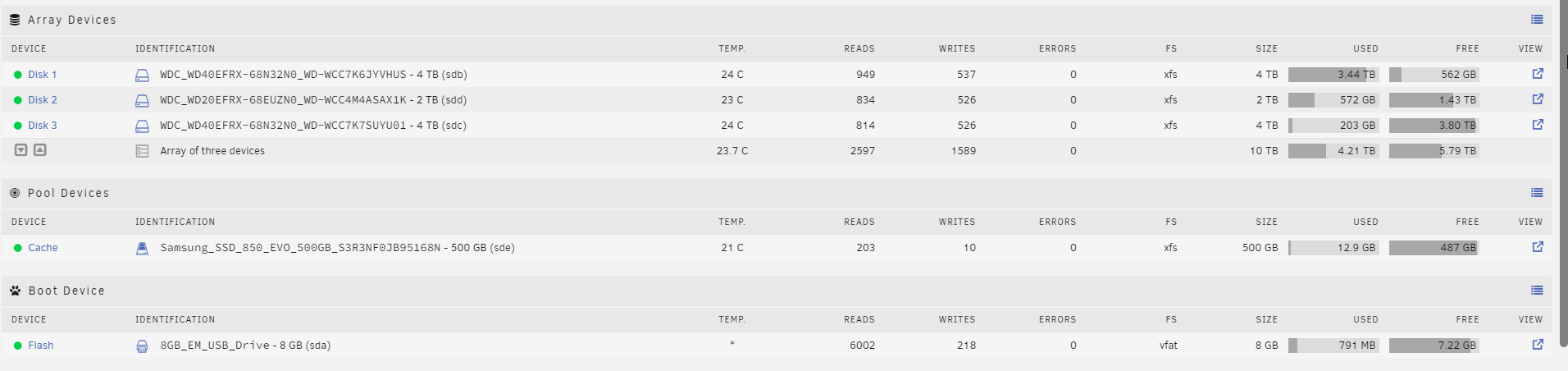

HP Microserver Gen10
3x Array disks (not in parity) (sdb, sdc, sdd)
Cache drive on 50GB SSD (sde)
Flash on 8GB USB stick (sda)

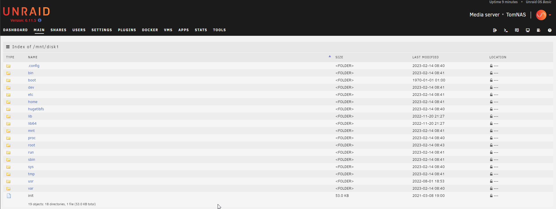

When I click on SDB, Disk 1 in the array, I only see system files and none of my data.  I would expect to see a list of "share folders" in here and not a linux root folder layout. When I click on Disk2 and Disk3 I see all the data I expect to see.

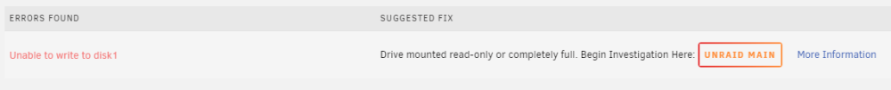

When I click on "Fix common problems" it seems that Disk 1 is read-only or full
But it's full not - and it's showing the amout of "Used" space to be what I expect this disk to be at - as disk 3 is now where all my new data is being written to. And I can't see it being read only anywhere, only that the data looks weird on the disk when I click "View".

25 minutes ago, JorgeB said:
Check filesystem on disk1.
Thank you - Attached is the output of check disk against Disk1. It looks like there might be something that didn't finish with a success message, so I've tried to run the same option wihtout the "n" flag.
However when I come to run the following command (while the array is still up in maint-mode) I get this error.
root@TomNAS:/dev# xfs_repair -v /dev/sdb1
Phase 1 - find and verify superblock...
        - block cache size set to 709656 entries
Phase 2 - using internal log
        - zero log...
zero_log: head block 859423 tail block 859419
ERROR: The filesystem has valuable metadata changes in a log which needs to
be replayed.  Mount the filesystem to replay the log, and unmount it before
re-running xfs_repair.  If you are unable to mount the filesystem, then use
the -L option to destroy the log and attempt a repair.
Note that destroying the log may cause corruption -- please attempt a mount
of the filesystem before doing this.
Do I need to stop the array to carry out the option to fix the problem do you think?
checkdisk.txt
That message is quite normal as described here in the online documentation describing the process for repairing an XFS file system.  You need to run without -n and add -L.
Thank you!  I am normally way better at this but my brain is all foggy. Am I at any risk that the -L removes any data off the disk or wipes it other than stuff that's corrupted?
There's always some risk of data loss when repairing a filesystem, but it's basically the only option, other than formatting the disk and restoring from a backup.
the worst the -L option will do (if anything) is remove the last changes to the drive.
Thank you so much! They array is back online and all my shares are there!

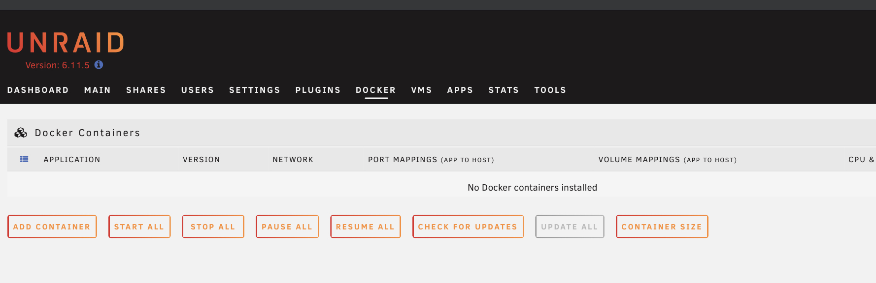

However the dockers aren’t, maybe the docker.img was corrupted? Is there any advice about where to start with that? I’ve uploaded a fresh drag but I can’t see anything obvious in the logs to why the dockers aren’t defined any more…
tomnas-diagnostics-20230214-1730.zip
Docker image is mounting, but based on the transid it's new, possibly it was on disk1 before a new one was created on cache, you can point to the old one or just re-add all containers using the previous apps option in CA.
