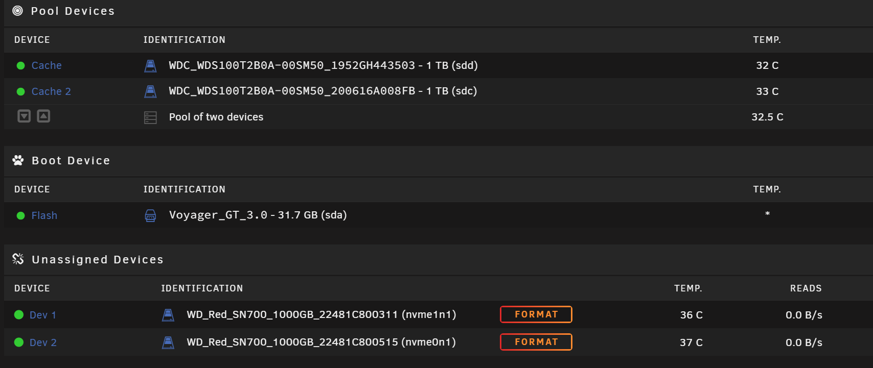

Now I want to replace disk by disk to 2 WD Red SN700 1TB NVME drives. These disks are marked as "Unassigned Devices" at the moment:

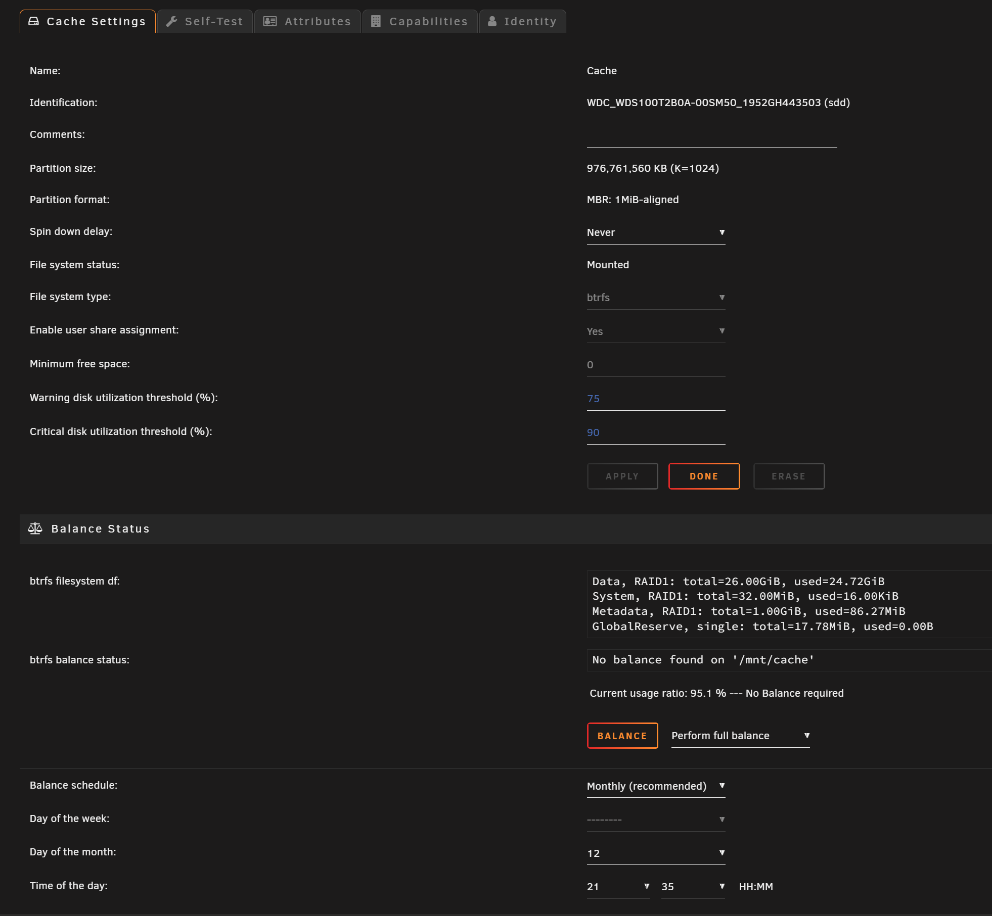

Have you made sure that the current pool is in a redundant mode?
It might be a good idea to post your system's diagnostics zip file so we can check to see if we spot any potential problems !
I am pretty sure that the cache pool is running in Raid1 mode:
Please find my diagnostic zip file attached, thank you for checking :)
tower-diagnostics-20230217-1413.zip
It is, you can upgrade the devices one at a time.

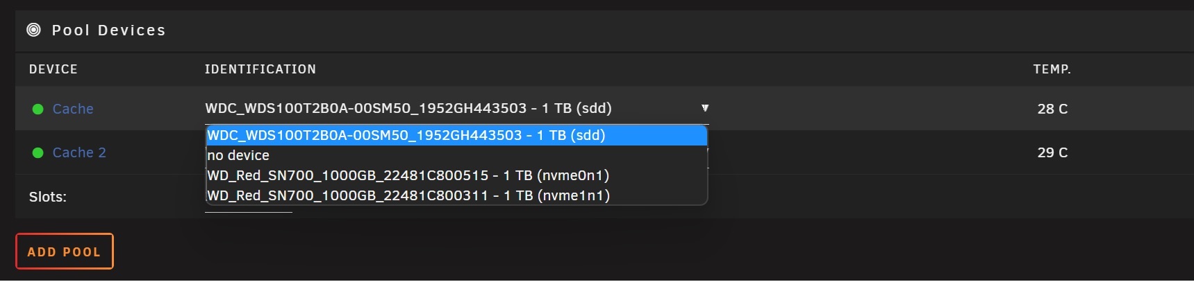

- stop the array
- select one cache drive and change it to the new NVME
- start the array
- > wait for rebuild?
Yes.

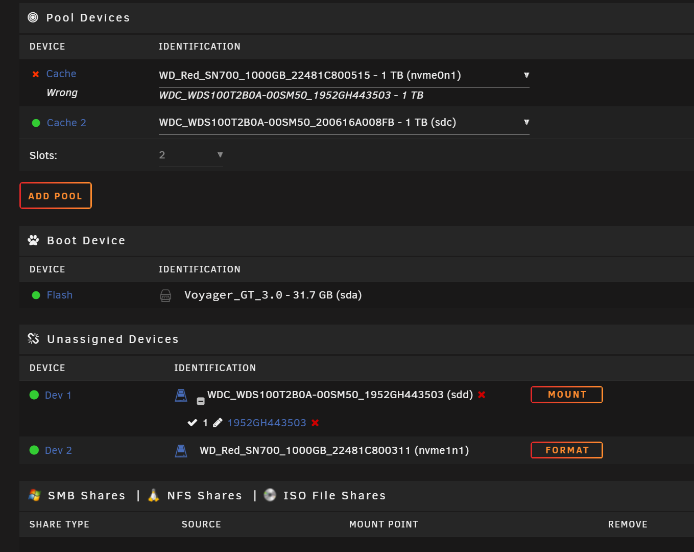

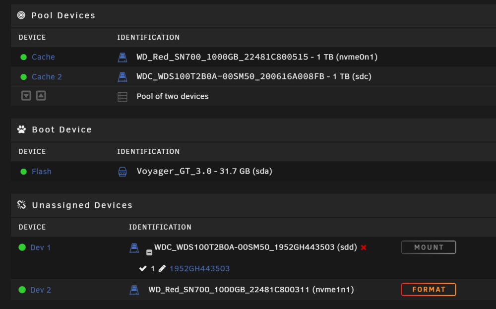

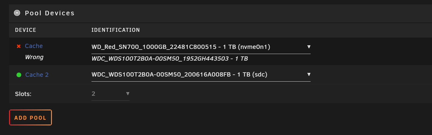

Before I start...
This is the screen of a stopped array and one disk changed to new NVME:
This is correct? Now I have to start the array? Sorry for asking...
Here are the unassigned devices:
Edited by Civic1201
Yep.
Thank you!

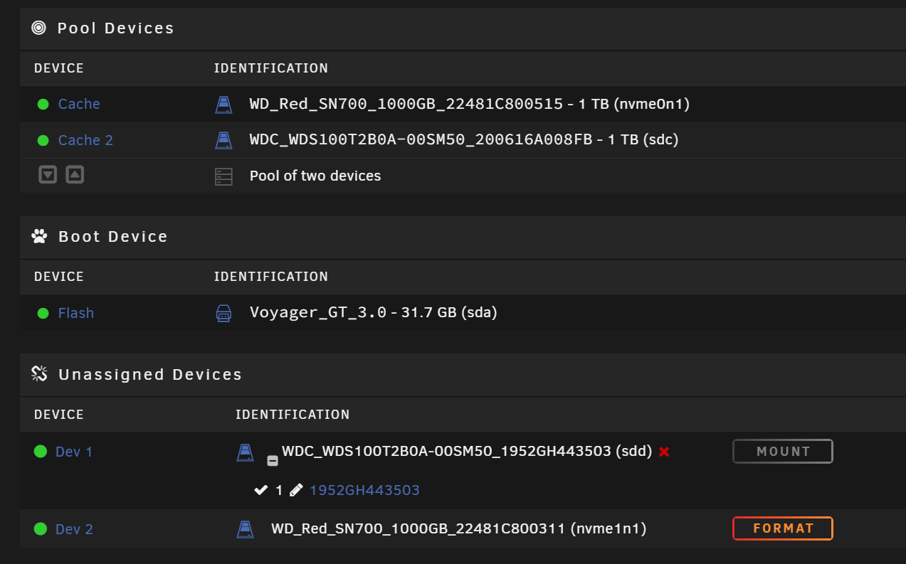

I think it worked:
Will stop the array again an change the second disk to NVME.

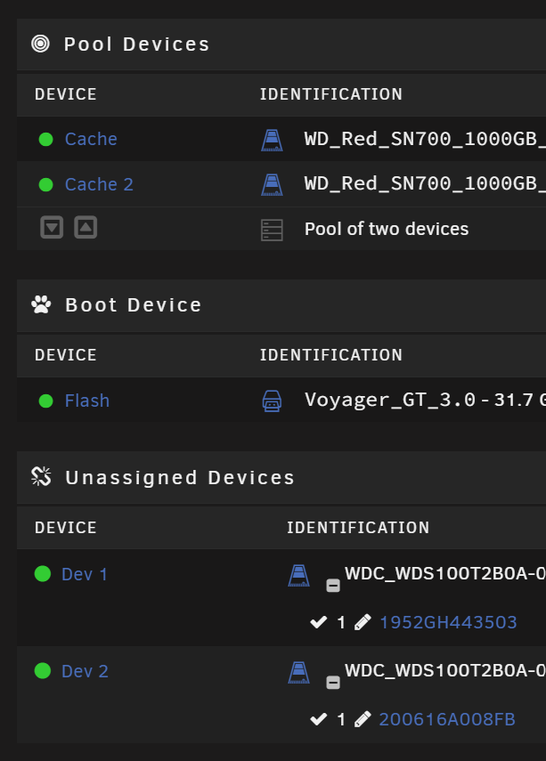

Yes! Both disks were changed to NVME, "old" SATA disk ar now unassigned devices.
Thanks again for your help!
