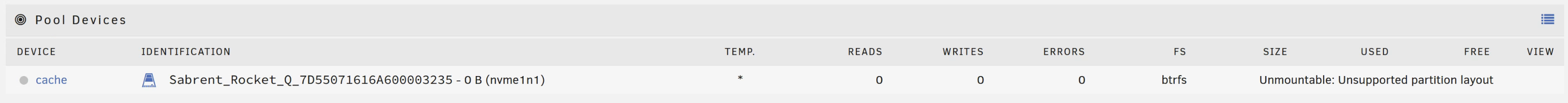

Server booted up and went into Unraid as normal, drives automatically re-mounted themselves and I thought we were back up and running. Then I looked and noticed docker is no longer running and a grey dot has appeared next to the 'cache' label instead of the usual green and now the drive has a reported capacity of 0 B (It should be 2 TB)
My first instinct tells me that the drive has failed, although it is a reasonably new drive (6 months old). I thought It was worth a post here to see if anyone has any ideas on how to proceed.

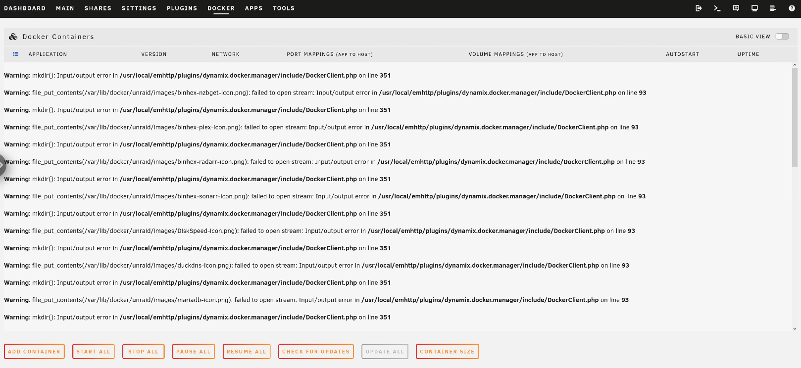

It appears that has mostly worked. The docker containers are back online but the docker tab in the UI is looking different.
