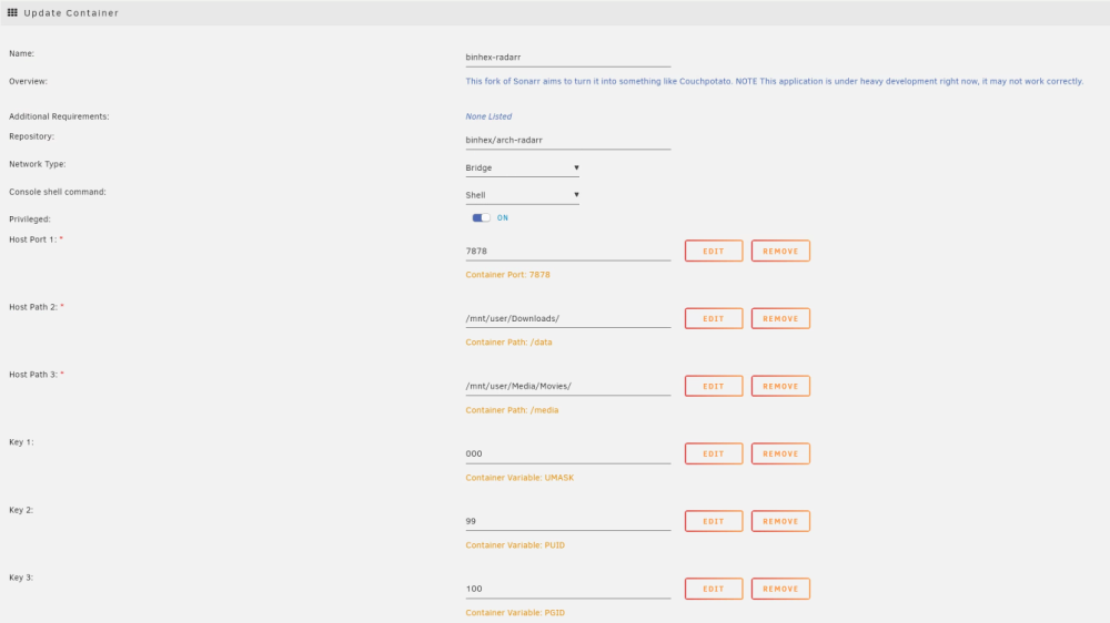

  2. I have been having some issues with the container over the past few weeks (it has been running fine for years) so I decided to give it a reinstall. I have set it up exactly the same way as before and everything works fine until I try to import existing media. I have tried the following commands but none have worked. ```docker exec -it binhex-radarr /bin/bash``` ```chown -R nobody:nobody media``` ```chmod -R 777 /media/``` When I run ls -la on the media folder every file returns drwxrwxrwx 1 nobody nobody <size> <date> <folder name>
  3. Knew I was in the wrong place. I will post there, thanks.
  4. Hi All, I have been having some issues with the binhex-radarr docker container over the past few weeks so I decided to give it a reinstall. I have set it up exactly the same way as before and everything works fine until I try to import existing media. This is above my understanding so I am a bit lost about what to do. I have tried the following commands but none have worked. ```docker exec -it binhex-radarr /bin/bash``` ```chown -R nobody:nobody media``` ```chmod -R 777 /media/``` When I run ls -la on the media folder every file returns drwxrwxrwx 1 nobody nobody <size> <date> <folder name> See below for the docker container setup
