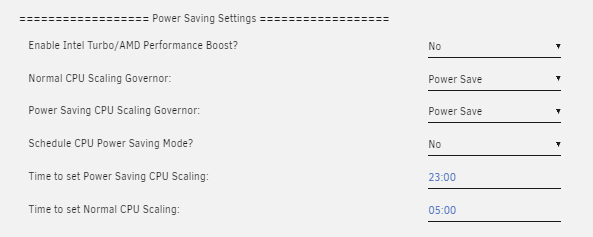

I have also enabled power saving in tips and tweaks as this is what brought me under the 150w I was looking for, do you think that could have any influence on this problem?
