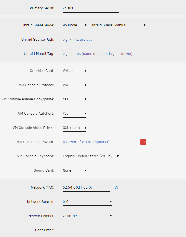

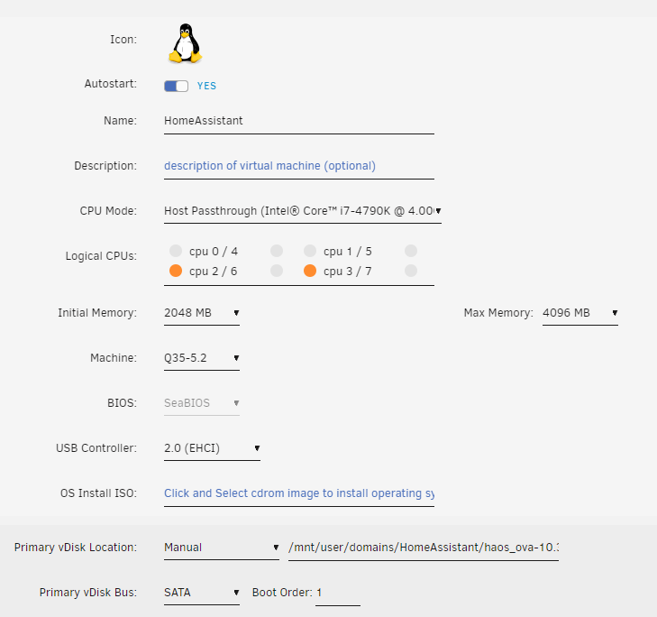

February 21, 20233 yr Hi, i have recently installed Unraid on my old Lenovo pc. Unraid is up and running, but i have a problem when i try to install Home Assistant using a VM. Not sure if this is the correct place to post this, but hopefully someone smarter than me has allready been trough this. I have allready checked that i use the correct info, when i make the VM. Using Xcow2 vm file Using 2 Cores CPU RAM: 2048-4096 And have tried using SATA as well as VirtIO as Primary vDisk Bus. Attached are a picture of my Unraid VM info. This is where the OS wont boot, it’s stuck in this BIOS shell. I can type Exit and can enter a menu. I have seen someone with a simular problem and they fixed it with disabling Secure Boot. I can’t see a Secure boot option in this menu.( Checked everywhere ) Posted on Home Assistant Community Forums aswell, as i am not sure where this fits best. Link to Home Assistant Forums thread: https://community.home-assistant.io/t/home-assistant-stuck-in-uefi-shell-unraid/538268

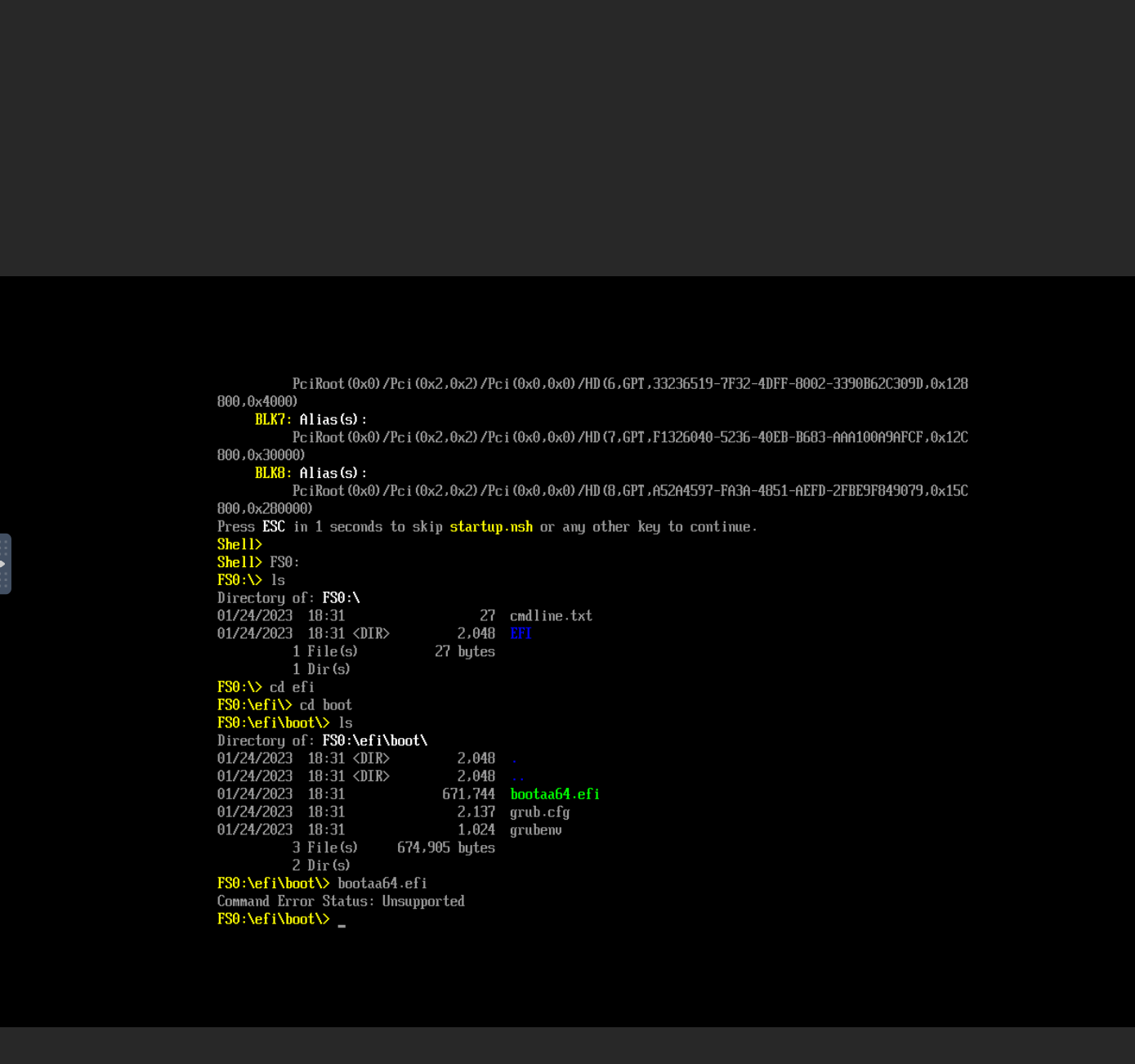

February 21, 20233 yr try to boot from the uefi shell: type: FS0: and press enter Then list directories and files with dir command (the uefi shell is like a command prompt) and navigate (with the cd command) somewhere since you will find an .efi file to boot. No idea what is the file in your case, as an example for microsfot it's in: FS0:\EFI\Microsoft\Boot\bootmgfw.efi To manually boot, just type name.efi and the boot should proceed. Edited February 21, 20233 yr by ghost82
February 22, 20233 yr Author 20 hours ago, ghost82 said: try to boot from the uefi shell: type: FS0: and press enter Then list directories and files with dir command (the uefi shell is like a command prompt) and navigate (with the cd command) somewhere since you will find an .efi file to boot. No idea what is the file in your case, as an example for microsfot it's in: FS0:\EFI\Microsoft\Boot\bootmgfw.efi To manually boot, just type name.efi and the boot should proceed. I tried this and still no luck. Attached are the commands i used and the error message. Edited February 22, 20233 yr by Hellesylt Attatchment
February 22, 20233 yr ooooh I see now...you downloaded the arch64 architecture which is unsupported, you need to download the x86_x64 version!
February 22, 20233 yr Author Solution 19 minutes ago, ghost82 said: ooooh I see now...you downloaded the arch64 architecture which is unsupported, you need to download the x86_x64 version! Thank you so much! For future dummies like me: Use the haos_ova-9.5.qcow2 Virtual Disk file from Home Assistant Github.

July 30, 20233 yr Thank you @ghost82 it's nice to see others leave a bread crumb trail like I do. I'm still struggling on this though unfortunately. When I try to mount the generic KVM image, I'm getting "no bootable device" can someone let me know if my settings look correct, I'd really appreciate it! I'm assuming it's one of the KVM settings not figuring this out but I'm not 100% on it. <?xml version='1.0' encoding='UTF-8'?> <domain type='kvm'> <name>HomeAssistant</name> <uuid>62bf0a39-a5b4-07a7-2213-9e5aaa554cab</uuid> <metadata> <vmtemplate xmlns="unraid" name="Linux" icon="linux.png" os="linux"/> </metadata> <memory unit='KiB'>4194304</memory> <currentMemory unit='KiB'>2097152</currentMemory> <memoryBacking> <nosharepages/> </memoryBacking> <vcpu placement='static'>2</vcpu> <cputune> <vcpupin vcpu='0' cpuset='2'/> <vcpupin vcpu='1' cpuset='3'/> </cputune> <os> <type arch='x86_64' machine='pc-q35-5.2'>hvm</type> </os> <features> <acpi/> <apic/> </features> <cpu mode='host-passthrough' check='none' migratable='on'> <topology sockets='1' dies='1' cores='1' threads='2'/> <cache mode='passthrough'/> </cpu> <clock offset='utc'> <timer name='rtc' tickpolicy='catchup'/> <timer name='pit' tickpolicy='delay'/> <timer name='hpet' present='no'/> </clock> <on_poweroff>destroy</on_poweroff> <on_reboot>restart</on_reboot> <on_crash>restart</on_crash> <devices> <emulator>/usr/local/sbin/qemu</emulator> <disk type='file' device='disk'> <driver name='qemu' type='raw' cache='writeback'/> <source file='/mnt/user/domains/HomeAssistant/haos_ova-10.3.qcow2'/> <target dev='hdc' bus='sata'/> <serial>vdisk1</serial> <boot order='1'/> <address type='drive' controller='0' bus='0' target='0' unit='2'/> </disk> <controller type='usb' index='0' model='ich9-ehci1'> <address type='pci' domain='0x0000' bus='0x00' slot='0x07' function='0x7'/> </controller> <controller type='usb' index='0' model='ich9-uhci1'> <master startport='0'/> <address type='pci' domain='0x0000' bus='0x00' slot='0x07' function='0x0' multifunction='on'/> </controller> <controller type='usb' index='0' model='ich9-uhci2'> <master startport='2'/> <address type='pci' domain='0x0000' bus='0x00' slot='0x07' function='0x1' multifunction='on'/> </controller> <controller type='usb' index='0' model='ich9-uhci3'> <master startport='4'/> <address type='pci' domain='0x0000' bus='0x00' slot='0x07' function='0x2'/> </controller> <controller type='pci' index='0' model='pcie-root'/> <controller type='pci' index='1' model='pcie-root-port'> <model name='pcie-root-port'/> <target chassis='1' port='0x10'/> <address type='pci' domain='0x0000' bus='0x00' slot='0x02' function='0x0' multifunction='on'/> </controller> <controller type='pci' index='2' model='pcie-root-port'> <model name='pcie-root-port'/> <target chassis='2' port='0x11'/> <address type='pci' domain='0x0000' bus='0x00' slot='0x02' function='0x1'/> </controller> <controller type='pci' index='3' model='pcie-root-port'> <model name='pcie-root-port'/> <target chassis='3' port='0x12'/> <address type='pci' domain='0x0000' bus='0x00' slot='0x02' function='0x2'/> </controller> <controller type='pci' index='4' model='pcie-root-port'> <model name='pcie-root-port'/> <target chassis='4' port='0x13'/> <address type='pci' domain='0x0000' bus='0x00' slot='0x02' function='0x3'/> </controller> <controller type='virtio-serial' index='0'> <address type='pci' domain='0x0000' bus='0x02' slot='0x00' function='0x0'/> </controller> <controller type='sata' index='0'> <address type='pci' domain='0x0000' bus='0x00' slot='0x1f' function='0x2'/> </controller> <interface type='bridge'> <mac address='52:54:00:f1:66:0c'/> <source bridge='br0'/> <model type='virtio-net'/> <address type='pci' domain='0x0000' bus='0x01' slot='0x00' function='0x0'/> </interface> <serial type='pty'> <target type='isa-serial' port='0'> <model name='isa-serial'/> </target> </serial> <console type='pty'> <target type='serial' port='0'/> </console> <channel type='unix'> <target type='virtio' name='org.qemu.guest_agent.0'/> <address type='virtio-serial' controller='0' bus='0' port='1'/> </channel> <channel type='qemu-vdagent'> <source> <clipboard copypaste='yes'/> <mouse mode='client'/> </source> <target type='virtio' name='com.redhat.spice.0'/> <address type='virtio-serial' controller='0' bus='0' port='2'/> </channel> <input type='tablet' bus='usb'> <address type='usb' bus='0' port='1'/> </input> <input type='mouse' bus='ps2'/> <input type='keyboard' bus='ps2'/> <graphics type='vnc' port='-1' autoport='yes' websocket='-1' listen='0.0.0.0' keymap='en-us'> <listen type='address' address='0.0.0.0'/> </graphics> <audio id='1' type='none'/> <video> <model type='qxl' ram='65536' vram='65536' vgamem='16384' heads='1' primary='yes'/> <address type='pci' domain='0x0000' bus='0x00' slot='0x01' function='0x0'/> </video> <memballoon model='virtio'> <address type='pci' domain='0x0000' bus='0x03' slot='0x00' function='0x0'/> </memballoon> </devices> </domain>
July 30, 20233 yr change from this: <driver name='qemu' type='raw' cache='writeback'/> <source file='/mnt/user/domains/HomeAssistant/haos_ova-10.3.qcow2'/> to this: <driver name='qemu' type='qcow2' cache='writeback'/> <source file='/mnt/user/domains/HomeAssistant/haos_ova-10.3.qcow2'/>
July 30, 20233 yr 3 minutes ago, ghost82 said: change from this: <driver name='qemu' type='raw' cache='writeback'/> <source file='/mnt/user/domains/HomeAssistant/haos_ova-10.3.qcow2'/> to this: <driver name='qemu' type='qcow2' cache='writeback'/> <source file='/mnt/user/domains/HomeAssistant/haos_ova-10.3.qcow2'/> Thank you! Ended up going the VMDK route and got it to go through instead. I appreciate the help!
