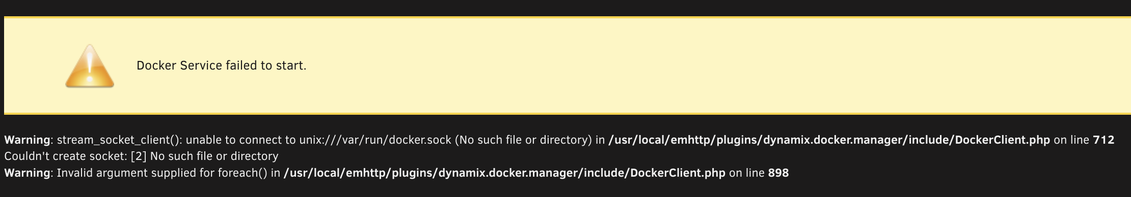

This morning my unRAID console was down.  After a quick look at things, I attempted a reboot of my instance and was met with a DB Disk Image Malformed error on my Radarr docker.  I also noticed that Sonarr wouldn't load correctly, so I rebooted again just to see if I got the same result.  Lo and behold, I am now receiving this when I go to my docker tab:
I'm fine with deleting my docker image and creating a new one, but I just want to ensure that is the correct course of action before doing anything.  Any help would be appreciated, thank you.  Also attaching a diagnostic.

I received an error in Fix Common Problems stating it's "unable to write to cache".  Cache is under 50% utilized.

Cache filesystem is corrupt, best to backup and re-format.
Feb 22 09:20:52 TresCommas kernel: BTRFS: error (device sdb1: state A) in do_free_extent_accounting:2852: errno=-22 unknown
Feb 22 09:20:52 TresCommas kernel: BTRFS info (device sdb1: state EA): forced readonly
Corrupt
You will have to try to copy it somewhere and reformat. Disable Docker and VM Manager in Settings until you get cache fixed.

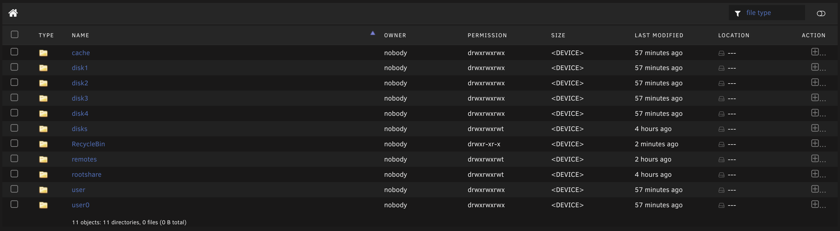

One question, and maybe a fundamental misunderstanding I have regarding unRAID shares and how the file systems are organized.  How can I find this share:
/boot/config/shares
I understand the command that I can run through Terminal, and I understand where it should be, but I've tried mounting this path in Krusader as a new host path and I can't access anything in the directory.
If you have the Dynamix File Manager plugin installed then you can simply get to its contents by going to the Boot Device on the Main tab.  Easier than trying to do it via Krusader.
Have the plugin, but don't see Boot listed:
/boot/config/shares
That path isn't a share, it is on the flash drive. Krusader won't be able to find it either unless you have a mapping to /boot.
Main - Boot Device. Click on the icon under VIEW
Got it, thank you.
