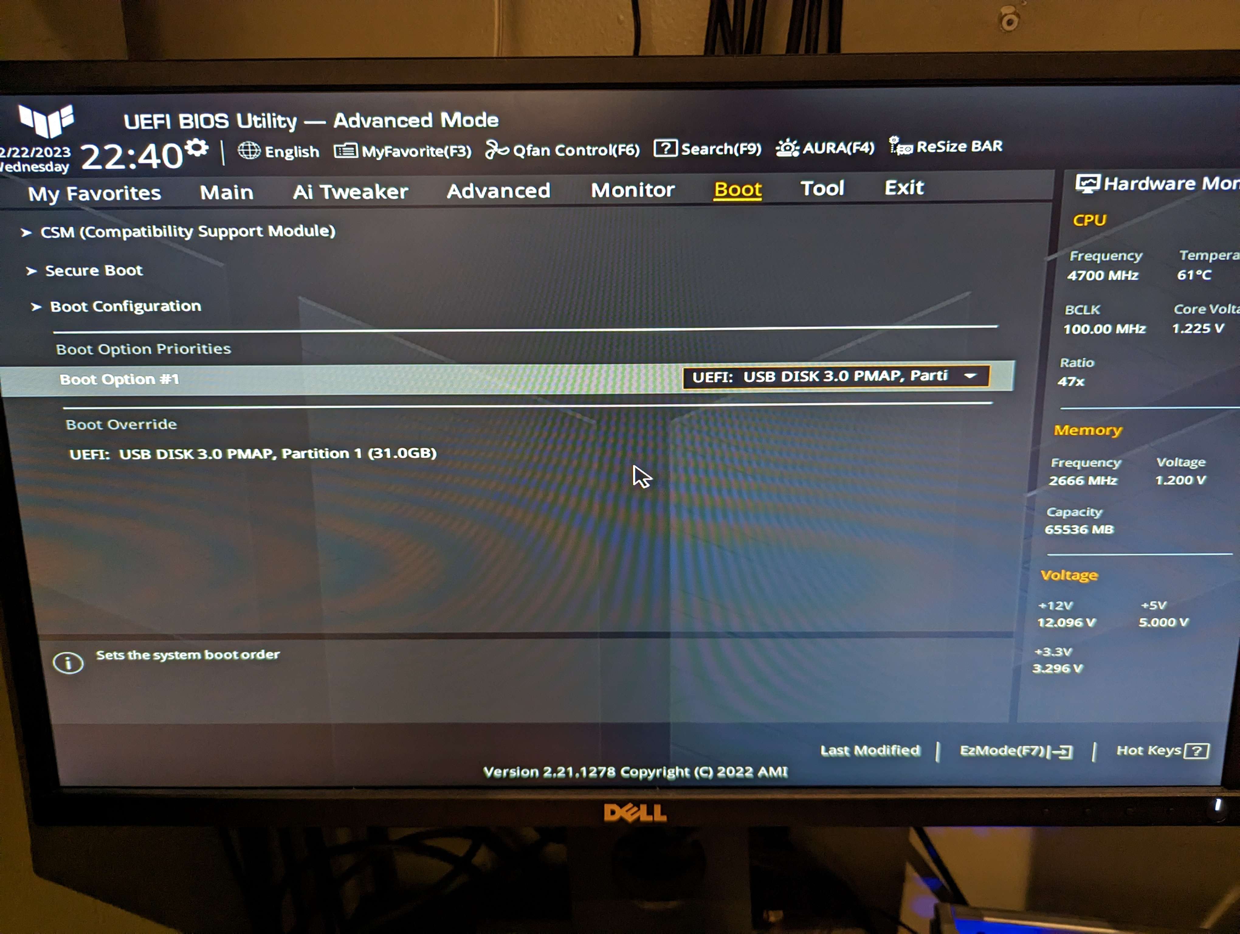

Can you post a photo of the BIOS boot page?
Will do Once I am home thanks for the quick replys I will drop it in here 7 Hours

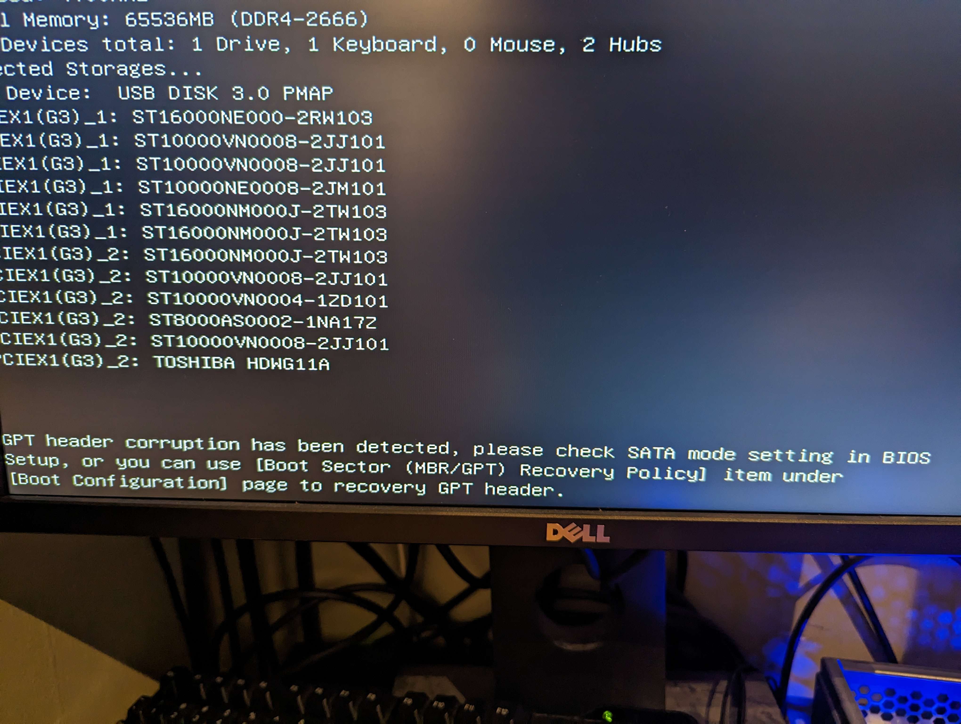

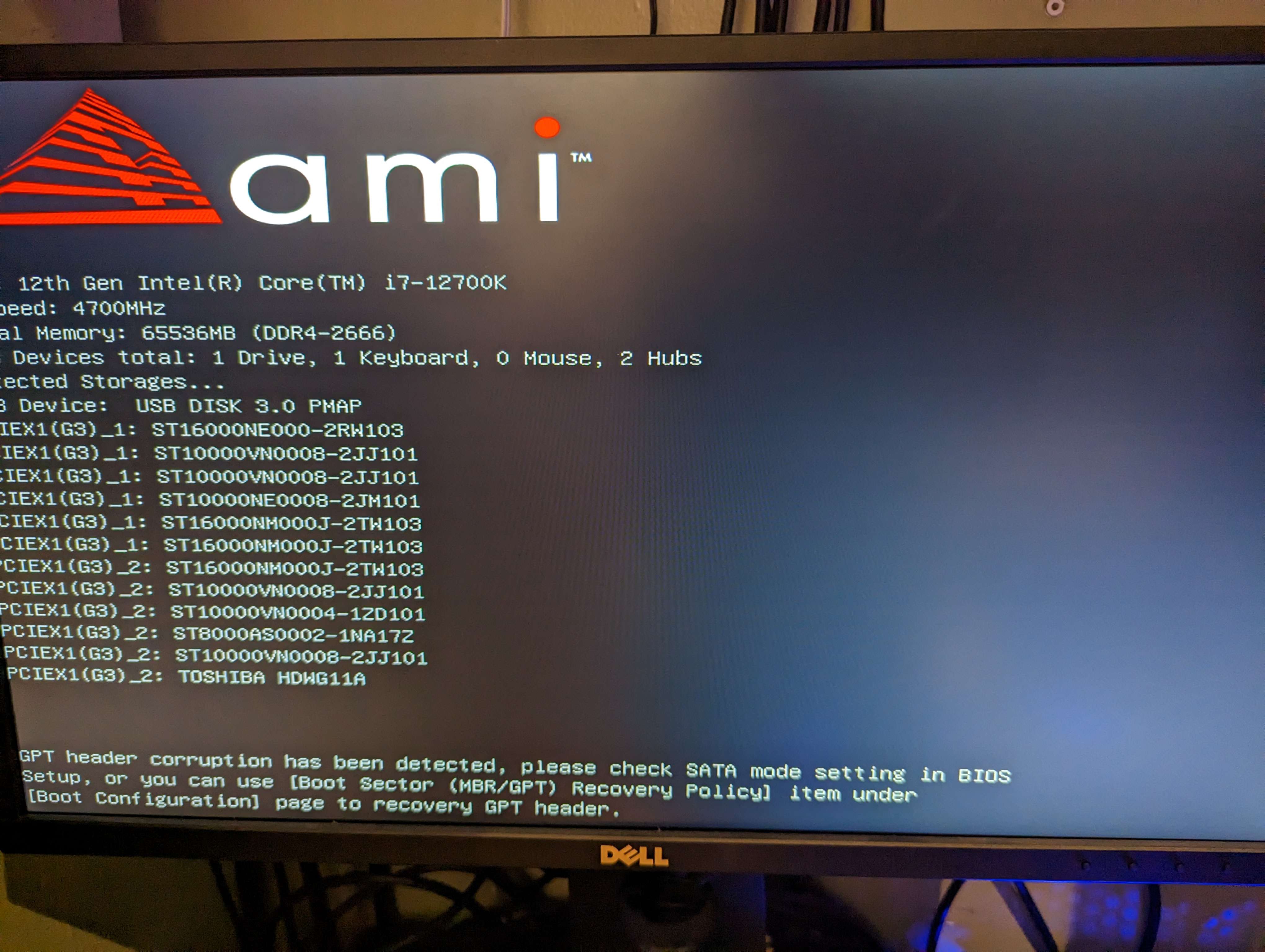

Sorry got caught up with extreme adulting today ugh, here are the photos I took, theres times it won't boot up at all and stay black, then it gives me the gpt error and i have to unplug each sata cable, and then even when boot overriding it goes into a loop.
Oh, I remember that from another user before, that's not about the flash drive, it's telling you one of the drives has a corrupt partition, boot Unraid and post the output of

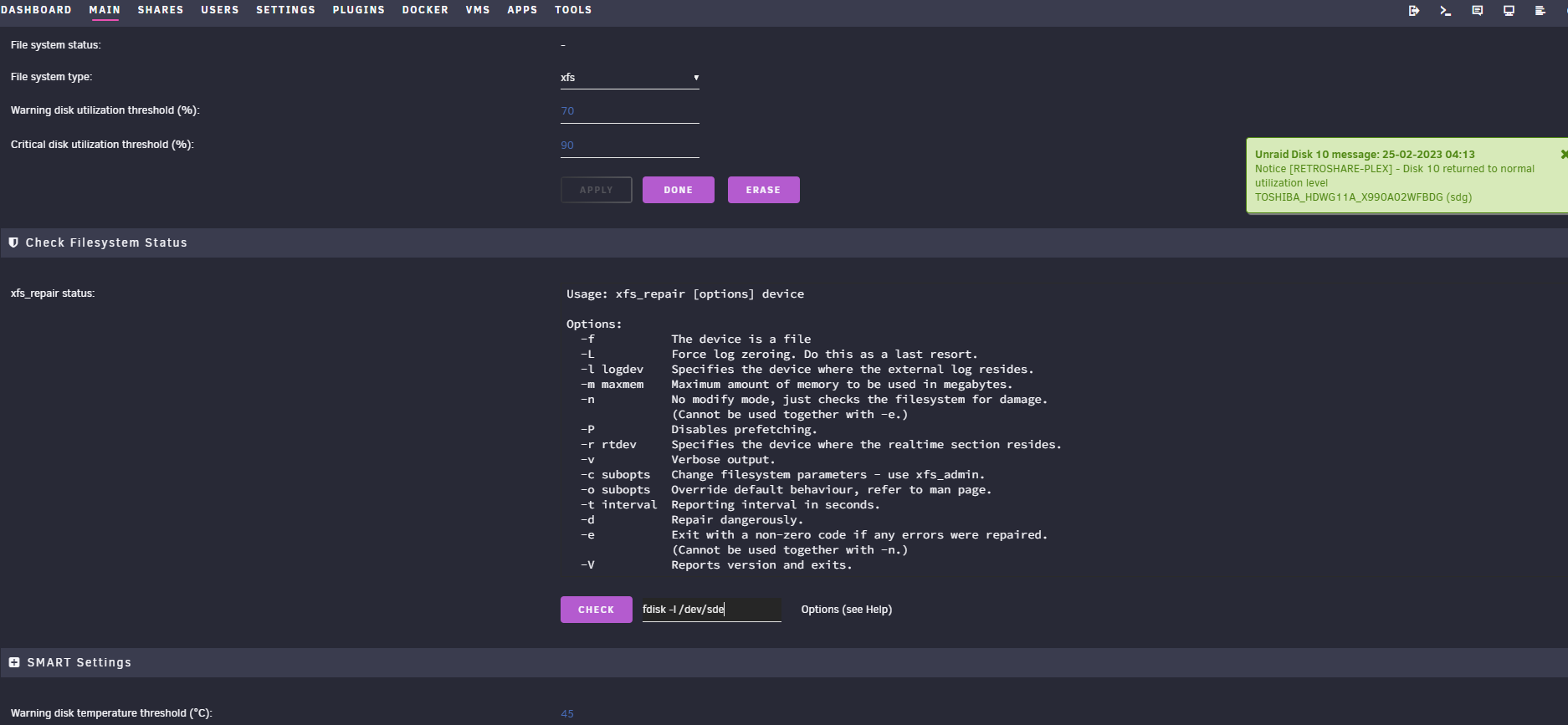

I copied and pasted it to this section but its giving me a couple of options but nothing is happening, even put the letter according to what the drive is. not sure if I am doing this right
The command is meant to be run by opening a Console session to get to the linux command line (started by the >_ icon at the top right of the GUI), not from the repair section of the GUI
