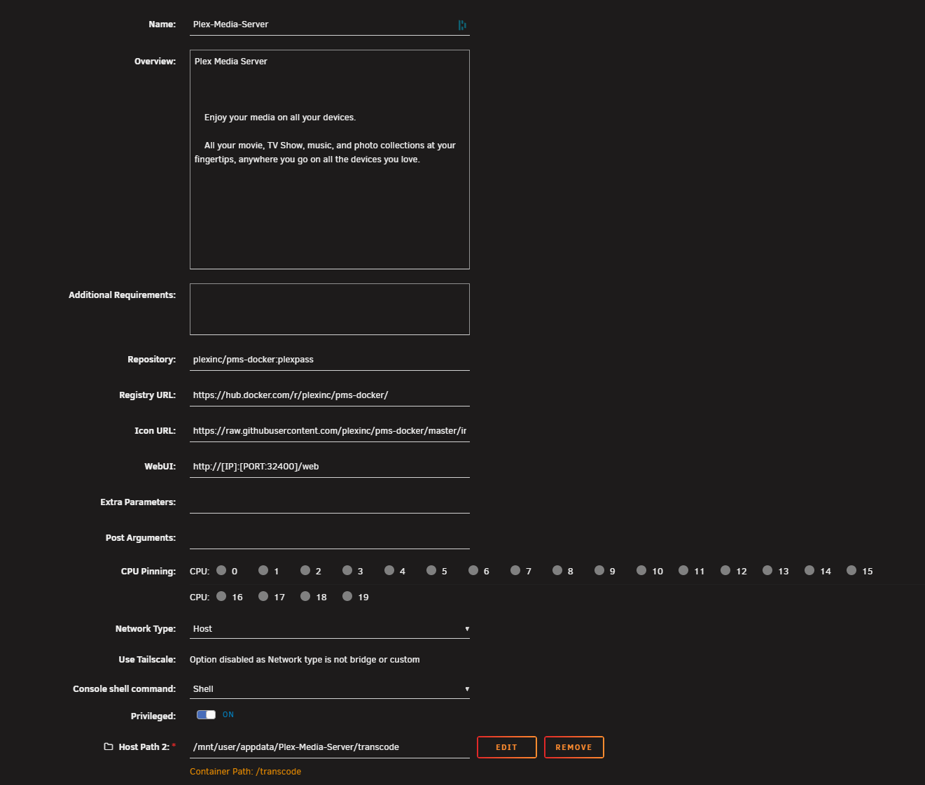

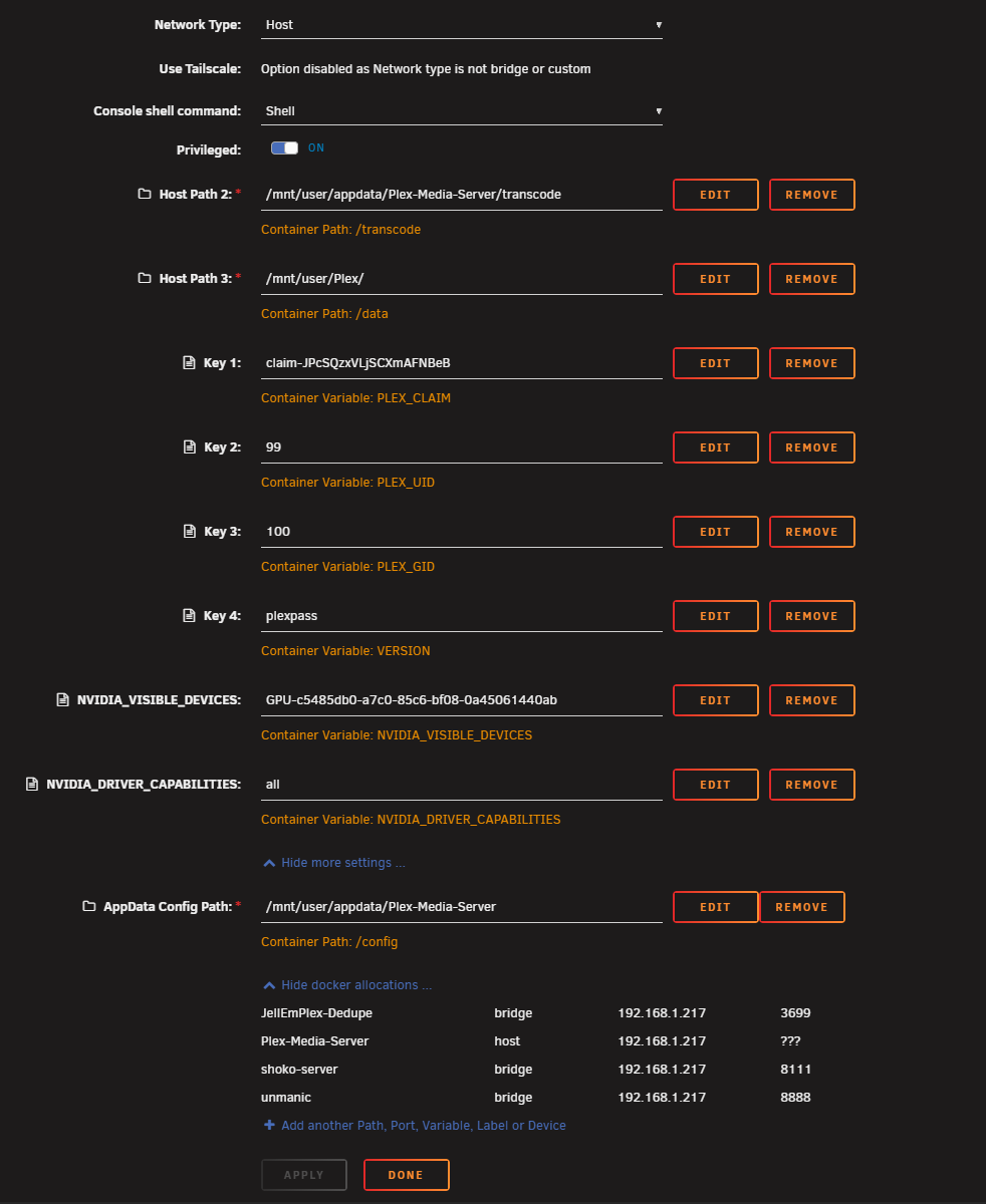

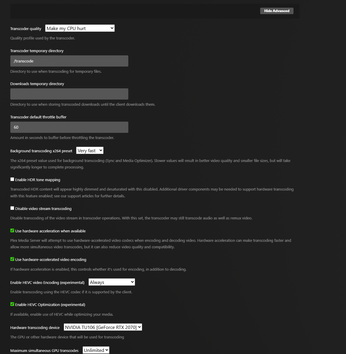

  10. OMG THIS IS THE FIX, i fixed the nvidia setup parameters and i deleted the codecs, everything is now playing no matter what format and how long thank you so much for this but any suggestions to improve my plex and server capabilities and enjoyment?

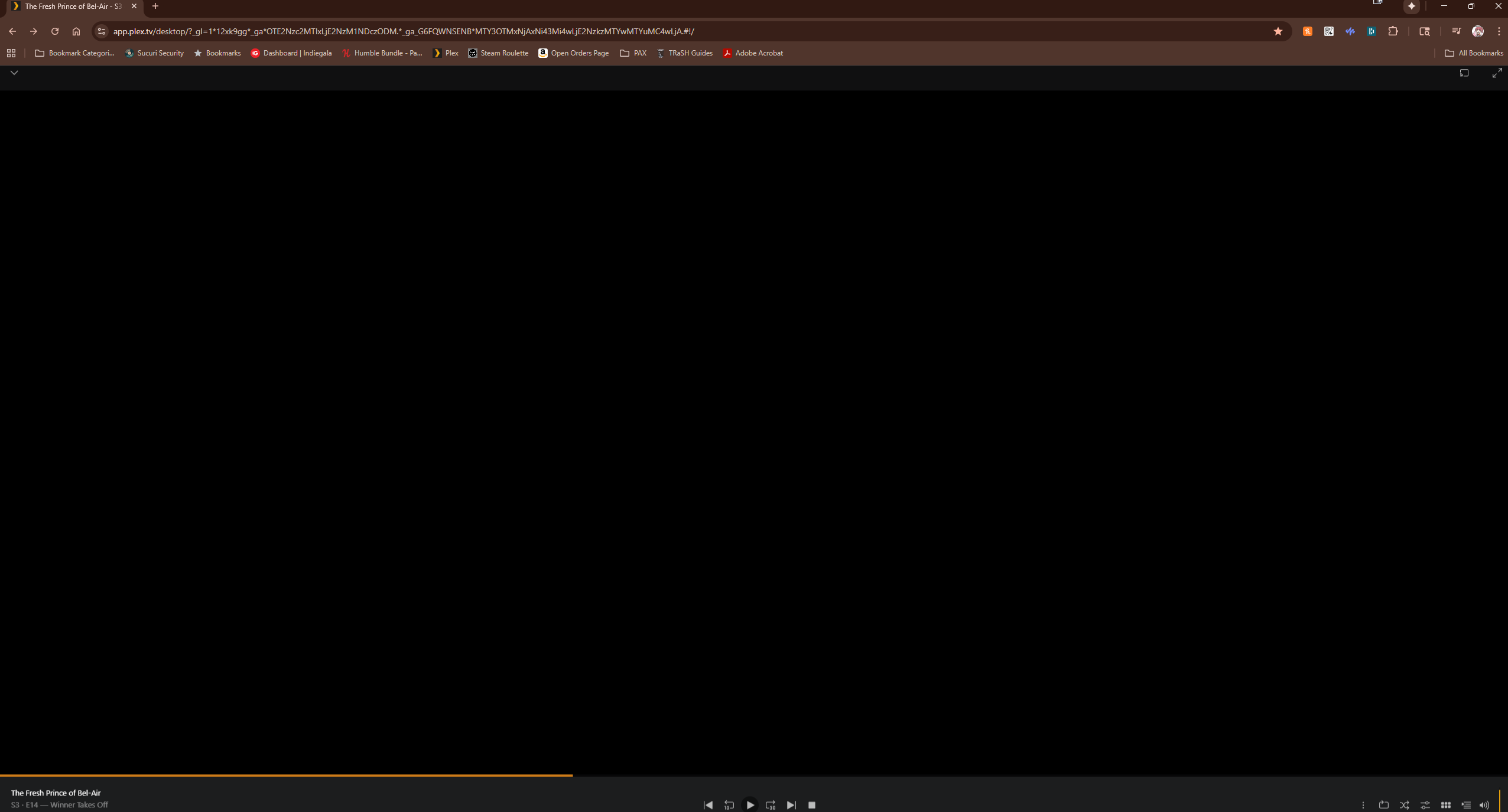

  11. restarted my server and now all videos are now all showing black.

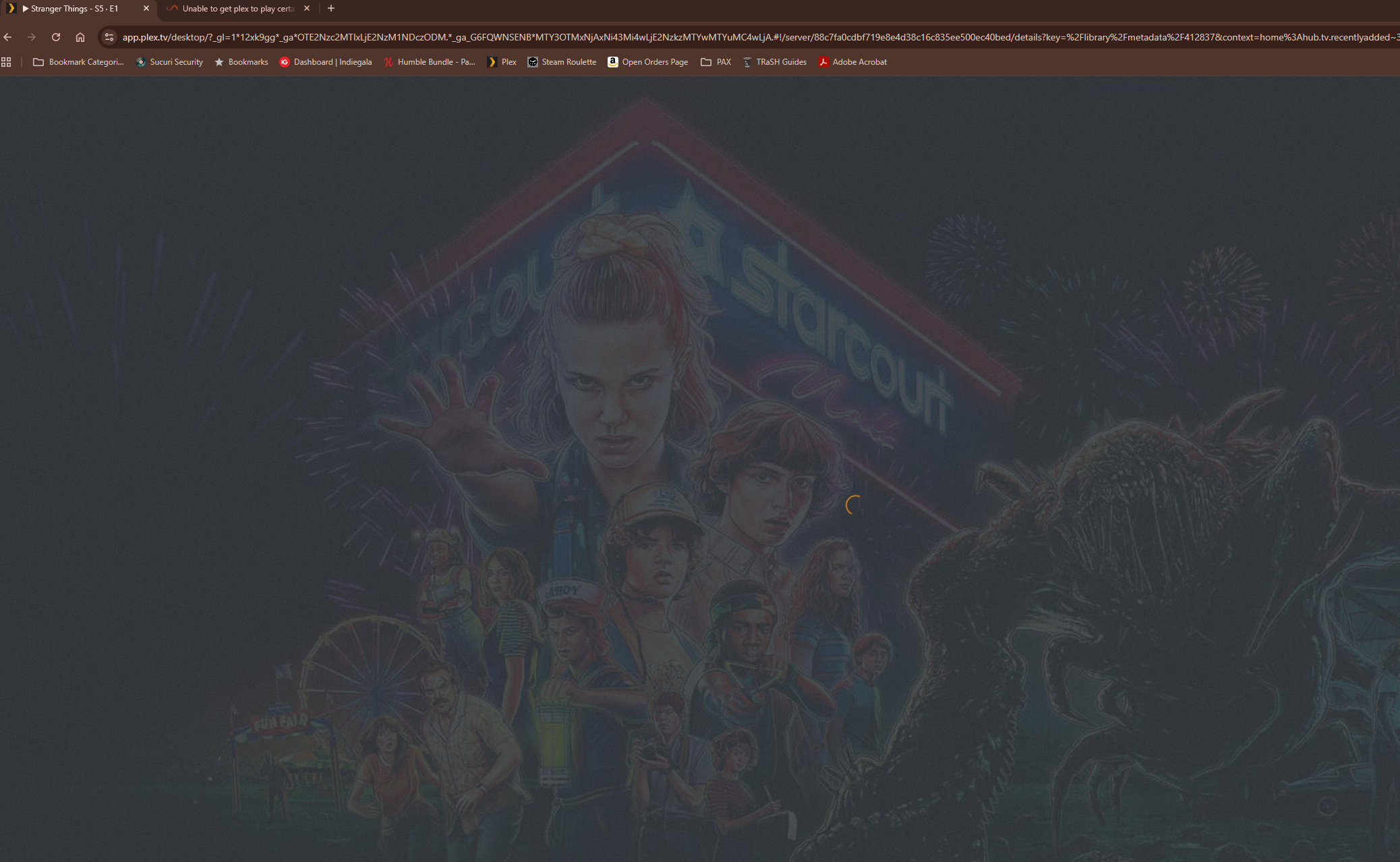

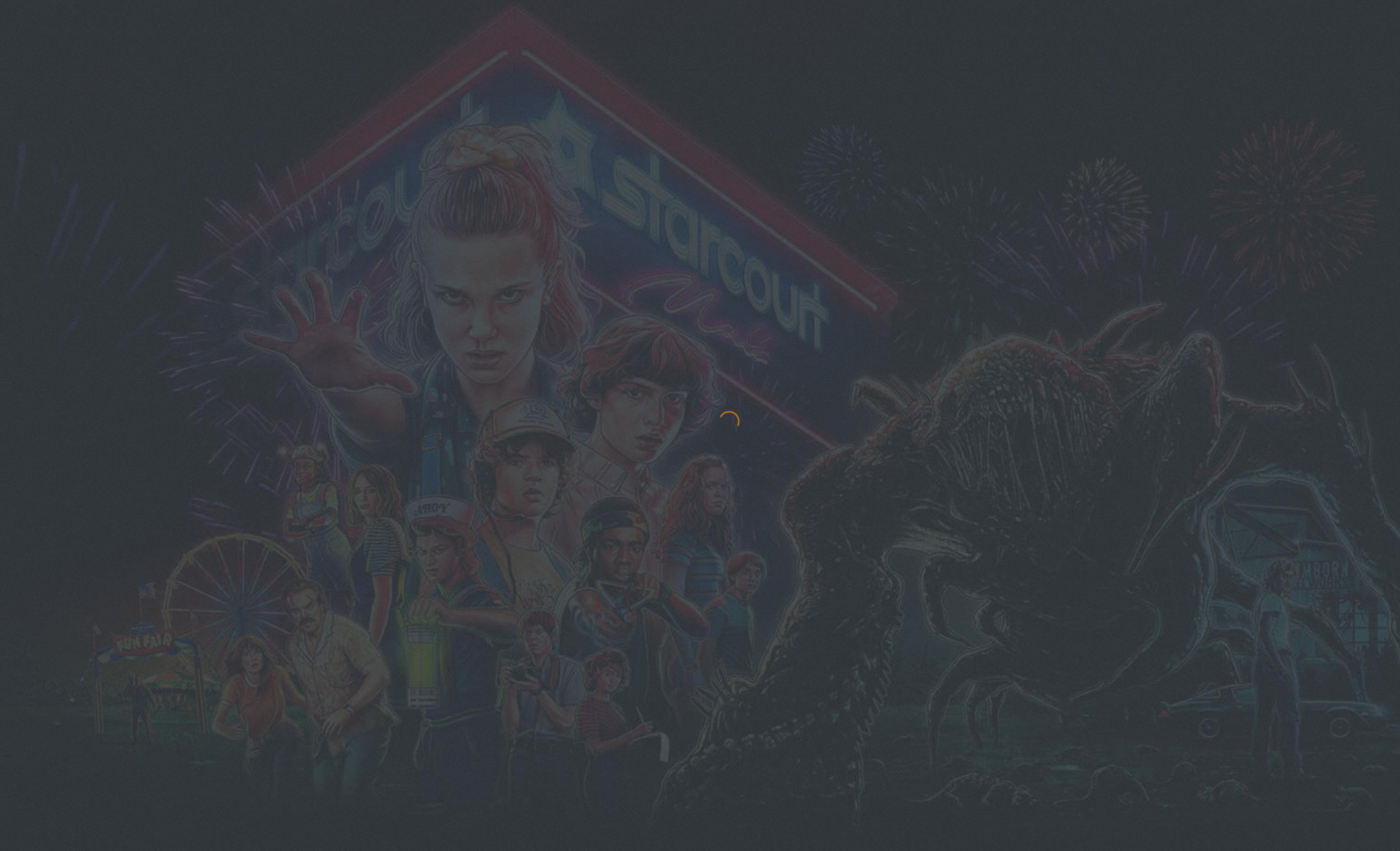

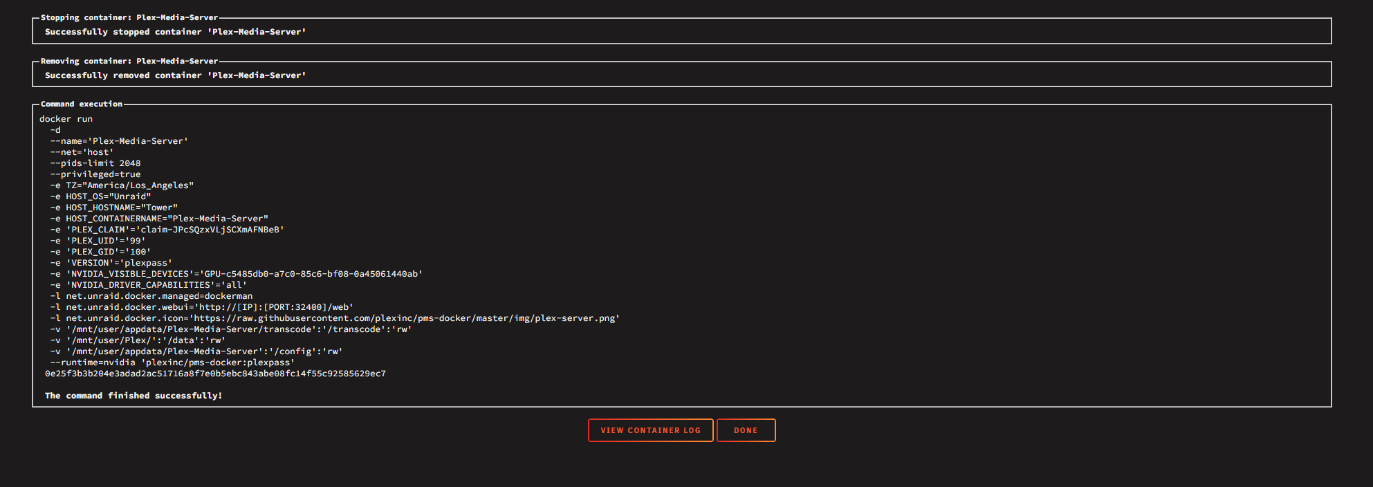

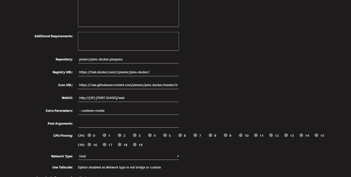

  12. I tried the runtime, it would break the docker, i also am having issues with getting unraid connect to work too, lots of things going on i don't understand, but lets stick to plex for now this is the error i get when i add the following to plex. I also do have Plex Pass forever. this time it worked after i restarted it 5 times, but here is the issue still i cannot play stranger things, video is MKV format, and in my other plex it had no issues at all playing these or allowing them to run. I appreciate the help of course, If anyone else got any ideas let me know, also if there is a file converter that is automatic and suited for plex i am open to that, if it keeps the files subtitles and everything attached.
  13. I recently built a new Unraid server with completely new parts, and for some reason Plex refuses to transcode anything. My old Unraid server had no issues playing my shows, but this new setup has better specs and components, yet it cannot play almost half of my library. I enabled transcoding in Plex, but it never actually transcodes. It always tries to direct play, even though the settings are correctly configured to allow transcoding. Because of this, many of my shows either fail to start or go into an endless loading loop. If anyone can help me figure this out, I would really appreciate it. I have been trying to watch several shows and the server just will not work properly. I also had to reset my folder properties cause i was having issues accessing certain things, i think i fixed most of it but i am quite unsure.tower-diagnostics-20251128-0140.zip Plex Media Server Logs_2025-11-27_22-40-07.zip
