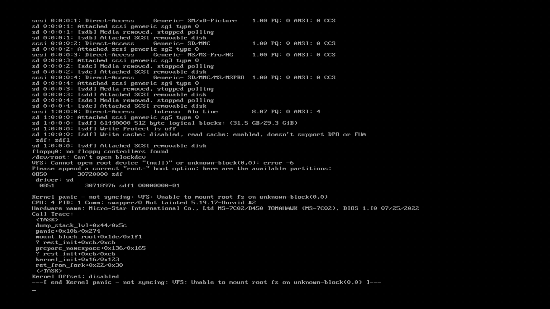

I used the free trial and didnt realize that it was about to run out when i restarted my server to activate the nvidia drivers for jellyfin.
Now the server wont boot and i can't activate the license.
Is there anything i can do?
Does it get to the boot menu? Do you have an attached monitor and keyboard? Do you have a current backup of flash?
When i start the server, it shows the normal unraid boot screen (like the boot unraid os, boot unraid gui etc), i just let that run through to boot unraid normally and then this happens. When i checked the usb drive on windows it showed up without errors, but i also have a complete backup of the usb drive.

Recreate the flash drive like you did originally, copy the config folder back to the flash from your backup, and see if it boots.
that did kinda work. Atleast it boots now, but i cant connect to my webpanel
