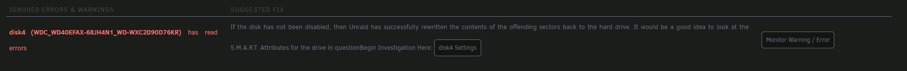

I have been getting some disk errors recently and I am in need of some opinion on if this is a failing disk or something else.
The error in question is "disk4 (WDC_WD40EFAX-68JH4N1_WD-WXC2D90D76KR) has read errors"
I have checked the S.M.A.R.T. log and I see the error being reported, but it says it has passed the overall-health self-assessment test.
Both a screenshot of the error and the S.M.A.R.T. report are posted.
Do I need to replace this drive or is it a simple fix?

SMART is showing some issues, run an extended SMART test on that disk.

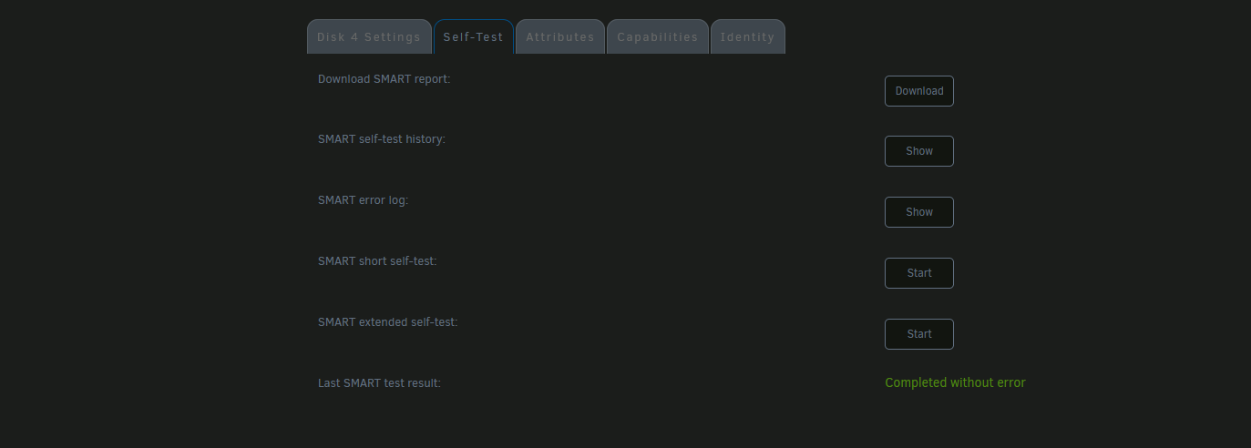

SMART extended self-test completed without error

Disk is OK for now, keep monitoring.
