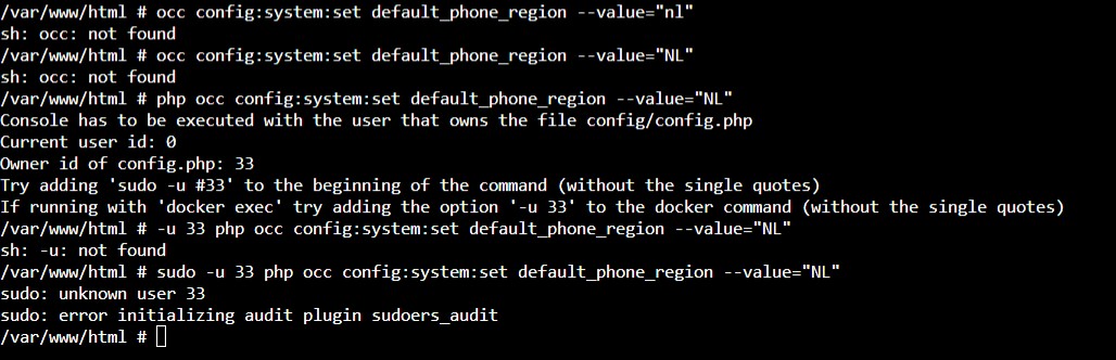

I have tried the shell command directly in the container where nextcloud is, but i get the following errors...
Not sure what the exact commando should be...
within the shell do an ls -al and see, what user is needed (-u needs a NAME, not a number)
like

so here it would be "www".
then do
sudo -u NAME php occ...
This should work
(I dont run this docker, I cannot look it up)

Thanks for your help, going to try that command....
Got it!! 🥳
So the right command should be:
sudo docker exec --user www-data -it nextcloud-aio-nextcloud php occ config:system:set default_phone_region --value="NL"
For anyone else in the future....
I did run this command through the Unraid terminal directly, not through the docker container console (shell) of Nextcloud.
Thanks for your help MAM59 👍
