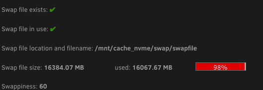

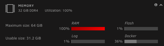

It keeps happening, so it is not a one time thing unfortunately.  Th error message is coming minutes after startup, I would not think ram would be getting unduly fragmented so soon after boot.  Not sure what you mean by limiting more ram.  I am not currently running any VMs, just dockers.  The dashboard shows I am only using 10% of 32 gigs of ram.  I am about to install the swapfile plugin and will see how that does.

It's very strange if it's happening immediately after boot, and with so much free RAM, but see if swap helps.
Tried swap, it got filled up as well.  Looking at the different diagnostics syslogs I have taken each time, avahi-daemon is what is triggering the out of memory error each time and is then killed.  It appears to be for Apple Bonjour services, I use macs, but I do not know if this is needed, or what could be done to fix.
