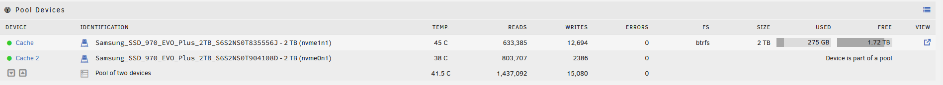

After running btrfs dev stats /mnt/cache it looked like it had a bunch of errors so I ended up remotely shutting down by Unraid system. When I got home I restarted the system and it mounted by /mnt/cache drive in read-only mode, it is currently using 275GB with 1.72TB free according to Unraid dashboard.

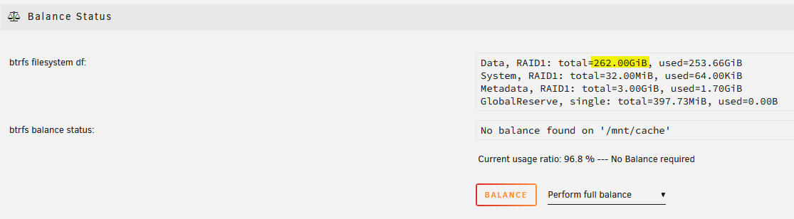

I think what happened is when it had different NVME drives the it copied over the old partion or raid, and now that I've passed the size of the original 256GB nvme, it is failing to write. If I open up my cache pool I can see the btrfs filesystem df which indicates that the total size is not the full 2TB but rather ~262GB and by usage ratio is 96.8%.
Now that I have my 2TB NVMEs how do I fix it so that it uses the full 2TB? The drive has been mounted as read-only so I can't execute the mover to move files off this drive and do a normal swap.

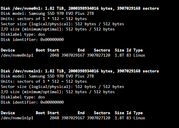

That total is the currently allocated btrfs size, not the partition size, Unraid should always uses the full partition, you can check with
fdisk -l
fdisk -l
Thank you! I've attached my fdisk -l result, I do have it as the full partion size, how do I increase the currently allocated btrfs size in UnraidOS so that it can fully use the whole drive?

Like mentioned nothing you need to do, btrfs first allocates 1GiB chunks, then any data goes there, same for metadata, chunks are allocated as needed (also removed em fully empty).

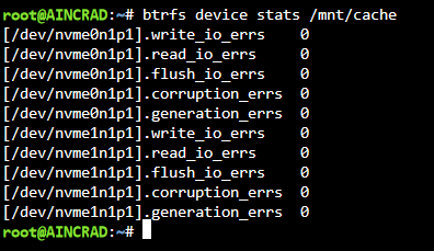

run the following to check your filesystem as a start
btrfs device stats /mnt/cache
also try running a scrub to see if you have any checksum errors
if I had backup, I would re-do the cache than fighting this, unless the value add is purely for learning

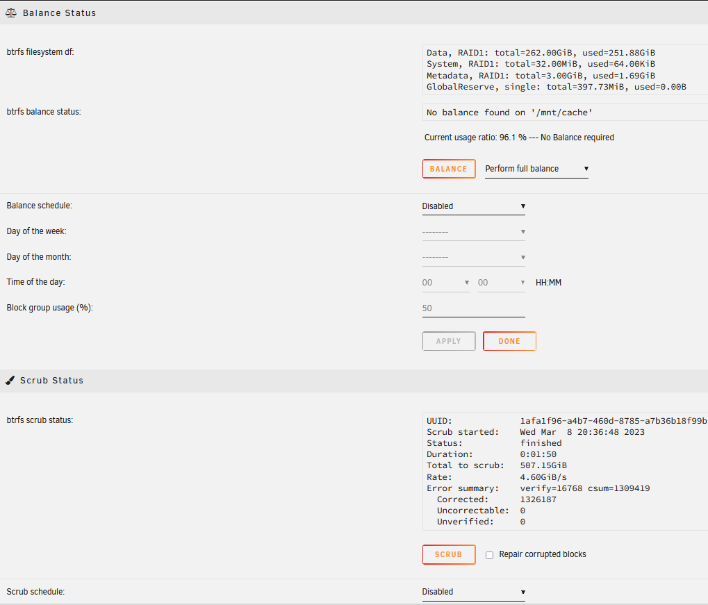

Got it, thank you for the input! After I restarted by system and it got mounted as read-only, I stopped the array and mounted just the cache. I was then able to delete the syslog file and then I ran the btrfs scrub which fixed a bunch of errors (thankfully no uncorrectable errors) and then I did a "btrfs device stats -z /mnt/cache" to zero out the numbers. Since then it has been running smoothly with no issues (last few days). Re-do the cache as in change all my shares to the array, and then re-format both of my cache drives in my pool?
Thank you for clarifying on how it allocates chunks. I didn't realize that it dynamically adds and removes as needed. Since it was rather class to the size of my old hard drives (around 256GB) I thought it was something related to that rather than a file system corruption. I followed

EDIT: Upon checking my pool I see that the balance and scrub is disabled, should I enable them on some sort of schedule?
Good idea to do a scheduled scrub. I do once a month, separate time from my parity check)
Balance, you may not need. Depends on your data write pattern. If your utilization stays good, no need to rewrite everything (which is what balance does)
