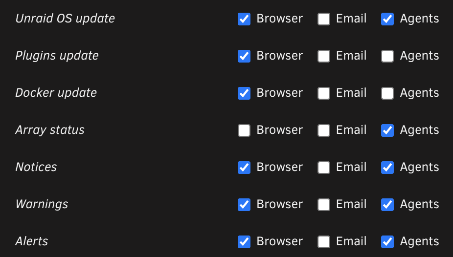

Now check the Settings    >>>    Notifications  that you have all the boxes checked for agent notifications.  If it is look in the syslog for an event where you did get notification for them and select a string to search the syslog for.   Another thing to try to to activate the e-mail notification for a while.
You can search for apcupsd  and find if you have had a 'Power failure'  and what action that apcupsd performed in the case of that event.   I had only one event of a 'Power failure' and power restoration occurred within five seconds so the UPS did not initiate shutdown.  (My time-on-battery is 30 seconds.)  As far as I can tell, there was no notification send out (or even an attempt to).

Attached is a screenshot of my current configuration. I get notices for other things just fine--just not the UPS alerts.
