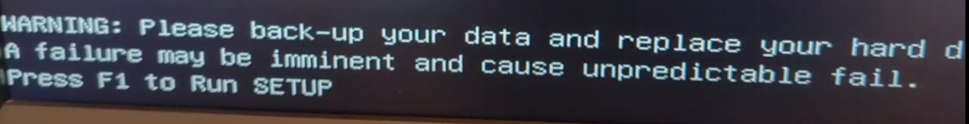

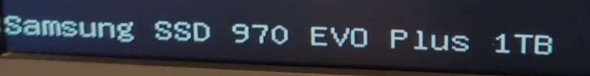

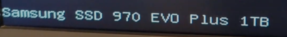

My only remaining problem is that for some reason when I reboot I have to go to manually go to my system's BIOS and choose the UEFI Flash drive to boot unraid.  I'd like to put it back in my rack and get back to having it auto-boot into headless mode after power outage or OS upgrade without needing to connect a screen.  It's my only bootable volume and is at the top of the BIOS' priority list.  After the normal Asus boot screen, it switches to an American Megatrends (also BIOS? or maybe for my HBA?) screen that seems to report an error about one of my "Samsung SSD 970 EVO Plus 1TB" M.2 NVME drives since it then shows an error (see video and/or screen shots below) that says "Warning Please back up your data and replace your hard drive. A failure may be imminent and cause unpredictable fail. Press F1 to run SETUP".  I have two of these drives. I use one for all of my docker data and the other is just sitting there unassigned.  I had planned to mirror it in a pool with it's identical sister for redundancy and haven't gotten to it (and was thinking of waiting for zfs).  But now i wonder if the BIOS is somehow seeing it as a problem drive and forcing me to "Press F1 to run SETUP" thereby blocking the ability to autoboot into headless unraid.  Anyway I guess my next step is to mirror the two M.2 drives to remove the unformatted/unassigned one from the equation.  I know Unraid doesn't write the bios but any thoughts welcome!
Possibly one of the devices is failing SMART, there's usually a BIOS option for that, to disable SMART monitoring, you can also post the diagnostics to confirm.
Thank you.  I disabled a BIOS option called "wait for F1 if error" and it now boots into headless.
