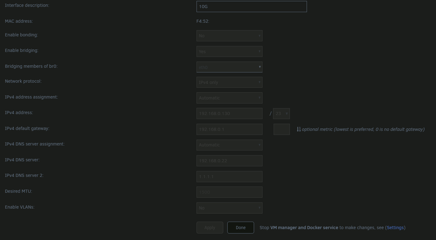

It's all through DHCP.
Then the problem is with your router / other system / piHole.
Your system isn't going to use anything other than the gateway for its DNS Server
Like I wrote in the initial post, my Pihole is down and all my other devices are currently using 1.1.1.1 without issues. Only my Unraid is not using the secondary DNS server for some reason.
Virtual machines are using DNS 2 and docker containers are still running fine so I assume they are also doing so. It's just the host struggling. ☹️

Your screenshot shows that "IPV4 DNS Server assignment" is set to automatic. I would disable that and just set the specific DNS server you want. Or do it at the DHCP level and set it to just the working DHCP server for your whole network.
I ended up changing the IP address of the backup Pihole to the primary for now until I get my second server up and running. Still odd that Unraid doesn't apply both DNS servers to the configuration file from DHCP.
