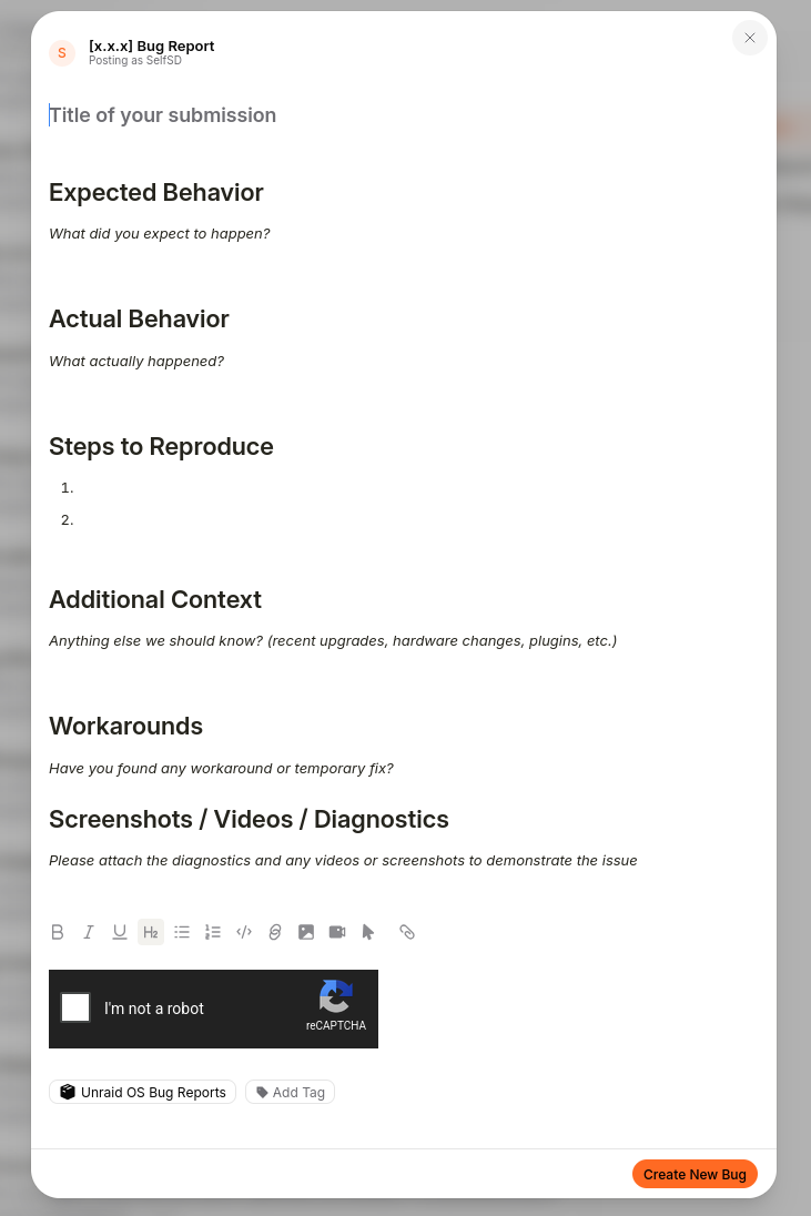

  1. Strange... I don't see those field at all. I have now tried it on Firefox, Chrome and a fresh install of Chromium and it doesn't show up on any browser. Happens on 2 PCs as well as my phone which I tested on my local network and mobile internet đŸ˜ĩ‍đŸ’Ģ
  2. Attached submission form of what I see on my end.
  3. Hi! I'm trying to post a 7.3.0 bug report on the bug report forum but it gives me an error "Unraid Version field is mandatory". I've tried to add the Unraid version in the title with no luck. I've also selected the Unraid version in the tags with no luck. Where is the version field supposed to be at?
