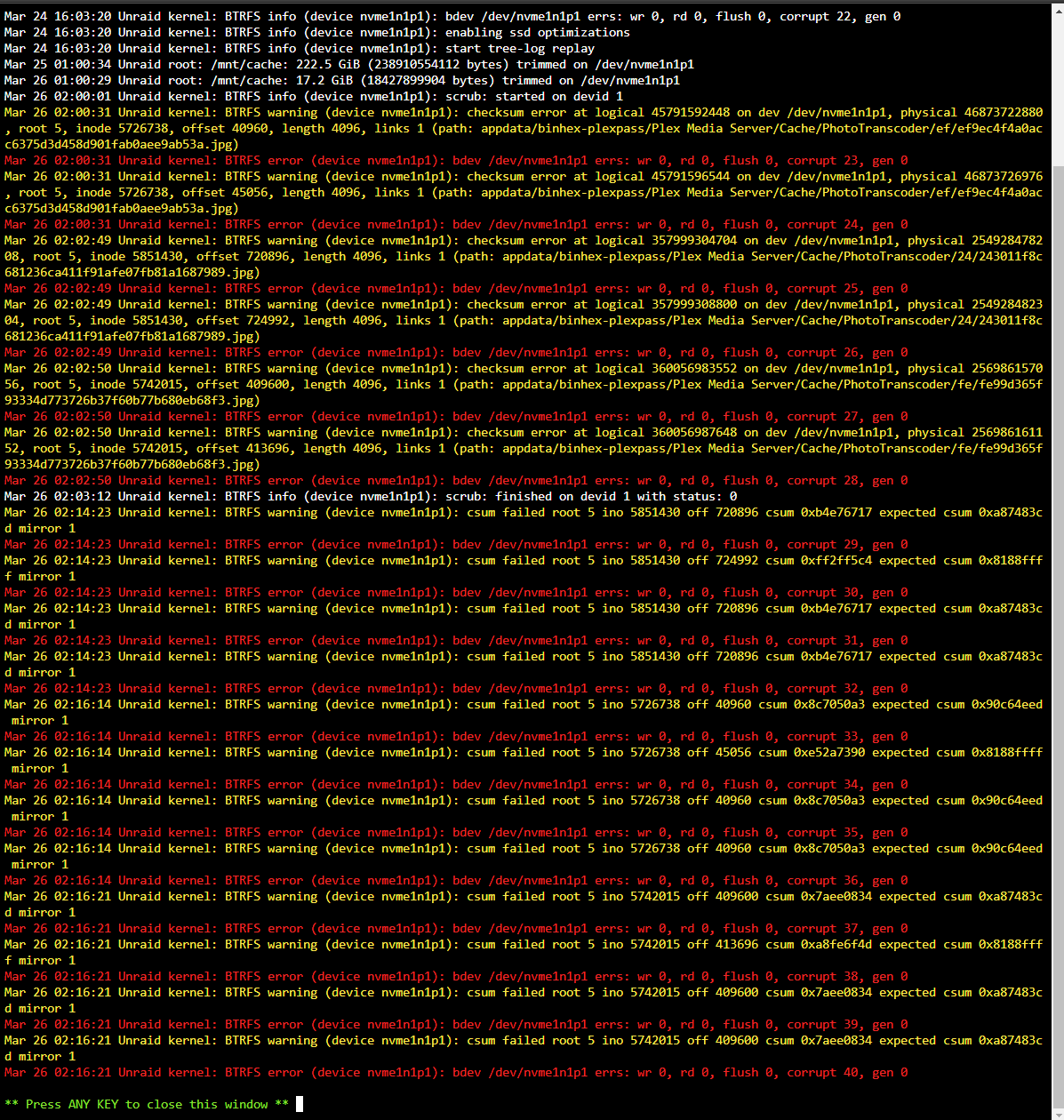

Mar 21 18:59:48 Unraid kernel: BTRFS error (device nvme1n1p1): block=196110008320 write time tree block corruption detected
This is usually caused by bad RAM or other kernel memory corruption, and Ryzen with overclocked RAM like you have is known to corrupt data, so start here.

image.thumb.png.bd2656ad62a4dc260b71590768299b1b.pngunraid-diagnostics-20230326-1409.zip
Was the pool clear after the change, i.e., did you run a scrub without errors?
There are 6 uncorrectable errors
First you must delete/restore those files from a backup, scrub must return 0 errors, only after that can you retest to see if the problem is solved or not.

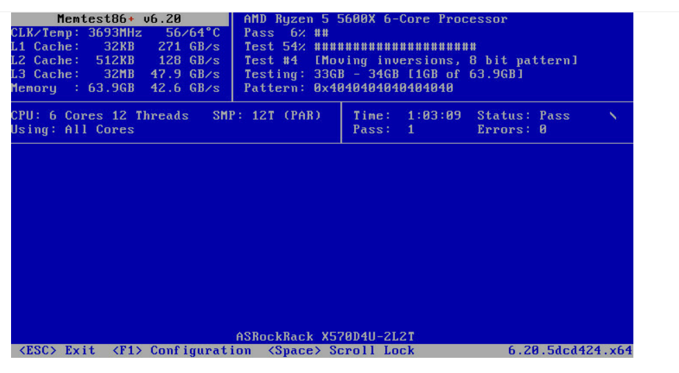

I have now run it twice without any results. The first run took over 14 hours. On the second run I reset all BIOS values beforehand without any errors.

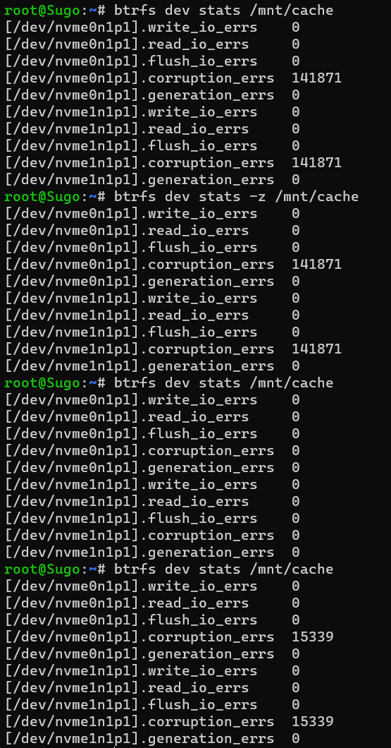

Memtest is only definitive if it finds errors, reset the btrfs stats and run a correcting scrub, then post he output.
@Jorge
Last Stats after scrub

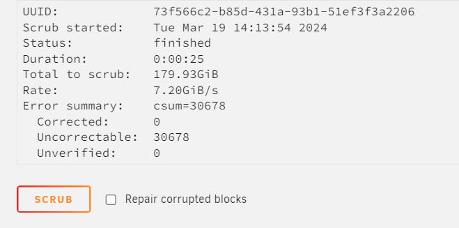

To get rid of the errors you'd need to delete the corrupt files, they will be listed in the syslog after the scrub, but note that if there are still RAM issues, it may be finding false positives, and you would possibly be deleting good files.
@Jorge
I have now deleted some data but unfortunately the next scrub will show new files as corrupt? The docker file is also affected, how can I restore it or have it recreated?
