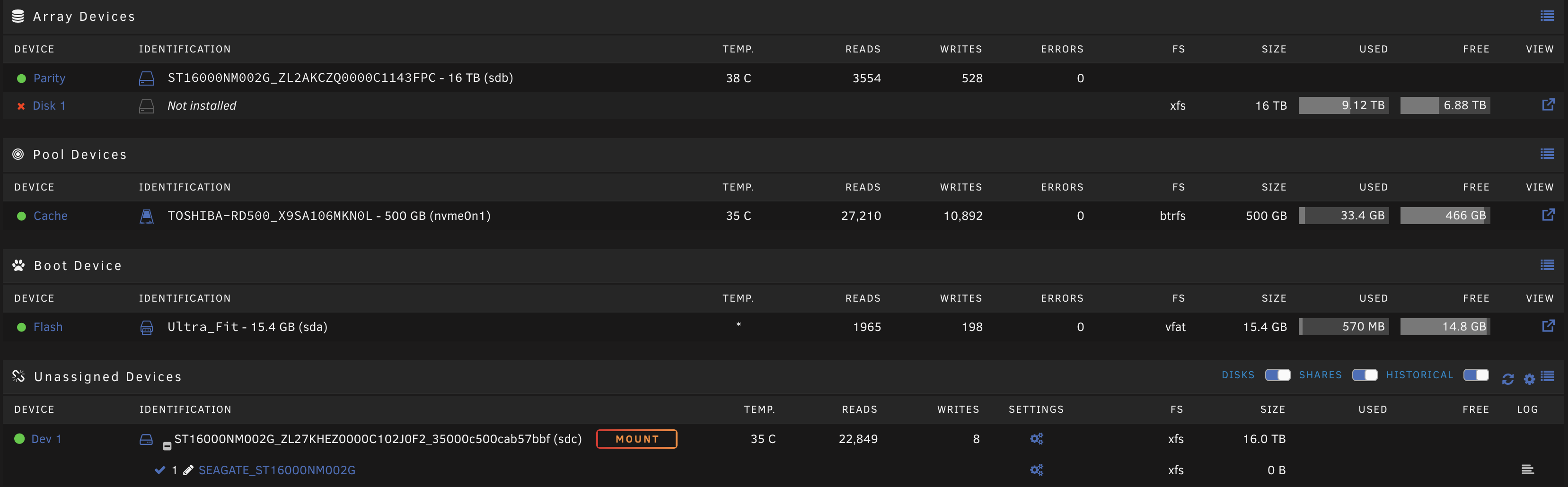

Hey, so after unassigning the Hard drive and installing the UD preclear plug-in, I can't see the HDD show up when I go to launch pre-clear, any idea why? The array has been started without the data drive assigned...
Post a screenshot the main page.
Ahh, I believe you need to wipe the partition first, you can do that with the UD plugin.
How would I do that? I haven’t been able to find any reference to this in Unraid.
In the UD settings enable destructive mode, you will then see a red x next to the disk to wipe it.
Yes I saw it now, I am wiping the disk now, looks like it's going to be way a very long time...
