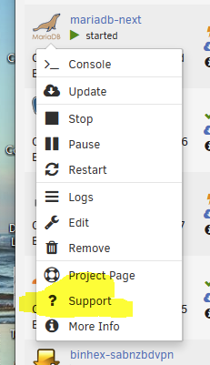

I'm not much of a database guy.  Probably a good place to start looking for answers would be in the support thread for the docker container you are using.  On the Docker tab, click the docker's icon and the Support.

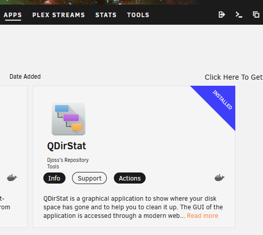

I've always found QDirStat to be one of my best go-to utilities.
It's available in CA.
Ok. Since I have mover going I have docker disabled but I will install it after.
