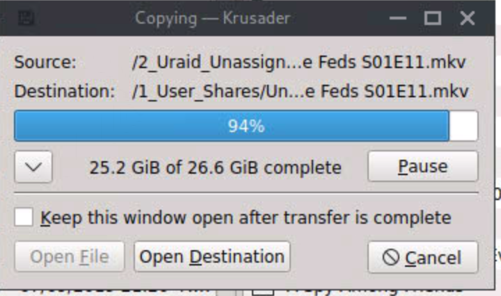

Yep still very slow.  Any help with Samba as mentioned above would be greatly appreciated.
Has been stuck like this for just about 10 Minutes
There' nothing out of the ordinary logged and no disk activity, try copying with midnight commander instead (mc on the console), also note that you are using SMR disks, and this model especially is known to sometimes be extra slow.
