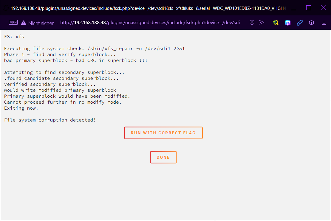

I checked, but they were formatted before the second rebuilding try.. there is nothing
If you formatted the disks that data is gone, you can then just re-sync parity.
Just now, GK-ken said:
This is what it says
That is not the emulated disk, but if the disks were formatted they will be empty.
