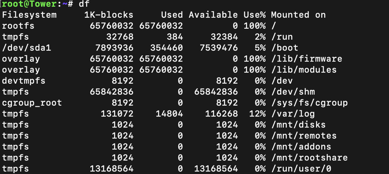

Hi all, my unraid server went offline today and I couldn't get the array restarted. I also was unable to run the diagnostics via the webgui but did manage to gather some info before rebooting.

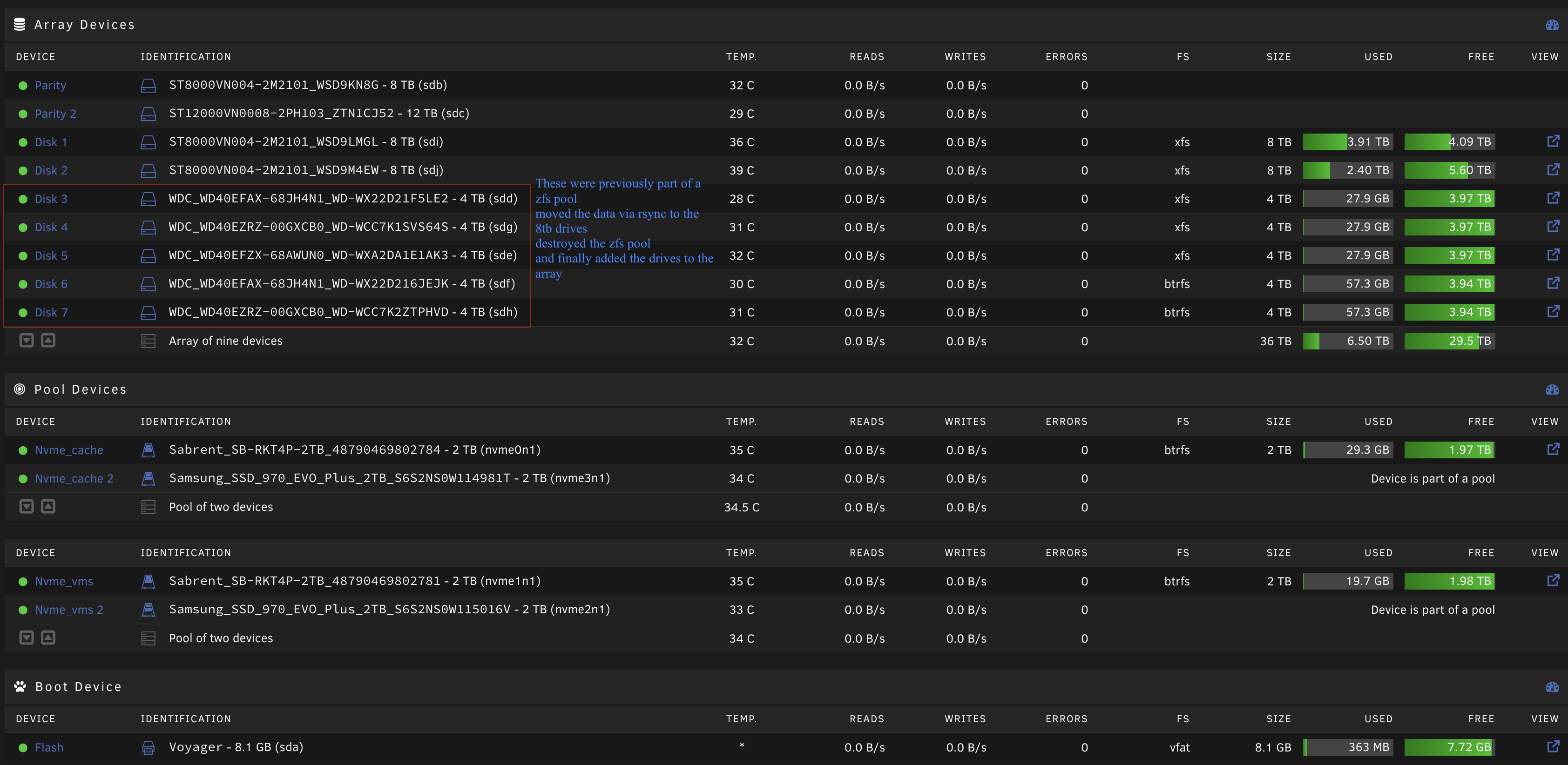

The build is fairly new ~ 2weeks and I haven't had a problem till today. I moved the drives over from a Truenas ZFS pool and rysnc'd the data to to the pool and then destroyed the zfs pool and added the drives to the unraid pool.  Only mentioning this for context but i don't think this process of zfs --> array should have anything to do with array going offline but wanted to confirm!!

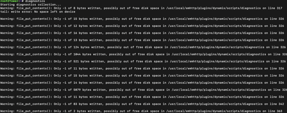

Short excerpt from the diagnostics...
Starting diagnostics collection...
Warning: file_put_contents(): Only -1 of 8 bytes written, possibly out of free disk space in /usr/local/emhttp/plugins/dynamix/scripts/diagnostics on line 317
tail: write error: No space left on device
Warning: file_put_contents(): Only -1 of 15 bytes written, possibly out of free disk space in /usr/local/emhttp/plugins/dynamix/scripts/diagnostics on line 326
Warning: file_put_contents(): Only -1 of 12 bytes written, possibly out of free disk space in /usr/local/emhttp/plugins/dynamix/scripts/diagnostics on line 326
Warning: file_put_contents(): Only -1 of 16 bytes written, possibly out of free disk space in /usr/local/emhttp/plugins/dynamix/scripts/diagnostics on line 326
Warning: file_put_contents(): Only -1 of 13 bytes written, possibly out of free disk space in /usr/local/emhttp/plugins/dynamix/scripts/diagnostics on line 326
Warning: file_put_contents(): Only -1 of 124 bytes written, possibly out of free disk space in /usr/local/emhttp/plugins/dynamix/scripts/diagnostics on line 326
Warning: file_put_contents(): Only -1 of 1044 bytes written, possibly out of free disk space in /usr/local/emhttp/plugins/dynamix/scripts/diagnostics on line 326
Warning: file_put_contents(): Only -1 of 521 bytes written, possibly out of free disk space in /usr/local/emhttp/plugins/dynamix/scripts/diagnostics on line 326
Warning: file_put_contents(): Only -1 of 11 bytes written, possibly out of free disk space in /usr/local/emhttp/plugins/dynamix/scripts/diagnostics on line 326
Warning: file_put_contents(): Only -1 of 14 bytes written, possibly out of free disk space in /usr/local/emhttp/plugins/dynamix/scripts/diagnostics on line 326
Warning: file_put_contents(): Only -1 of 5079 bytes written, possibly out of free disk space in /usr/local/emhttp/plugins/dynamix/scripts/diagnostics on line 326
Warning: file_put_contents(): Only -1 of 83 bytes written, possibly out of free disk space in /usr/local/emhttp/plugins/dynamix/scripts/diagnostics on line 342
Warning: file_put_contents(): Only -1 of 2 bytes written, possibly out of free disk space in /usr/local/emhttp/plugins/dynamix/scripts/diagnostics on line 363
Warning: file_put_contents(): Only -1 of 34 bytes written, possibly out of free disk space in /usr/local/emhttp/plugins/dynamix/scripts/diagnostics on line 365
echo: write error: No space left on device

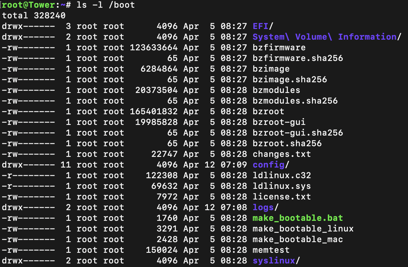

I did grab the diagnostics via ssh but alot of the files are zero in size due to the space error.  I'm going to swap out the USB boot drive for starters and looking for pointers!

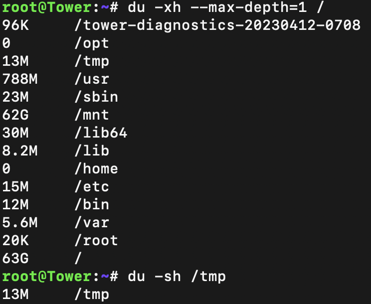

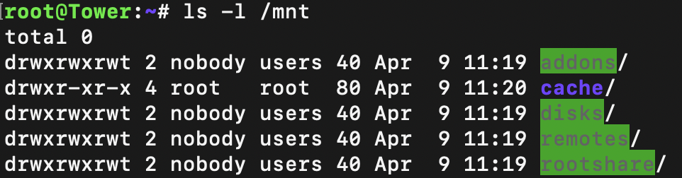

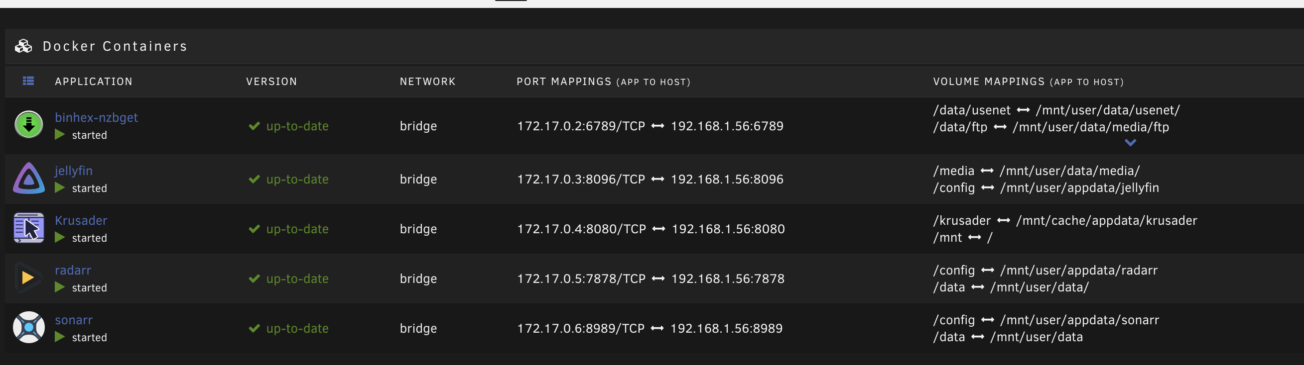

This is the problem, rootfs is full, and it usually means you have something writing to a mapping outside /mnt/user, and that goes to RAM, check all container mappings.

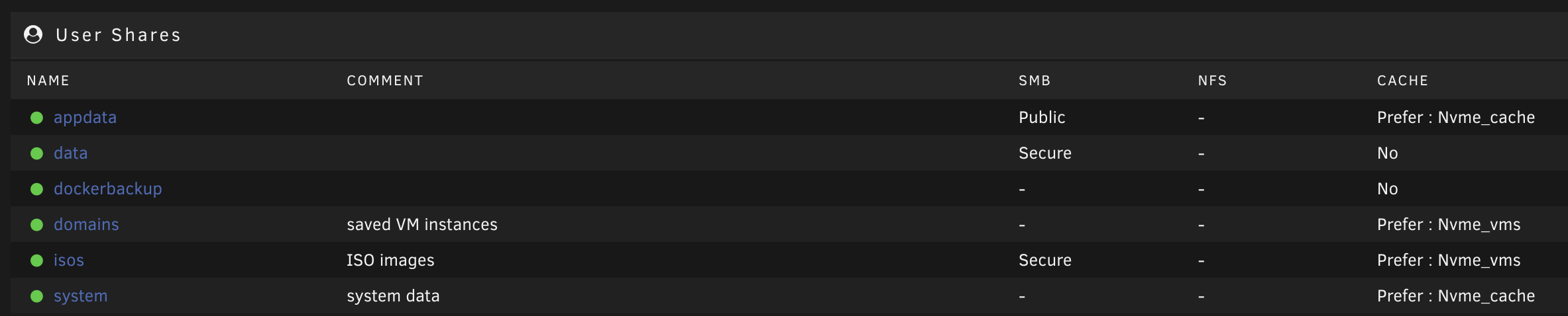

Your krusader appdata mapping goes to /mnt/cache, but you have no pool named 'cache'. Probably you renamed your pool without fixing that mapping.
Thank you both for your help! Correct I added a second drive to the cache pool and had renamed it! Thanks again!
