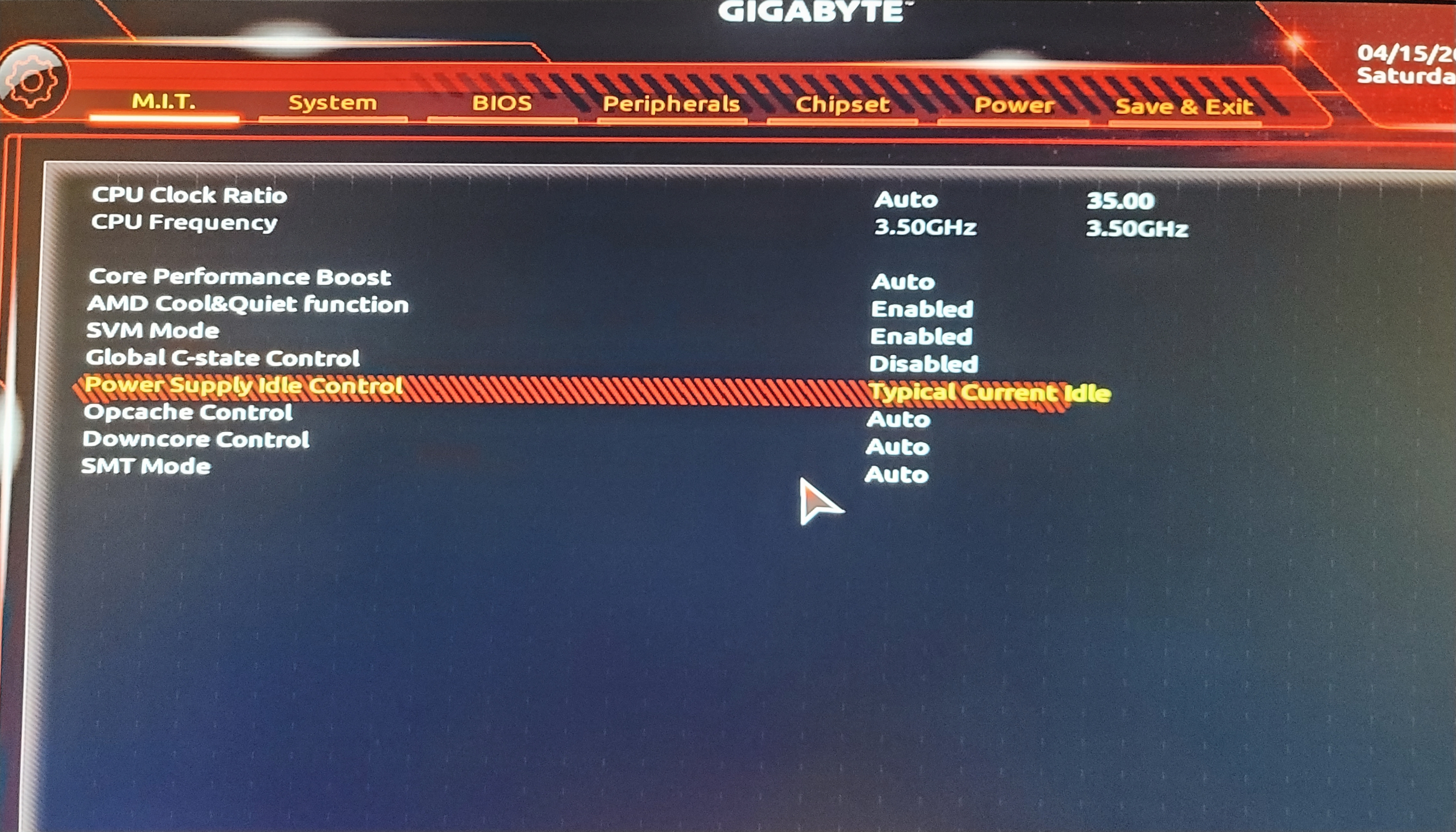

yes I've double checked those settings. I've even toggled C-State to see if it would make a difference, no luck.

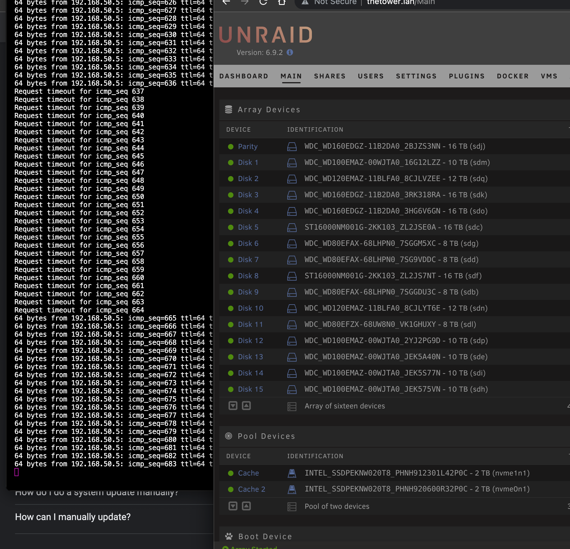

Array did start, however interestingly, I've been doing a ping test to the server every time i start the array to see if it goes down.
It seems even with 6.9.2 the interface goes offline for a moment but comes back up.
I don't know if it's related, but is it possible that my network cards or net config is what's causing the crashes --- and i didn't notice because it recovers with 6.9.2 but not the later versions?
Here's a screenshot of the ping test as the array was starting --- and i've included the latest syslog as well (weird)
syslog
Is the server still responsive on the local monitor/keyboard during that time?
@JorgeB no, with versions > than 6.9.2 when it crash, if's inaccessible even on the local terminal (frozen).
Then it's not just a network problem, but without anything in the logs difficult to guess what, maybe some incompatibility with the newer kernel.
