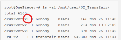

I figured that this may have been a configuration issue, so I went into the terminal, CD'd to the appropriate location, and then ls -la to check the ownership and permissions on the folders and files within /mnt/user/path/to/folder. The folders/files that were problematic were said to be "-rw-rw----+" in terms of permissions, and rather than being owned by "nobody users", was owned by "John users"
To me, this means that they are all in the "users" group from Unraid, and thus "Brad" should have "rw" access to the folders/files created, at the very least.
So, why can't "Brad" read and write to this file, and why does "John" own the files/folders they wrote, rather than the "nobody" user? How may I make it such that the files written are accessible in the manner I have configured in the GUI?
See here:
        https://www.linuxquestions.org/questions/linux-newbie-8/what-is-in-drwxrwxrwx-915243/
and
        https://forums.unraid.net/topic/116389-access-denied-printer-unraid-share/?tab=comments#comment-1059803

Recently, something has come to my attention about Unraid and SMB. There have been incidences where access to Unraid shares is restricted or blocked completely from users who should have access to it. What has been found in these cases is that a feature, has been enable on the Unraid side, called Access Control Lists (ACL for short). This will show up as an ‘+’ at the end of the Linux permissions. See the screen capture below:
Note that the ‘+’ is also on the file as well as the share/directory.   ACL changes the way that Linux is going to control access to these resources. After some research, I found out that Windows has used ACL for a long time.  The SAMBA group has added ACL into its version of SMB.  Unraid does not use ACL in its security scheme.
At the present time, I can think of only one way that a ACL could be found on any Unraid server. It was done by a Windows user who was trying to change how SMB worked by applying Windows security features to an Unraid share by changing the default Security settings. (Basically, right-clicking on the Share in Windows Explorer, selecting ‘Properties’, then the ‘Security’ tab and working from there.)
The point I am making is that you can’t fix a share access problem by trying to change a Unraid share security using Windows security tools on that share. If you try, you will probably make things worst! (Unless you are a Windows SMB Networking Guru…) It is important to realize that if you are denied permission to an Unraid share resource, the problem can only be fixed on the Unraid side using the Tools in the Unraid GUI (or via the command line for specific problems).

Thank you @Frank1940and @JorgeB for your thoughtful comments. I was already on the right path yesterday and found the source of my issue, which was actually exactly what you two had guessed.
Previously, I had set up my UnRaid server to use active directory, though I recently switched off of it due to poor implementation. To my understanding, what that would have added in are more granular ACLs, controlled by the active directory administrator, rather than by UnRaid. After I learned what the "+" meant, and how to check ACLs with getfacl, I found my solution, which you may read below.
As mentioned in my initial post, the permissions were set to "-rw-rw----+", with "+" indicating that there is an access control list for the directory. To me, this means that the "users" group could potentially have "---" permissions within this ACL, which, once I checked, there was.
Command used at terminal;
> getfacl New\ folder    <-- created "new folder" as "brad" user in windows
Summarized response from terminal;
> "group:users:---"         <-- Previous assumption that the ACL was blocking was correct
