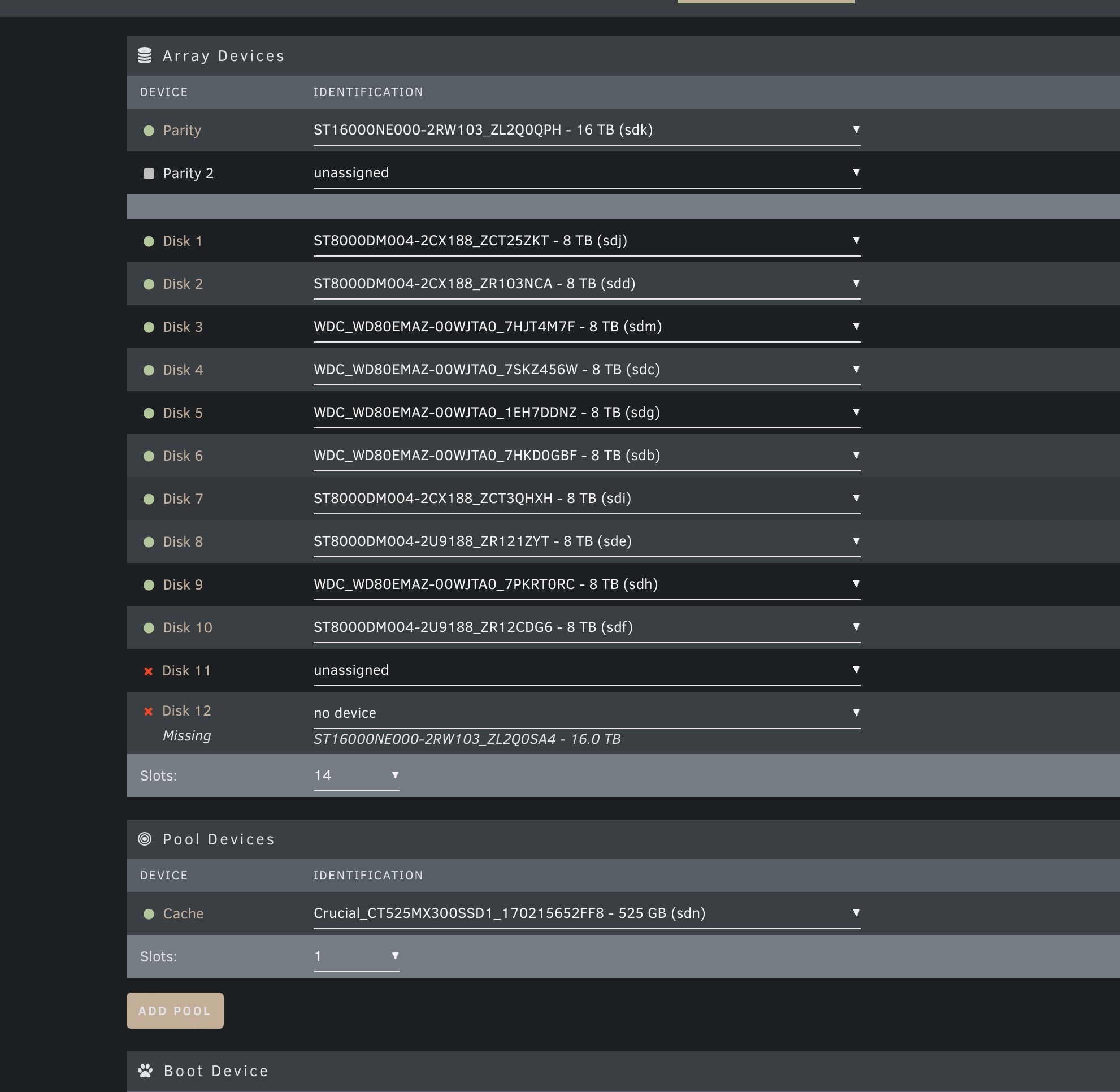

added old parity drive to array mistakenly thinking it was the same process as adding any new disk

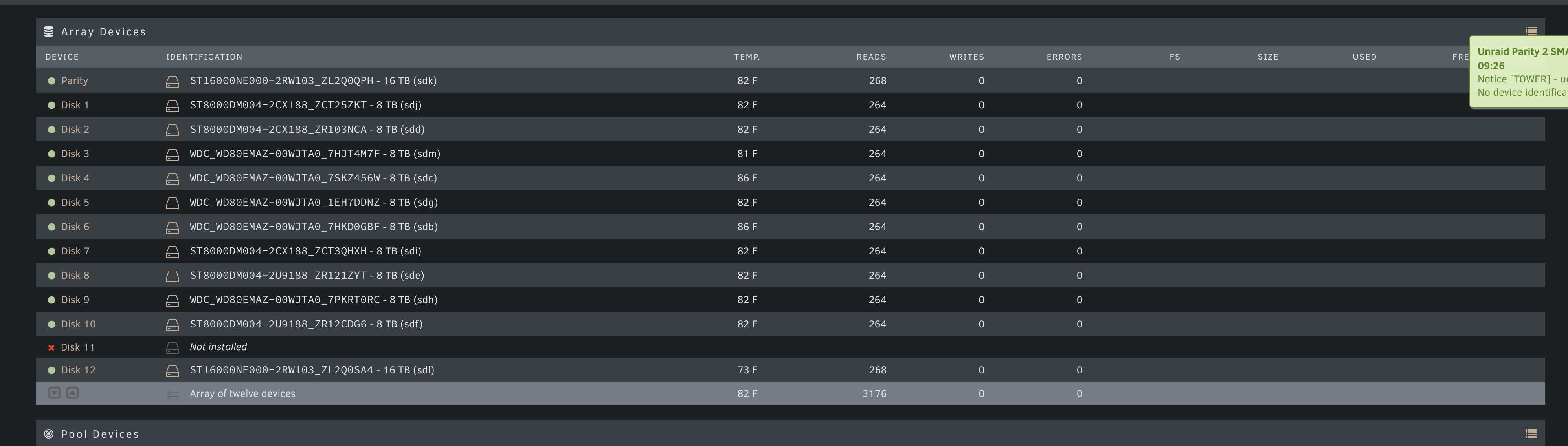

So I definitely screwed up on quite a few levels. I upgraded my parity drive from 8TB to 16TB which was fine. So I thought I could add the old parity to the array like you would for any other disk. I've since learned obviously it has no data system so it's not going to work and building into the array now means unraid expects the drive to nee there. My next mistaken was buying a new drive to replace the bay where I stupidly added the old parity drive. Obviously a mistake, unraid is looking for the old parity that was built without a data system.
To make matters worse, I added another virtual bay (there are 12 total in the machine, I added a 13th) and added the new 16TB drive there. It rebuilt the drive fine but it's clearly not being added to the array volume.
Here's a screenshot of the array in macitence mode ( I can't get into maintenance mode with the old parity drive in bay 11). I'm trying to figure out how to clear bay 11 from the parity disk it's expecting and adding the 16tb drive currently in bay 12 to bay 11 (again bay 11 is the last bay in the machine as there's 12 total bays).
I've researched "Unmountable drives" quite a bit but it always seems to be about replacing a dying disk that's unmountable.
I've attached the logs in case it gives any insight (unfortunately I've rebooted several times).
Any guidance or suggestions would be very appreciated. I'm at a total loss as to where to go from here. Thanks a lot.

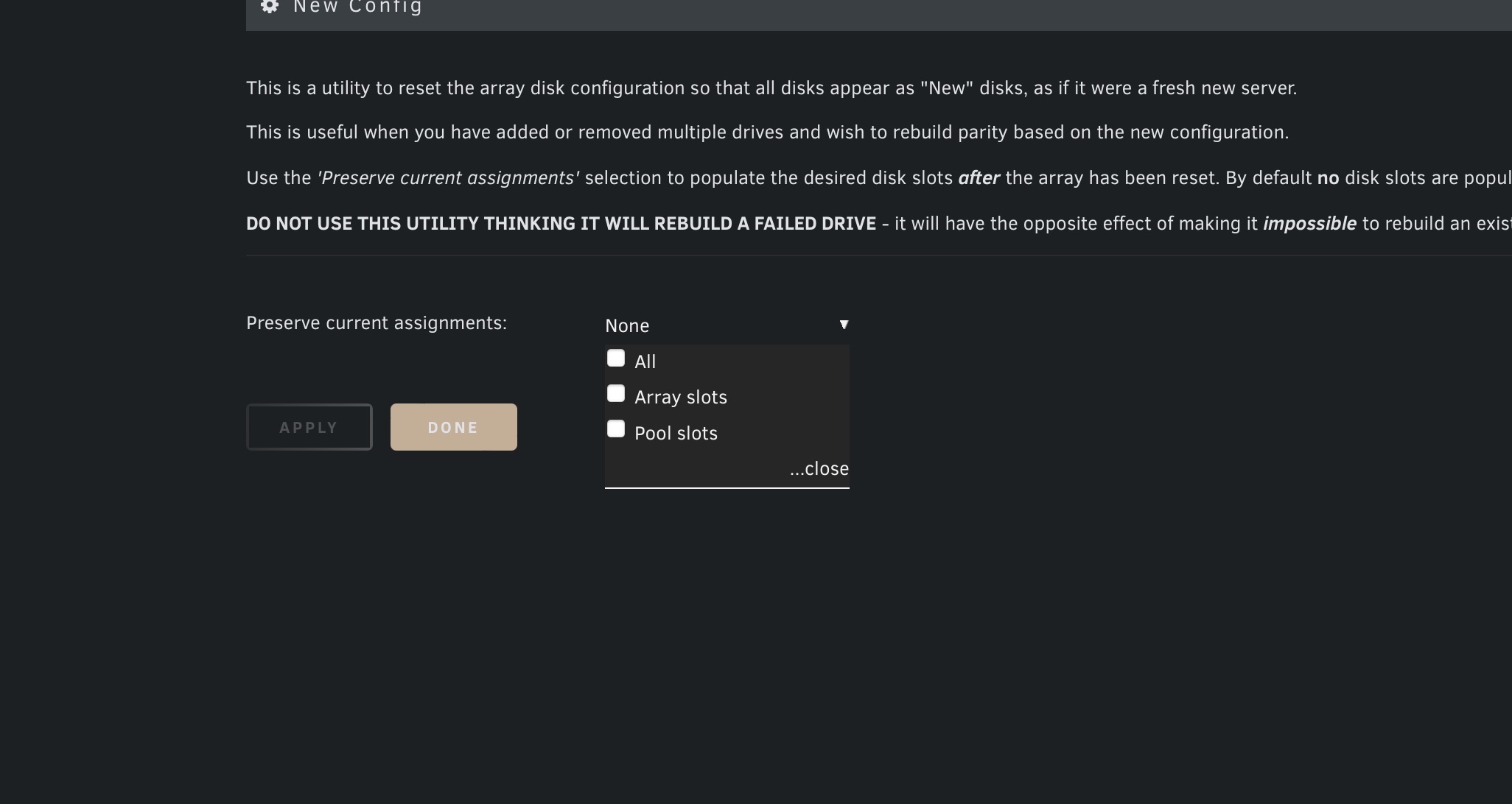

If you want to remove disk12 you need to do a new config and re-sync parity without it.
this is the part that didn't understand, is the idea to remove disk 12, and then run the new config on the array without a disk in 12? Basically dont preserve any of the array or the pool?  Thanks a lot

Preserve all, the emulated disk will disappear, you can then reassign disk12 as disk11 if you want.
thanks a lot. it's re-synching the parity (without disk 12). I'll add the 16TB to disk 11 once it's finished. Appreciate your help very much.

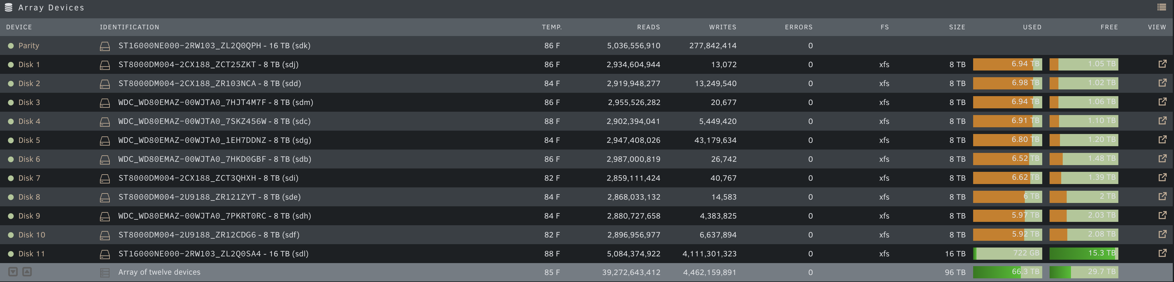

Update- you were right of course. It would've been hard for me to screw that up any more than I did. Unbelievable. Anyway after 4 days, new config rebuilt the parity (without the the unmountable disk/extra drive slot) and then formatted the old parity and added plus the new disk it to the array as intended. Thanks for jumping into help.
