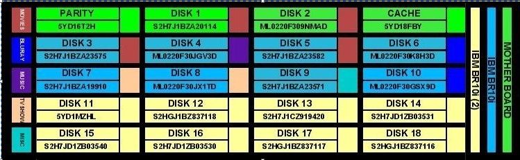

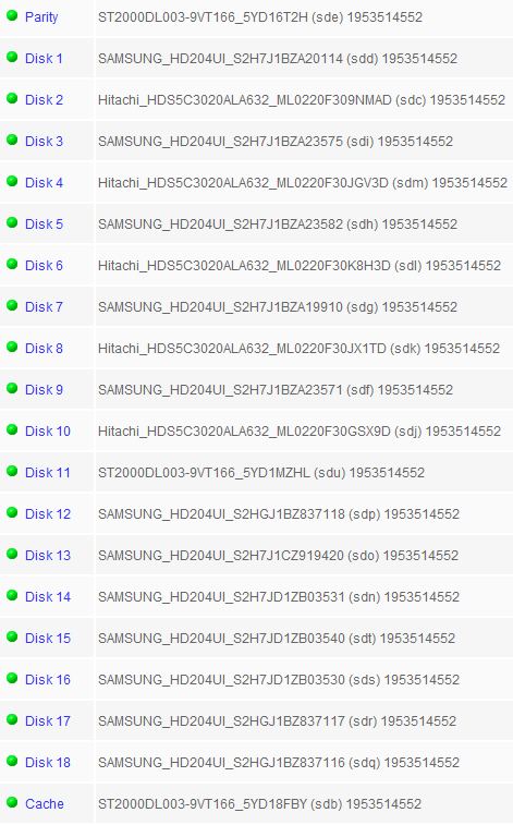

I determined my layout pretty much the same way as Johnm.
Attached is a copy of MySlots, from unMenu, for the layout of my 4220.
Also, a capture of the main web page.
Good Luck  :)

Thanks for the pictures, I appreciate them. Good guide for me.
