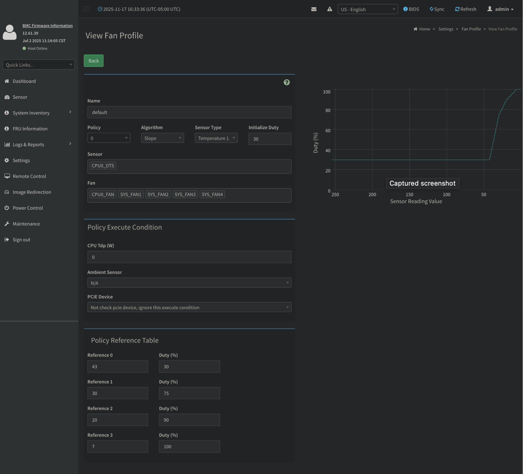

  1. Hello, @ack0049 I actually checked my scripts, and apparently, I don't have it running. But here is what my setup on this mobo looks like. I made some changes to the BMC fan control a while back, and so far it seems to be working. Here's a screenshot of what I have. Here are my fan speeds right now. FAN1 are my two rear fans, and FAN3 are my Noctua NF-A4x20 fans (2). I have blowing on my nvme. I hope this helps.

  14. Thanks for this curious though is there anyway to speed up responses?
