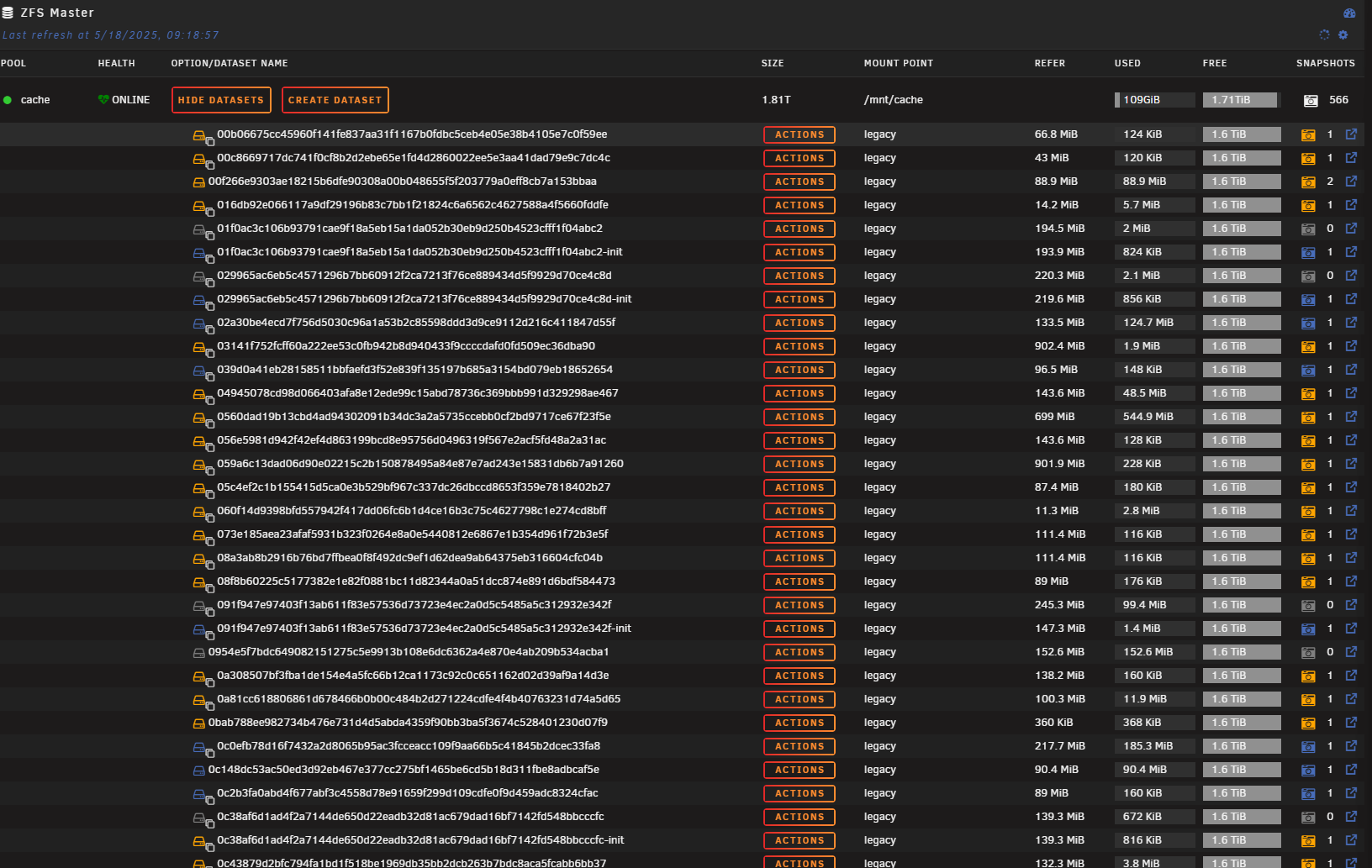

But I did a "zfs list" and then verified with ZFS Master plugin, in my pool I see my normal few folders (which are not datasets AFAIK), BUT also see a few hundreds (!!!) of "legacy" datasets with names like "03747e08c1b7e6ab35ac74dc6c1538c83b1916185c5e4311e5899ec3d6911397"!
They also seem to be... snapshots?
(I never made snapshots myself)
What do I do, how do I clean those?

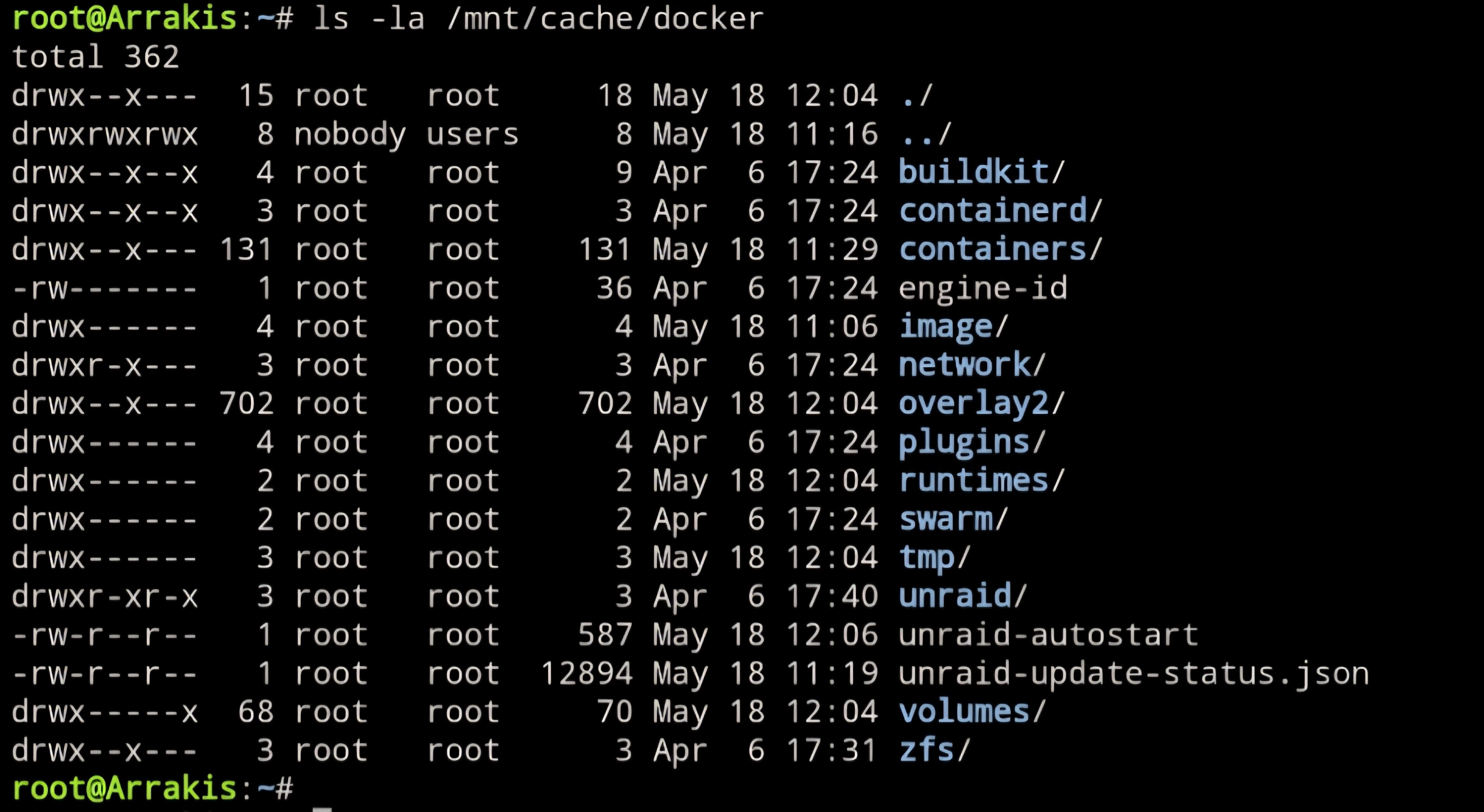

I am having same issue, 566 datasets(!!!) All marked as legacy on my zfs cache drive, how do inget rid of them or fix it?  Just so you are aware, I started my unraid journey with 7.0.1 so this is very fresh system
Looks like all of them were created by the docker, not sure why and how? What is the best approach to remove them and to stop them from being created? Should I just remove all data from this cache and format it as another file system if there is an issue with zfs?

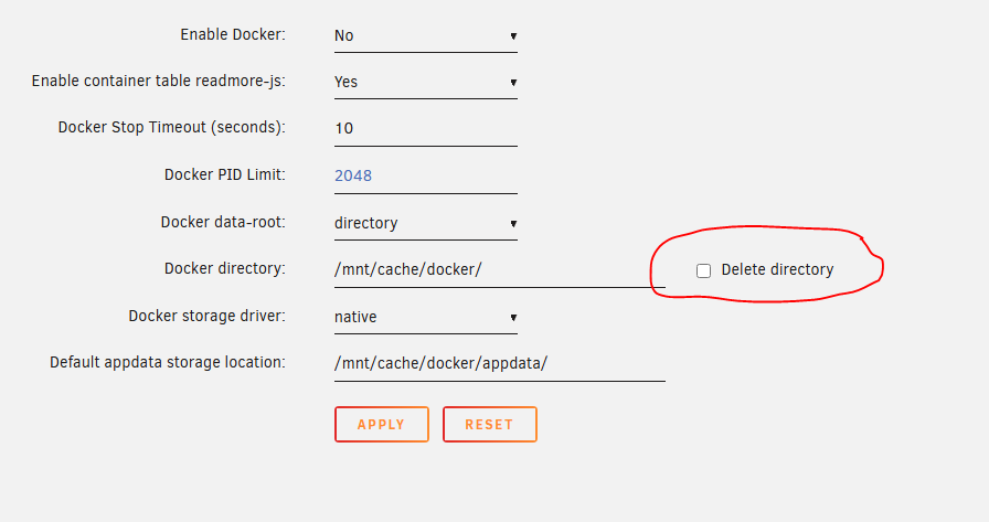

See the link above, but basically, you just stop docker, check the box to delete the folder, then change the driver to oeveraly2 and recreate, finally yo need to restore the containers from previous apps.
Okay got it now, so I guess stuff like /appdata etc won't be affected? I just cannot see  "check the box to delete the folder" where is that thing?
Edited by Joloxx9
Correct:
Didn't have that field, however all dockers vanished etc so should be ok now, recreated all of them. Thanks for help. Myabe because array was offline?
Edited by Joloxx9
Yep, it needs to be online, just stop the docker service.

On 5/19/2025 at 8:57 AM, JorgeB said:
Do you still have the legacy datasets?
I wiped the folder, then manually erased all legacy databases and recreated docker, so far so good, no issues, thank you for your help :)
