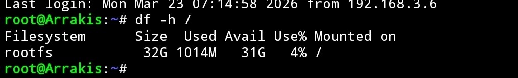

  13. Just noticed that I have out of memory error, are you able to let me know what caused it? arrakis-diagnostics-20260323-0809.zip Was it because of "stress" application or there was something else?

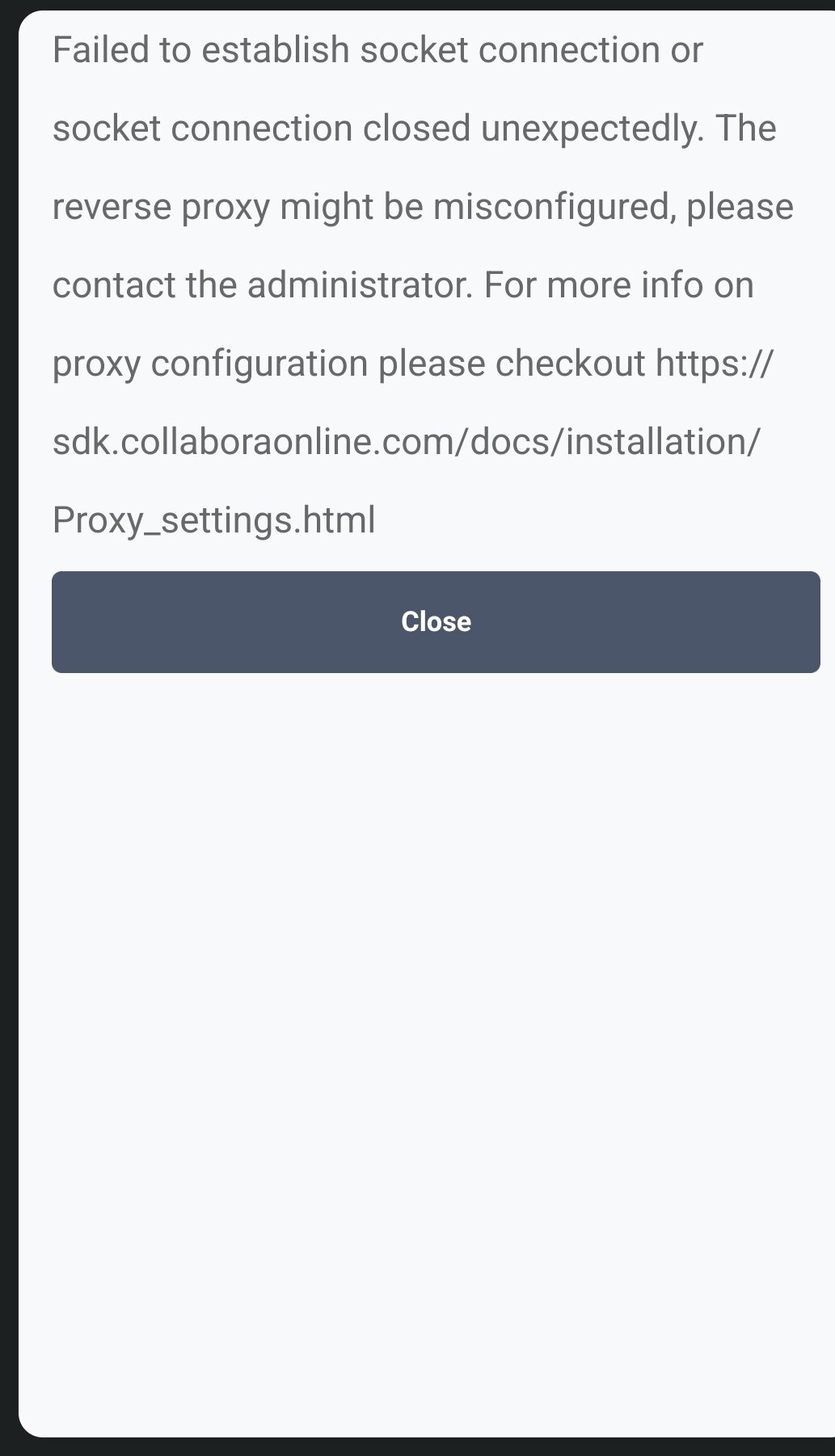

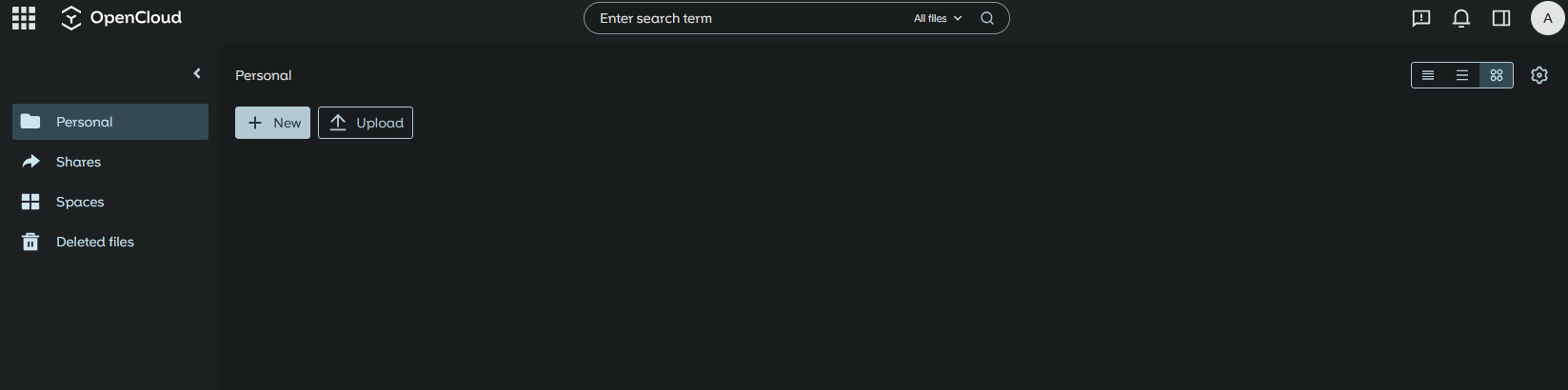

  14. I was looking where connection stops, I had to disable authentication for the tests. But now I stuck on this: It wolduld be nice to know if issue is with wopi or with collabora
  15. Yup, there was something going on between Pangolin OIDC and opencloud, had to do some rules and voila:
