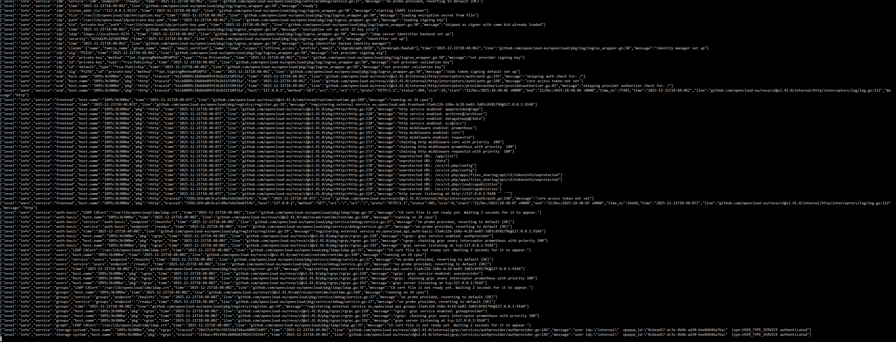

  14. I was looking where connection stops, I had to disable authentication for the tests. But now I stuck on this: It wolduld be nice to know if issue is with wopi or with collabora
  15. Yup, there was something going on between Pangolin OIDC and opencloud, had to do some rules and voila:

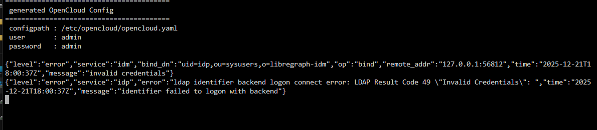

  18. Did fresh install as it was not accepting ANY password, now I am facing this: I literally have no clue what is going with this thing, why is it so hard to set it up?
  19. Well I put admin because mine something like "&R7$Tyklo56" was not working. I will try once again.
  20. it does not accept the login/password combination, no matter what I put as a password :)

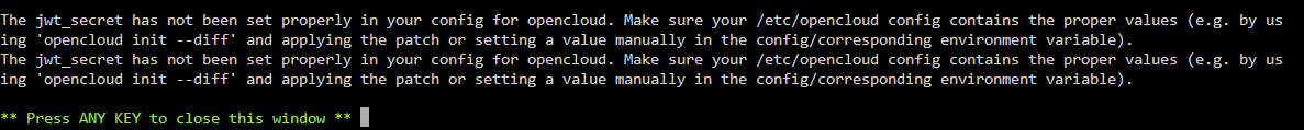

  22. Approach number 2: Did step by step, do I have to run init in this version? If I do this should be in documentation.
