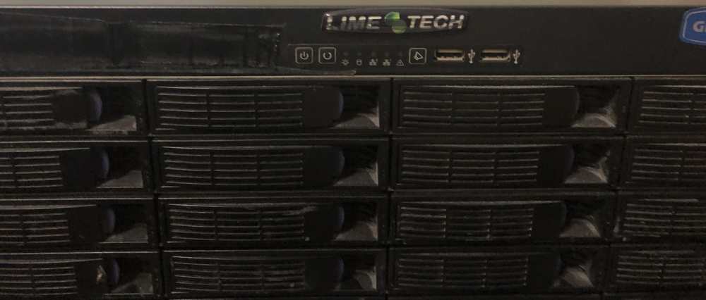

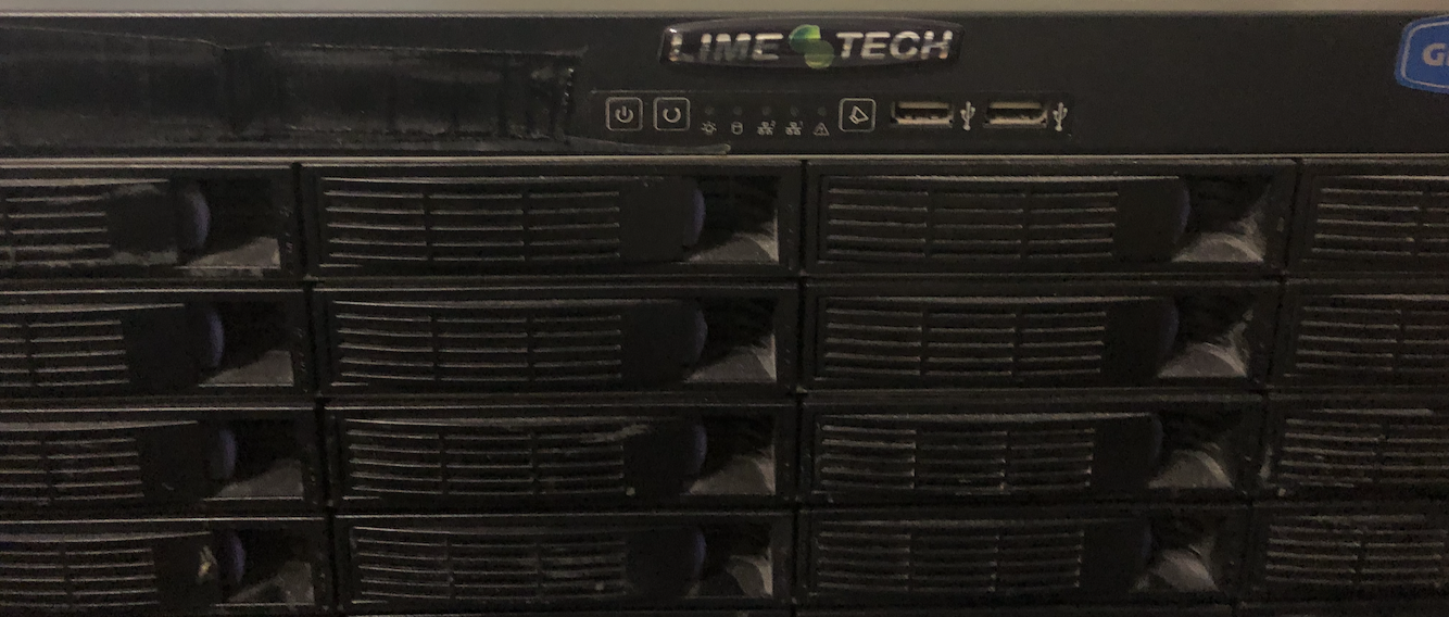

@Frank1940 Thank you so much for your input, and heck yeah I want to learn more. I first got on board with UNRaid when the site was Limetech, and they sent out a USB with a Limetech sticker which I still have on my server since '09. Setting it up back then I wasn't as security conscious and just had my blurays and DVDs I ripped on it to play on Kodi. But now, it's time to retire my Norco, and with that times have changed and I want to do things the right way for '22. I appreciate all any input you are willing to share, as I have tons of questions, and almost feel embarrassed about the questions, being such a long time user. Here's a pic of the Norco and the Limetech sticker;
