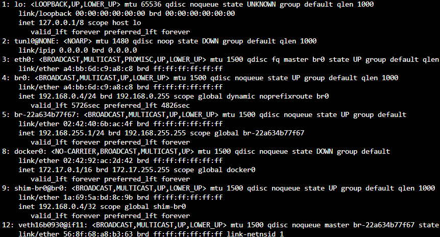

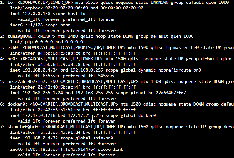

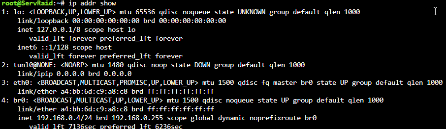

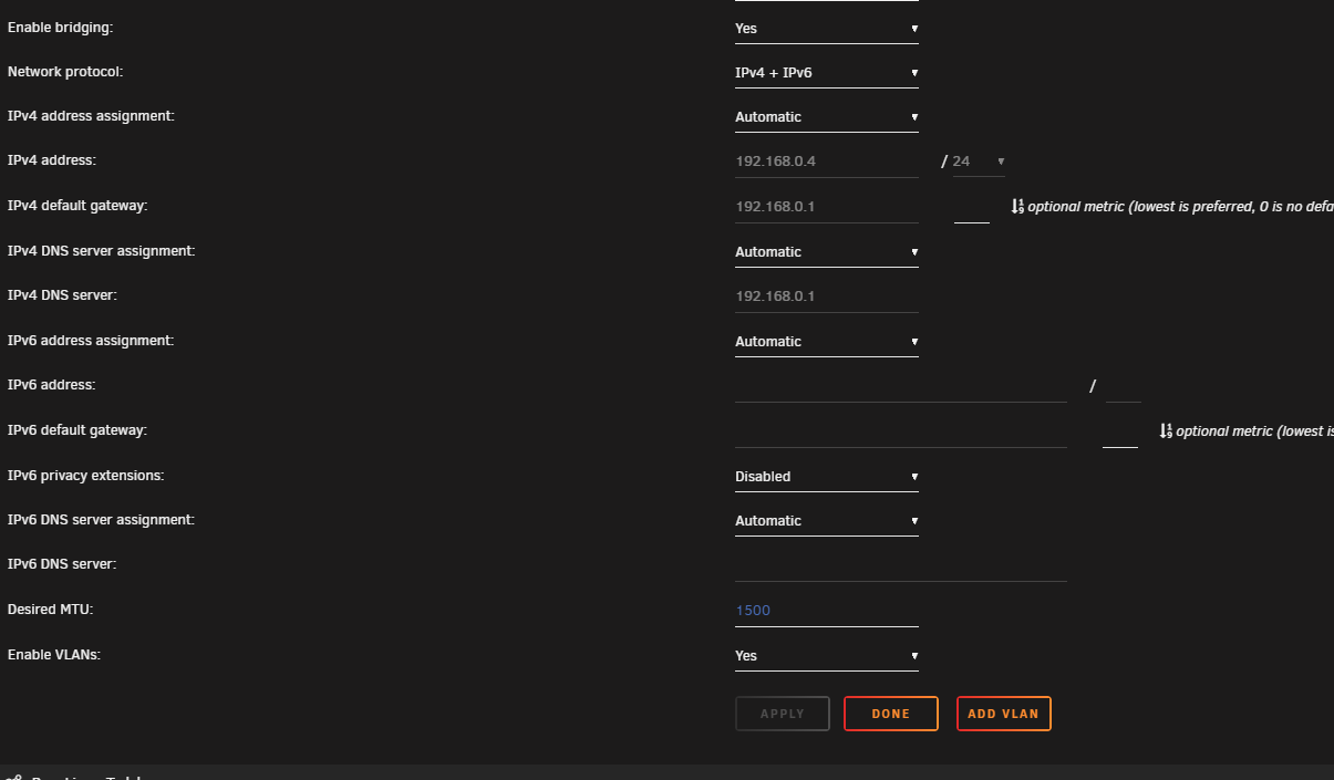

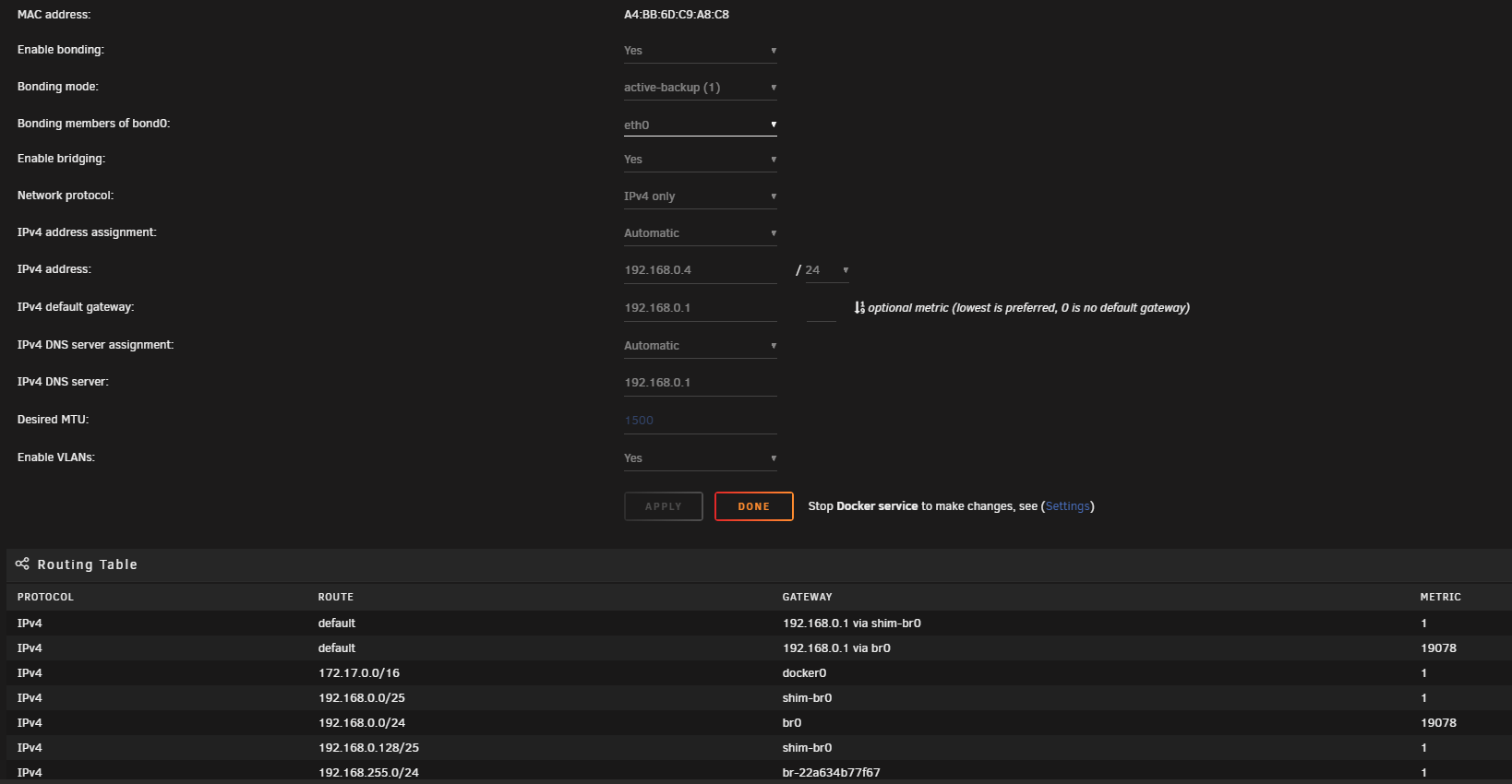

I'm on unraid 6.11.5. I have ipv6 disabled in my network configuration, but when I do ip addr show, I see multiple ipv6 in local-link. Problem is when I want to access samba share \\servername, it return a fe80 addr that I can't access (even when on same switch).
ip addr show (part of it)

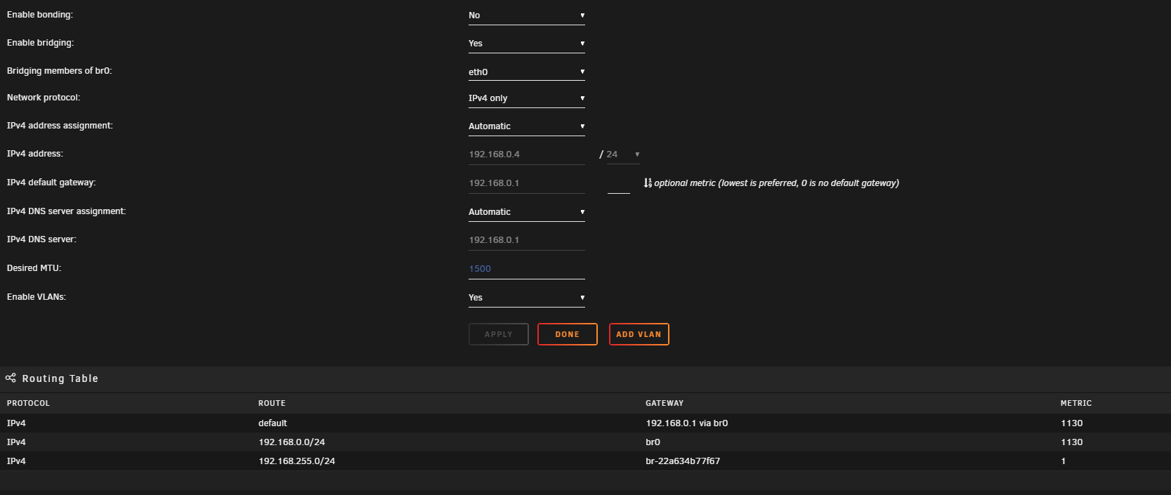

is there a way to not have ipv6? I tried enabling ipv6, the server received and address but I still receive the fe80 addr when I ping (and I can't find where this address is because I don't have any ipv6 dns).
Is there a way to completely disable ipv6?
Thank you

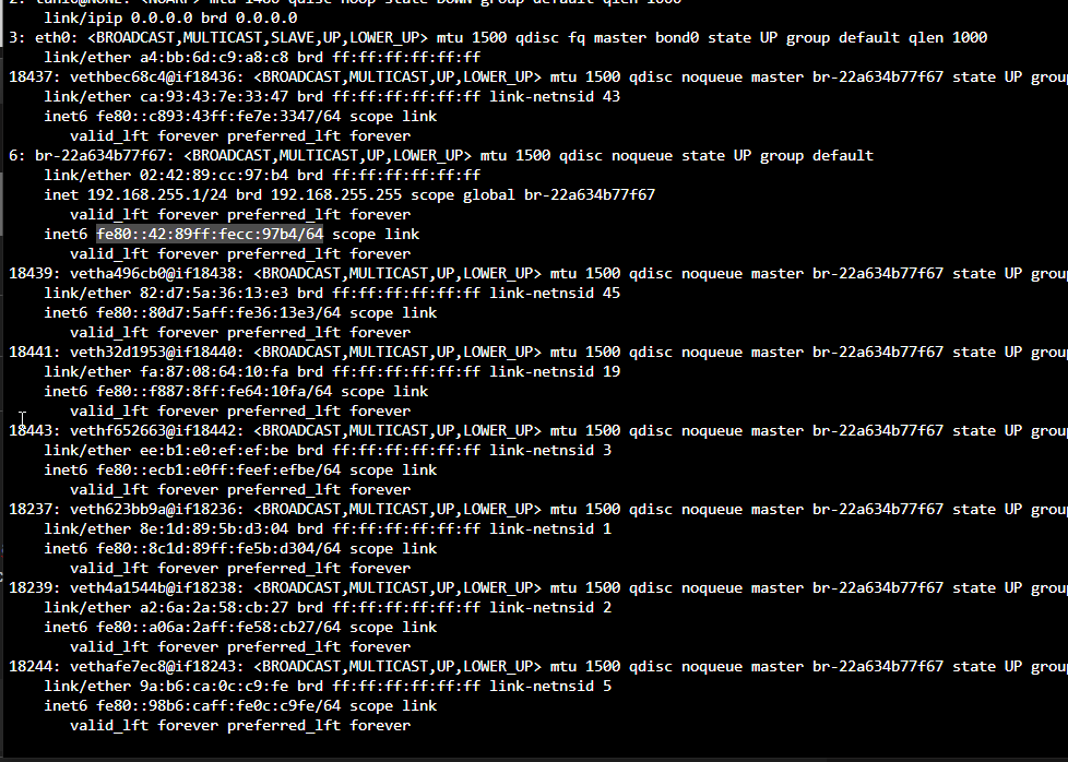

In your picture the IPv6 assignments are to virtual interfaces (veth).
Make sure your docker configuration and docker containers are not configured for ipv6.
As a test disable the docker and vm services and check again.

Your "regular" interface is br0, which is ipv4 only
Try the following:
- Re-enable IPv6 for br0 (docker and vm services must be stopped to do this)
- Go to docker configuration and if any IPv6 assignment is checked, uncheck it
- Reconfigure br0 back to ipv4 only again
- Start docker and vm services

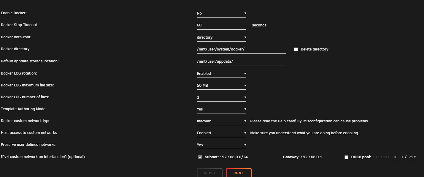

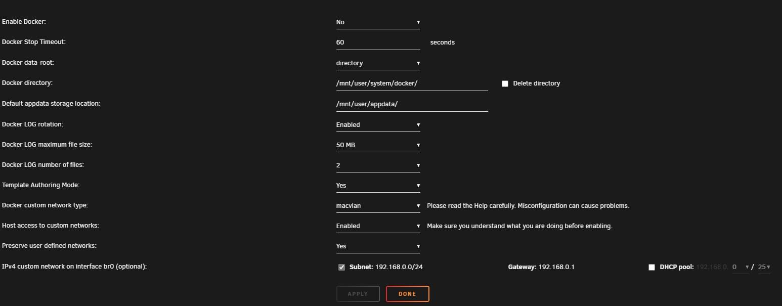

No ipv6 in docker:
and network setting has ipv4 + 6 enabled

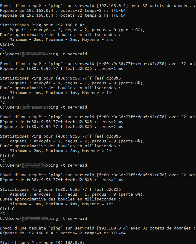

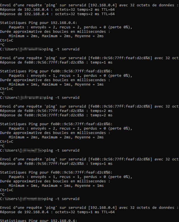

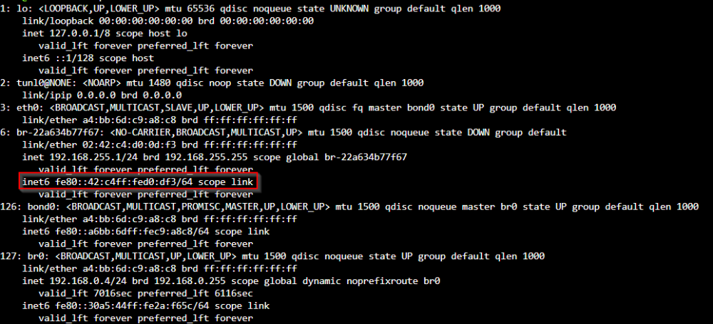

if I try to ping my server, something I get ipv4 other time ipv6 fe80

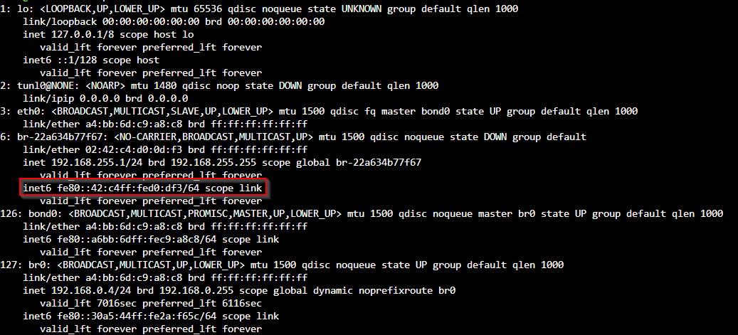

I seems to get ip from br-22a....

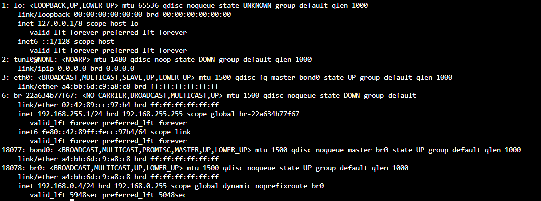

If I turn back ipv4 only (I also disabled bonding cause I don't use it anyway)
still have some int6 ip, docker isn't running nor vm
edit: but when I ping, I always get ipv4 now. So, could it be a specific docker guest that's doing that?
Edited by Nodiaque
br-22a634b77f67 is created by a docker container, you need to find out which container

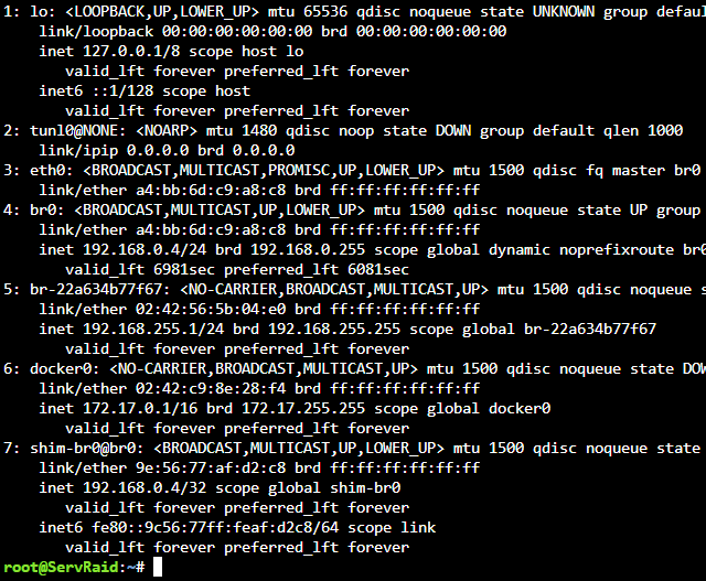

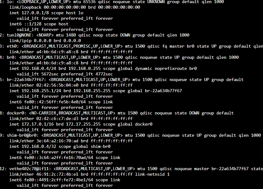

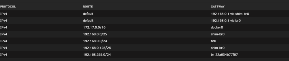

ok, so right after restart, I'm like this with docker daemon down
I start the docker daemon, no docker is running
Here the docker network ls
now ping randomly reply either ipv4 or ipv6, but the ipv6 work
the only one that have ipv6 right now is the shim-br0
Edit: I've ran docker network inspect on all docker network, they all have enableipv6: false
The shim-br0 interface is created because host access to custom network is enabled.
If you don't need host access, you should disable it under Docker settings
I put on my todo list to include shim interfaces as well when not using ipv6. Merci :)
You can manually disable ipv6 for this interface by doing
echo 1 > /proc/sys/net/ipv6/conf/shim-br0/disable_ipv6
Ah, no I need it, specially since my DNS run on docker (and many db and stuff). When I disable that, it crash many stuff.

The 2nd docker is on my-bridge, which is the br-22a.... It added a new entry (#12) with ipv6 and it forced br-22... to get ipv6.

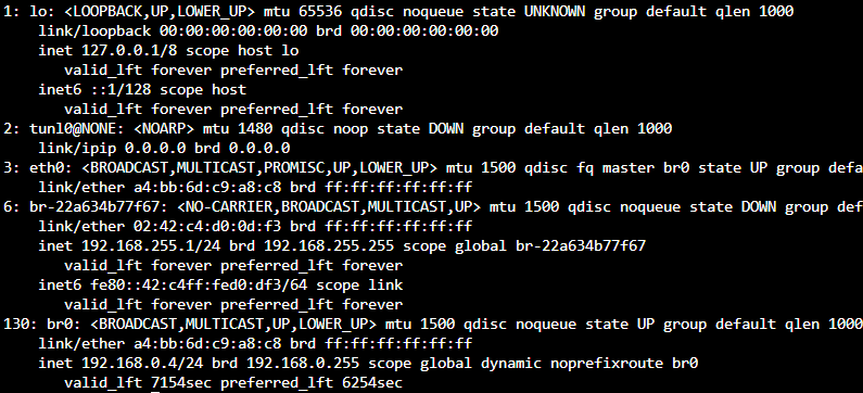

This is after restart and starting docker daemon, but no docker. We can see the custom bridge doesn't have IPv6 yet
hmmm... I turned off docker and decided to go look in the shim place. Shim isn't there but found br-2.... and:
There's also a all folder, can I simply change this one to 1 (because it's also at 0)?

Also, all other interface (including default and all) have 0 in disable_ipv6. Shouldn't they all have 1 since I disabled ipv6?

yeah I understand with 6.12, I'm on 6.11. Might be something different in 6.12? Because as you can see, mine doesn't work. When I start docker and put shim 1, it still has a ipv6
edit: I put it in all and it worked, shim doesn't have ipv6. Now the problem is how I make this permanent accross reboot because even user script won't be fast enough
also, I must test booting these vm and see if it get one
Edited by Nodiaque
It worked when I put all disable_ipv6 = 1. Even loopback doesn't have inet6 anymore and I started the vm that "spawned" the inet6 on the br-2 earlier and nothing
Might be a 6.11.5 bug? Would be good when someone select ipv4 only to really disable it everywhere like in all.
