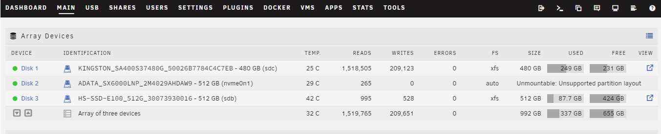

Hello. I have 3 disk in my array. disk 2 have bad file system ( it was xfs).
I can it repair ?

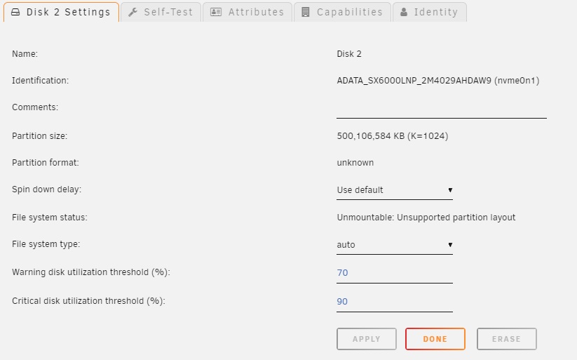

I can only format
30 minutes ago, itimpi said:
I would suggest that you click on the drive and explicitly set the format to be xfs.   This should then allow you to a file system repair via the GUI.
It still Unsupported partition layout

Maby i bad can tell on English.
I have array wothout parity. It just disk1 disk2 disk3. I don't add new disk2. My disk2 lose my file system after  VM on it disk froze(stuck,halt). I wanna back 4 VM

5 minutes ago, Exlife said:
I can only format
If you change the format to explicitly be xfs and then reboot, when you click on the drive you should have the check filesystem option.   This is the way to clear the unmountable status.
9 minutes ago, Exlife said:
I can only format
That means no valid fs is being detected, post output of
blkid
and
fdisk -l /dev/nvme0n1
