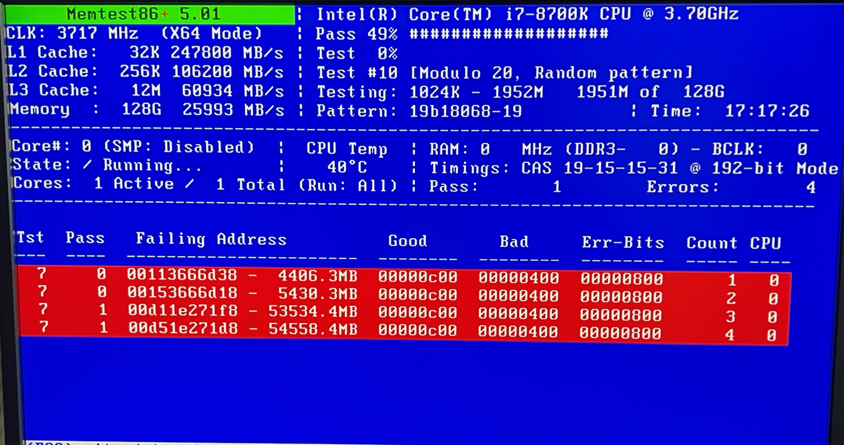

I have provided my diagnostics and also a picture of my Memcheck (yes i didn't let it finish, but since it gave me errors i just gave up after 17h)

So googled a bit about the problem and found that people was having this error when the RAM was failing, and since i have OC my RAM (bc it's 3600MHz) i first tried to make it to normal, 1.2V and 2133MHz, but the errors remains.
And that's when i started the memcheck, that gave me the errors provided in the pic.
So yes, the memory is only 2 weeks old and it can be DOA, but what confuses me is when i run mover, AKA triggering the cache to move to array, i get these errors - is that normal when RAM is failing, or should i also concidering having a broken m.2 drive?
Replace the failing memory. Don't try to use the machine until memtest passes at least 1 full pass, preferably let it run for 24 hours.

4 minutes ago, DjJoakim said:
Do you think all my problems are related to the memory
Highly likely.   Btrfs file systems are very likely to get corruption if you have RAM issues.

So i changed the memory to 2133MHz again, and i am not getting any errors when the server is running, but when i try to run a mover, i get BTRFS errors, does that indicate that some files is corrupt becouse of the broken memory before, or is my memory still bad?
I will run a memcheck again on 2133MHz and leave it for 24h just to be sure...
Simply fixing the ram will not fix existing errors so they need to be fixed.    Only after that has been done do you worry about any new ones.

Oh okey i see, but hold on a minute now... i didn't get the math right.. my array is in XFS format, but my cache is in BTRFS format. Could this mean that the BTRFS errors i get are related to the cache drive?
Well, then i should't get the erorrs when i run memcheck, right?
Feels like i don't have to run a scrub on my whole array, maybe only on the cache, am i right?
Yes.
Bad RAM will corrupt data, btrfs detects corrupt data, so problem is related.
Yes, array may also have data corruption, will likely have, but with xfs there's no way to know, so nothing to do.
Just now, JorgeB said:
Yes.
Alright, then it feels like i got bad RAM (since memcheck gave me errors) and that made corruption on my cache drive, witch now is still there.
I will get new RAM from the retailer, as soon as i get them - i will run a scrub on the cache, and hopefully i don't have alot of data corruption in my array..
Do you prefer XFS or BTRFS system on the array? I have 8 disk with 40TB total.
