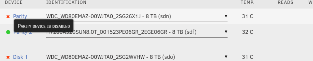

I was unable to access my unRaid via WebUI or SSH so I needed to force a shut down (I know:(, should've tried to plug in a Keyboard/monitor). When it came back up, 2 of the drives were Disabled (1 of my 2 parities and Disk1). A year or so ago (it's a 3 year old rig without any other issues I can think of) I got an UDMA CRC error count on a drive that resolved when I opened the box and pushed in all the connectors. Each of the disabled drives again reads a UDMA CRC error but opening the box and pushing in the connectors didn't magically bring them back this time.

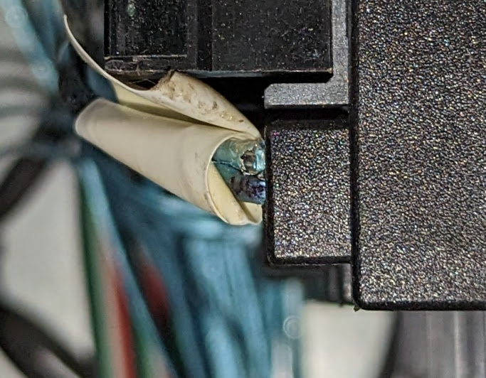

Upon closer inspection it looks like the tension and heat maybe stretched the blue sheathing of the SATA cables and is exposing some metal underneath. I bought all new cables and they come in tomorrow.  Seems like it's probably a good idea to replace the cables in any event, but i'd really like to get a better understanding of the problem to make sure I'm addressing the right one. Is there a way i can confirm this is the issue before doing it? Should I replace these drives while I'm rerunning the cables (I already have replacements)?

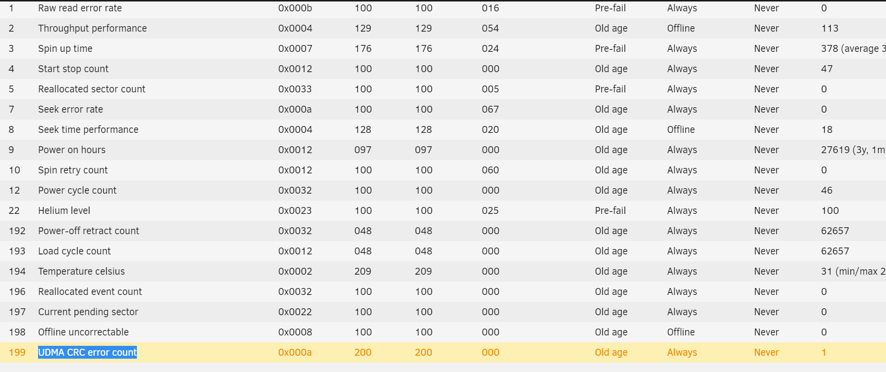

SMART looks fine for both disks, there's a single CRC error and for one of the disks it's an old error, still a good idea to replace cables to rule that out, then and since the emulated disk is mounting, and assuming contents look correct, you can rebuild on top and re-sync parity, both can be done at the same time.

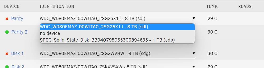

  1. select no disk on both the Parity and Disk1 then
  2. Start the Array
  3. Stop array
  4. Reassign both disks to their previous slots
  5. start array again
  6. finally sleep easy?
I simply can't select "no device" and start the array unless someone smarter than me tells me that's the correct move.

That's it, but check that emulated disk1 is still mounting before rebuilding on top.

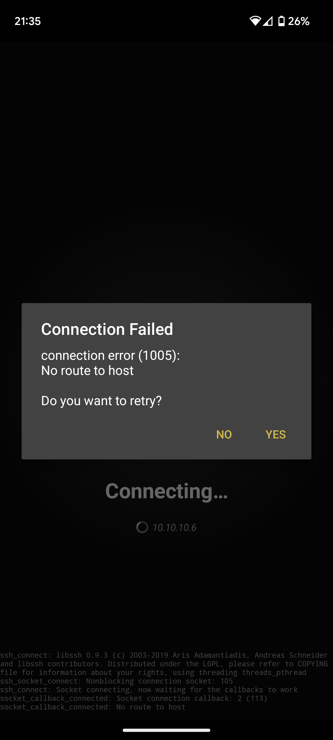

Screenshot_20230518-213519.thumb.png.26cc063b5cf5c27326a28ec3bab93b15.pngSo i thought that during rebuild i would be able to access my files but i noticed that the network shares weren't connected on my pc and plex was still telling me "files not found", so i rebooted my pc and plex server (I did nothing with the unRaid box) and oddly was then unable to access unraid over GUI or ssh (i tried on my android without luck as well). I was looking at the gui several different times today including right before i restarted my pc and it was about 51% of the way through rebuilding after 13+ hours. Do you have a suggestion for how to proceed from here? My current plan is to wait for at least enough time to pass for the array to be rebuilt (i figure tomorrow evening or Saturday) but then what should I do if I'm still unable to access the gui or ssh? hard reset? that's what I did before i had the disabled disks the first time....
I suppose i should plug a monitor into the server. fwiw it appears to be running fine with no error lights or beeping...
